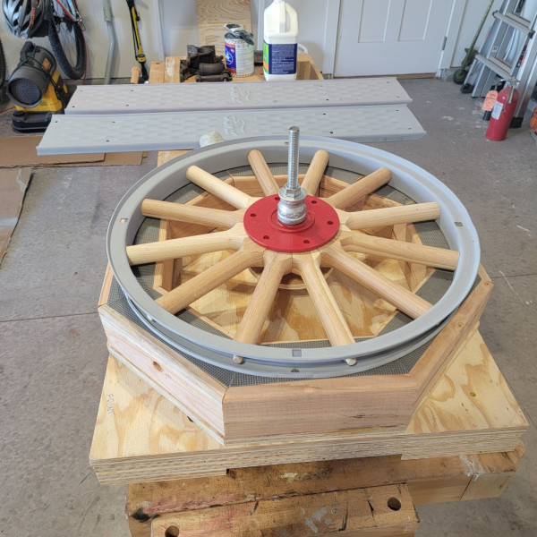

So far this has been the easiest part of this adventure. I tested the press and it worked flawlessly. I've already taken the wheel apart to varnish the spokes and finish painting the rims.

Your photo shows the outer plate positioned with the bolt hols being drilled through the spokes rather than between them. The hub should be set that way and the plate follows suit. Or was the photo just staged for our viewing? Nice work with the rebuild.
- Posts: 7297
Re: Wheel Spoke Length
Correction! That is the hub that is wrongly aligned. My mistake.

That was just a test. No holes drilled yet.
I did not know the holes are supposed to be where the spokes join so thanks for that.

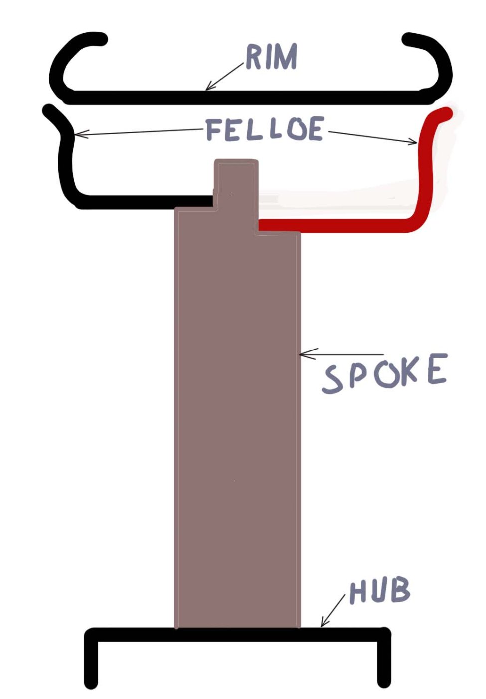

David,
Not all of the felloes are the same.
I don't think you understood Allan about felloe differences. The rims are always the same for the tire size, the hub was always the same diameter but the felloe can vary in it's cross section which makes the spoke length change.
Here is a quick sketch which should explain what Allan was mentioning.
The length of the spoke fron the end against the hub to the face of the inside of the felloe can be longer or shorter depending on the felloe involved.

Seems to me if a spoke on one side of the wheel is one length and on the other side needs to be longer or shorter the rim is out of round.

Scott, the rim is that to which the tyre is fitted. A felloe is the steel piece to which the rim an tyre is mounted. Unless the felloe has been severely bent, a small amount of out-of-round will be corrected when the new spokes are pressed into place.
