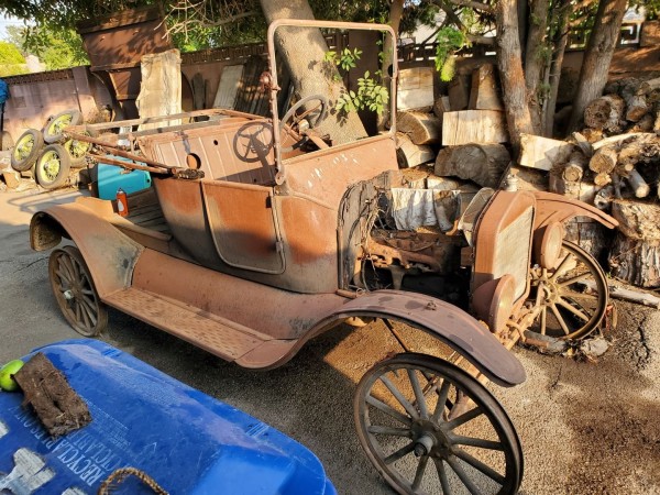

The car interior burned decades ago. It had been in indoor storage. But 3 or 4 years ago a young man bought with the intention of building a street rod. Thankfully he didn't. What he did do is store it outside in the dirt under a walnut tree. Needless to say every square inch of the car was stuffed with walnut shells discarded by rodents.
As you can see in the picture it is missing the hood, cowl lights, and a hubcap. Also needs a headlight lens. I have just located a hood.
The radiator is in the shop getting cleaned.
I am scrubbing and using Evaporust to get the powdery layers of rust off of it. Then I'll rub it out and wax it to arrest any more deterioration. Although I will need all new wiring and electrics I am trying not to have anything looking new on it. I am going to fix whatever needs fixing, re-bush springs and king pins. Whatever needs to be done to be safe.
I am also looking for a rear non-de-mountable wheel as one had dry rot and fell apart.
The coil box paint had been burned off. The coils leaked a small amount of tar. I figured those 98 year old coils were toast. My friend George Hood asked me to bring them over to his place. He tested them and they all had hot fire. He is sure that the engine will run too. I have doubts.
Trying to find someone who makes wood for it is the current task. The folks in Utah say they won't be making any new wood for a few months.
Here is a link to a picture of it.
https://i412.photobucket.com/albums/pp2 ... ljsuc6.jpg

Welcome to the affliction Chris. Looks like a very solid car. Glad you saved it. Any questions you have can be answered by the great people on this forum. Its better to ask 1st on alot of things. Sounds like you have a mentor close. Keep us posted on your progress.

Chris, it may be a little earlier than 21. By then, on our Canadian sourced cars, the square wooden felloe wheels were long gone, as was the crank handle with the cast iron sleeve. Our 1919 models all came with starters ans generators as soon as they were available. The windscreen sidelight mounts may men your roadster is a 'poverty pack' having no starter and generator. Others more familar with US cars may have more info.

Wow Chris, your have a really straight T to begin with! A lot of guys started with a LOT less including me with my 1919 Roadster. It looks to be a mostly complete original. If it had been under that tree for many many years it wouldn’t have looked like it does for sure.
Great find and thanks for saving it from a hot rod or rat rod future. And it even has the top bows still with it. Amazing! I would ask if it has a round or oval gas tank in it. The original tank would be oval but they would get replaced at times with the earlier round tank.

I am a bit confused by your comment that the car needs all new wiring, but you don't want anything that looks new on the car. I would install a new harness. It's a lot less work and cheaper then redoing the car after a fire. The very first thing that I did on my T was to replace the harness. You also mentioned that you are having the radiator cleaned. That's a good idea, but don't be surprised if you still have overheating issues. The joints between the tubes and fins lose their conductivity (of heat) over time. If that is the case, the fix is a new flat-tube radiator. BTW - the car looks great!

If you want to drive your T pretty much like it is it would be a good idea to get new battery cables and all new wiring. Next buy the fun projects coil box kit and rebuild your coil box.
It’s pretty easy rewiring a Model T and rebuilding the coil box and a new set of coils will really help. By the looks of you pic of the car you need a new wood dash. The vendors have those.
Make sure you have a good ground surface for the negative battery cable.
Good luck and have fun.

Gorgeous Runabout Chris! Welcome to the forum! These guys are amazing.
You meet the nicest people on a T!
I agree with Allan, it might be a bit earlier than a '21.
Windshield brackets and front engine mount (front bearing and spring clip) have me wondering. The '18 runabout here was thought to be a '23 (titled as a '20) due to the engine but he's an 18.
You probably know this but in case, perhaps peruse the online encyclopedia at http://mtfca.com/encyclo/index.htm
Much more info is available. A free digital '25 service manual is available for your computer or phone thru very generous Tony C's site.
http://cimorelli.com/mtdl/servicemanual/default.htm No affiliation but think it's great as I'm so dumb-cheap sometimes.
Thanks for showing us and do keep us informed! I'd love to see more progress if you will.
You have doubts whether it'll run? How come. Your first T huh?
Those little buggers are tough and scrappy and will surprise you, they sure do surprise me. If you have some compression in all four, you're set for testing.
Perhaps pull the timing cover and cam gear and check to see if the oil tube is clear.
Guys, do we have to pull the gear to blow out the line? I had to pull the gear on my 18 to re-time the cam so it was off already when I saw a plugged oil line.....
Ya might get lucky with your coil box if it's very dry there but a kit is in order.
The FP kits are wonderful and did a friend's TT coil box just because I could and bought it and installed it for him.
Steve, you didn't post a link to your very cool sight... he has a ton of T info on his dauntless geezer site.
http://www.dauntlessgeezer.com/DG52.html Starting point.

The engine dates from July 1921. This is the bottom of the line car minus starter, generator and battery. My friend calls it the Farmers model as farmers bought the cheap cars.The non demountable rims were cheaper.Allan wrote: ↑Wed Jul 03, 2019 2:18 amChris, it may be a little earlier than 21. By then, on our Canadian sourced cars, the square wooden felloe wheels were long gone, as was the crank handle with the cast iron sleeve. Our 1919 models all came with starters ans generators as soon as they were available. The windscreen sidelight mounts may men your roadster is a 'poverty pack' having no starter and generator. Others more familar with US cars may have more info.

It is oval. I believe that this car has been sitting since before WWII. No proof, its just that things are in pretty good condition. Red inner tubes.John kuehn wrote: ↑Wed Jul 03, 2019 9:42 amI would ask if it has a round or oval gas tank in it. The original tank would be oval but they would get replaced at times with the earlier round tank.

The fire was in the interior. Nothing in the engine compartment burned. The original wiring harness is intact. I have bought a new harness just to be safe.John Codman wrote: ↑Wed Jul 03, 2019 11:21 amI am a bit confused by your comment that the car needs all new wiring, but you don't want anything that looks new on the car. I would install a new harness. It's a lot less work and cheaper then redoing the car after a fire. The very first thing that I did on my T was to replace the harness. You also mentioned that you are having the radiator cleaned. That's a good idea, but don't be surprised if you still have overheating issues. The joints between the tubes and fins lose their conductivity (of heat) over time. If that is the case, the fix is a new flat-tube radiator. BTW - the car looks great!
The radiator is in the shop now. It was full of rust. It is a shop that all the old car guys I know take their stuff to. I asked him not to clean it up or paint it. Sadly the inlet hose connection was rusted out. I ordered a new one from Brassworks and was disappointed that it was cast brass and not steel as the original.
The engine cooling system is now filled with Rust911. I used Rust911 to clean the cooling system on my 1930 Model A and it did a wonderful job. Afterwards the block and head were spotlessly clean and rust free. I'll let it sit for a couple days then drain, flush, and refill with more Rust911. I will probably have to do this a few times to get it spotless.

John kuehn wrote: ↑Wed Jul 03, 2019 1:49 pmIf you want to drive your T pretty much like it is it would be a good idea to get new battery cables and all new wiring. My car has no battery, starter, or generator.
Next buy the fun projects coil box kit and rebuild your coil box. The coil box is in pretty good condition
It’s pretty easy rewiring a Model T and rebuilding the coil box and a new set of coils will really help. By the looks of you pic of the car you need a new wood dash. The vendors have those. Mine has the switch on the coil box. No dash on this model.
Make sure you have a good ground surface for the negative battery cable. No battery, no cable.

It is in a lot better shape than my '15 runabout was when I started work on it!
The "loss leader" or "farmer's specials" (any of a dozen other euphemisms) were actually quite common back in the days. As someone that has looked very closely at thousands of original era photographs of model Ts, I can tell you that the non-demountable wheels option was VERY common, while the non-electric option was less common, they do show up often enough. Apparently, many people were less concerned about having to fix a tire on the side of the road than they were about the neighbors seeing them crank the car to start it!
It is your car, to do how you want it. But very few people today keep or restore Ts back to non-starter, and non-demountable. I would love to know you keep it that way as an example of how many Ts used to be.

I looked at the online encyclopedia and found this. "JUL 19 1921 Acc. 235, Box 38, Ford ArchivesDuey_C wrote: ↑Thu Jul 04, 2019 12:10 amI agree with Allan, it might be a bit earlier than a '21.Windshield brackets and front engine mount (front bearing and spring clip) have me wondering. You probably know this but in case, perhaps peruse the online encyclopedia at http://mtfca.com/encyclo/index.htm

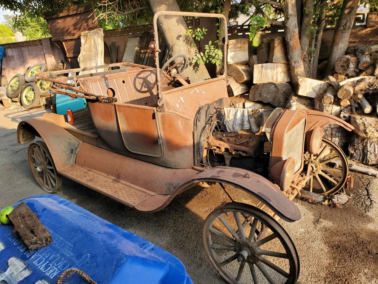

I am simply going to clean this survivor up and make it safe. Nothing will be added or upgraded.wayne sheldon wrote: ↑Thu Jul 04, 2019 1:27 amIt is your car, to do how you want it. But very few people today keep or restore Ts back to non-starter, and non-demountable. I would love to know you keep it that way as an example of how many Ts used to be.
