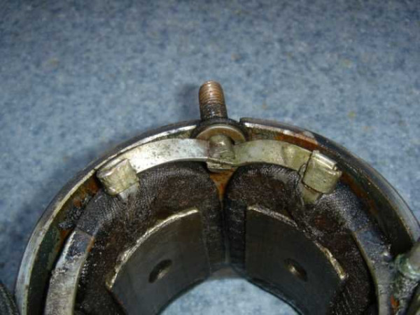

- Posts: 5399
- Last Name: Hatch
- Location: Alabama
Re: Car won’t start with starter
Having remanufactured many starters, I can count on one hand the ones where the terminal stud was not loose to the buss bar.
That is a sore point on the T starter. Check in close.
The new field coils look like a good solution to this issue.
I would check there and be sure the right size cables are use. Dan

From your description of the problem I would check for this:
