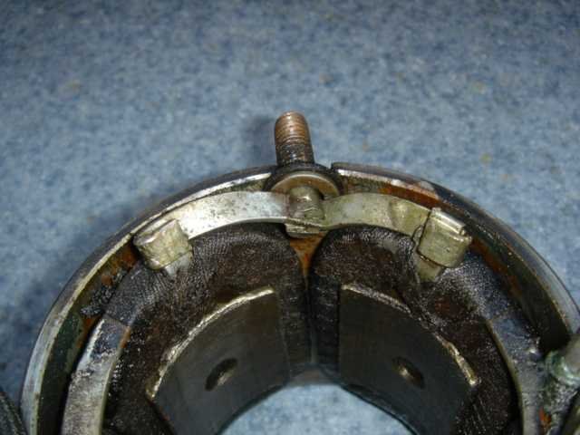

Having remanufactured many starters, I can count on one hand the ones where the terminal stud was not loose to the buss bar.
That is a sore point on the T starter. Check in close.
The new field coils look like a good solution to this issue.
I would check there and be sure the right size cables are use. Dan

Ron Patterson
- Posts: 32
- Joined: Tue Apr 22, 2025 6:11 pm
- First Name: Ronald
- Last Name: Patterson
- * REQUIRED* Type and Year of Model Ts owned: 1915 Runabout
- Location: Petoskey, Michigan
Re: Car won’t start with starter
From your description of the problem I would check for this:
- Posts: 4996
I agree the problem presents like a faulty starter but, OP claims the starter is new. The stud should not be an issue.
