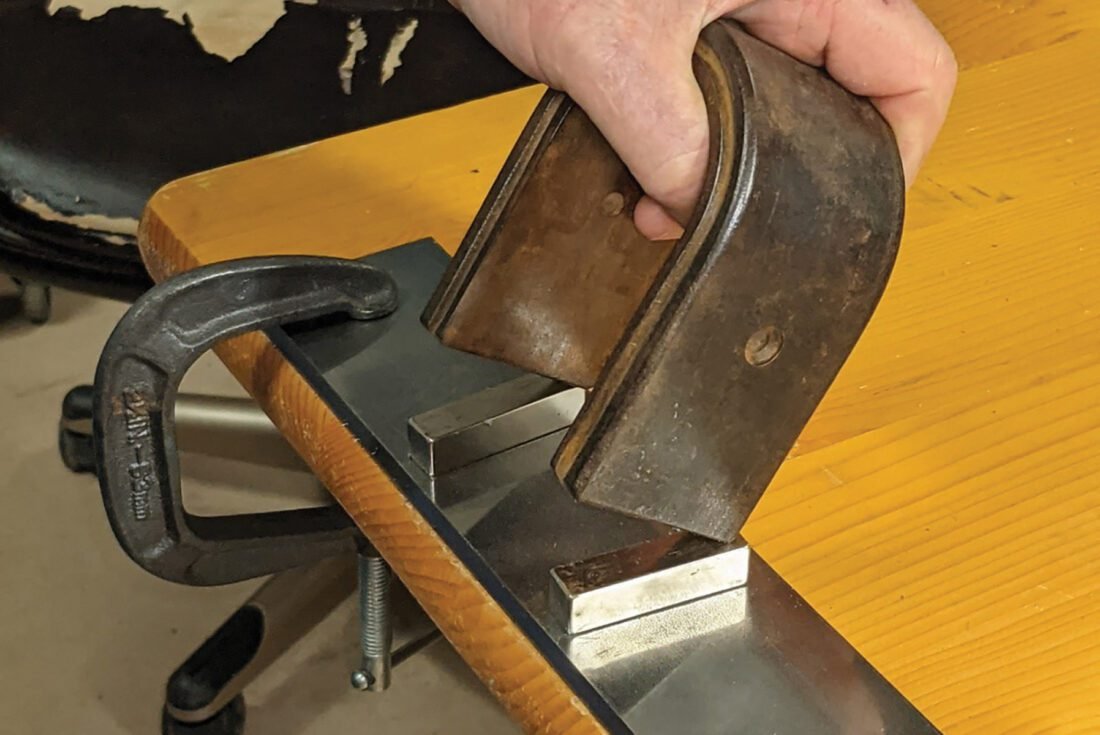

I want to rebuild a 1926 engine and yesterday I was wondering how to recharge the flywheel magnets. Searching the internet for information, I found this article on rare earth magnet technology.
https://www.gasenginemagazine.com/equip ... z22amzram/
Could this work with Model T magnets or has anyone done this before?

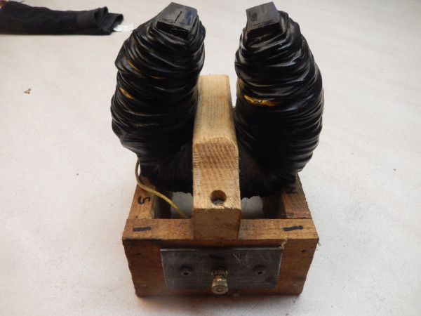

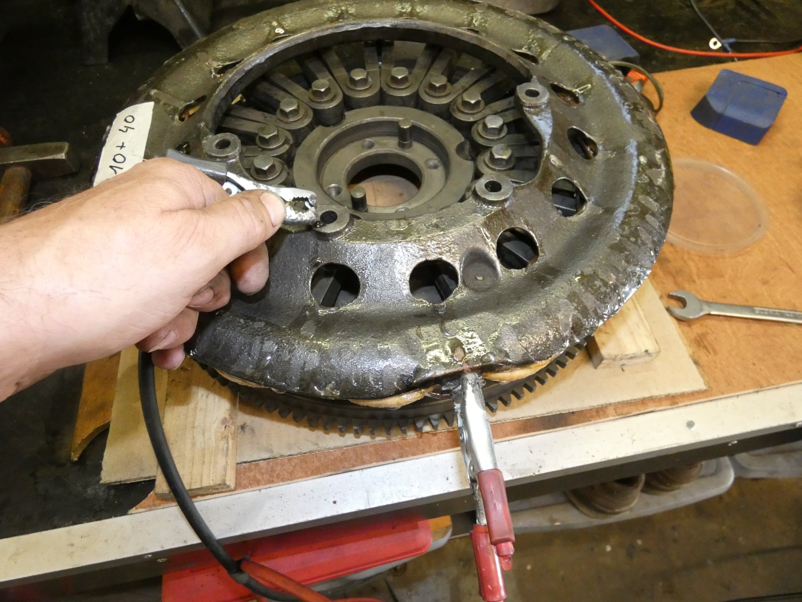

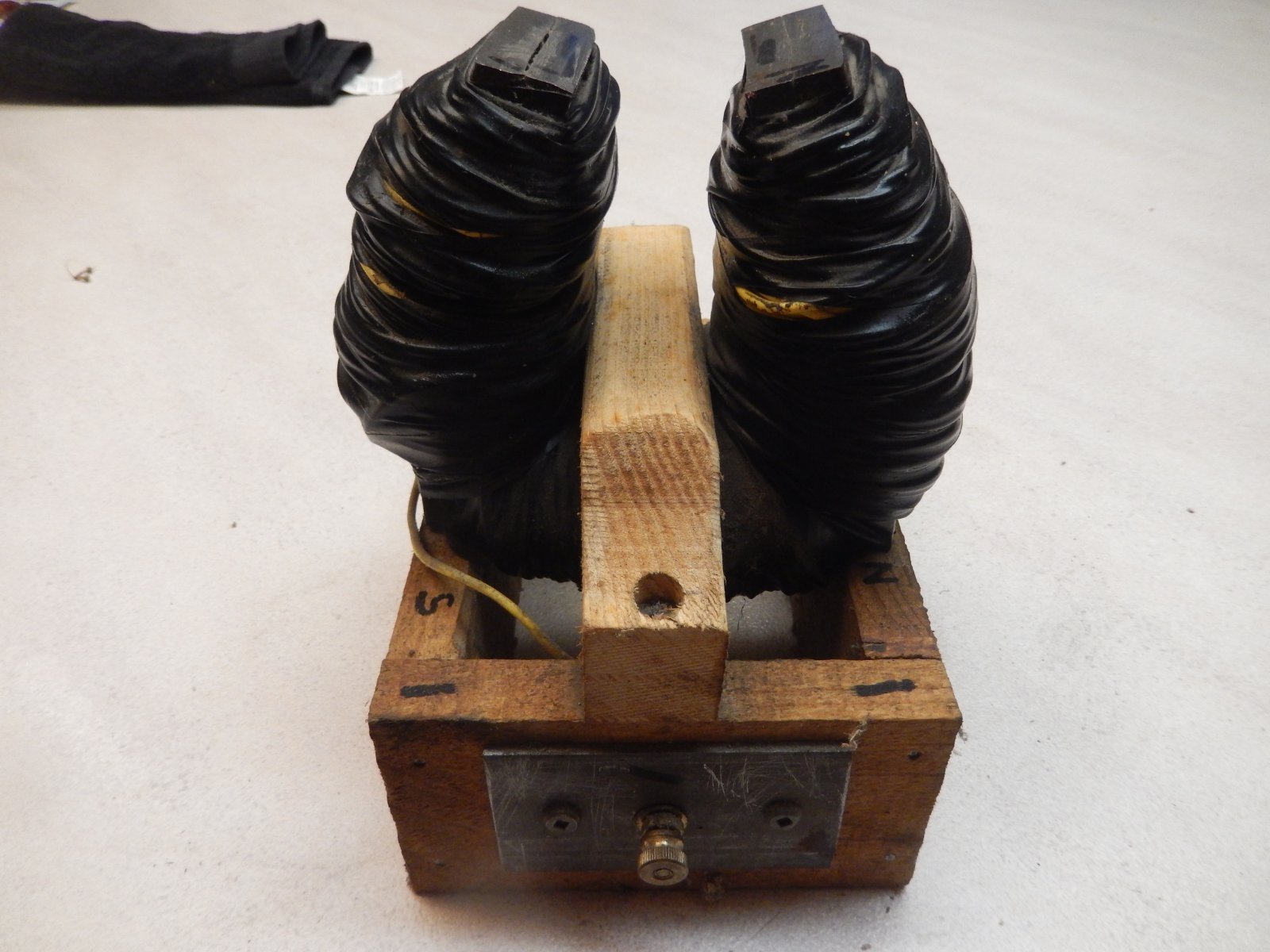

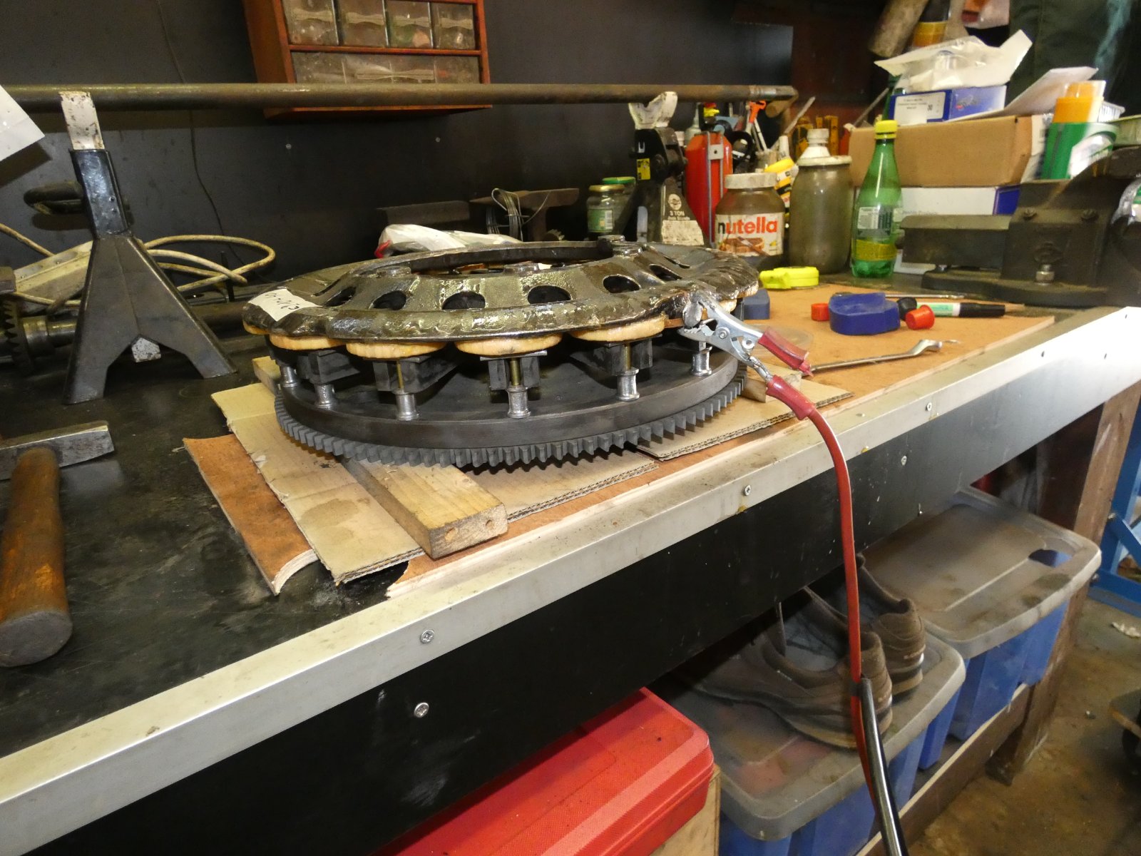

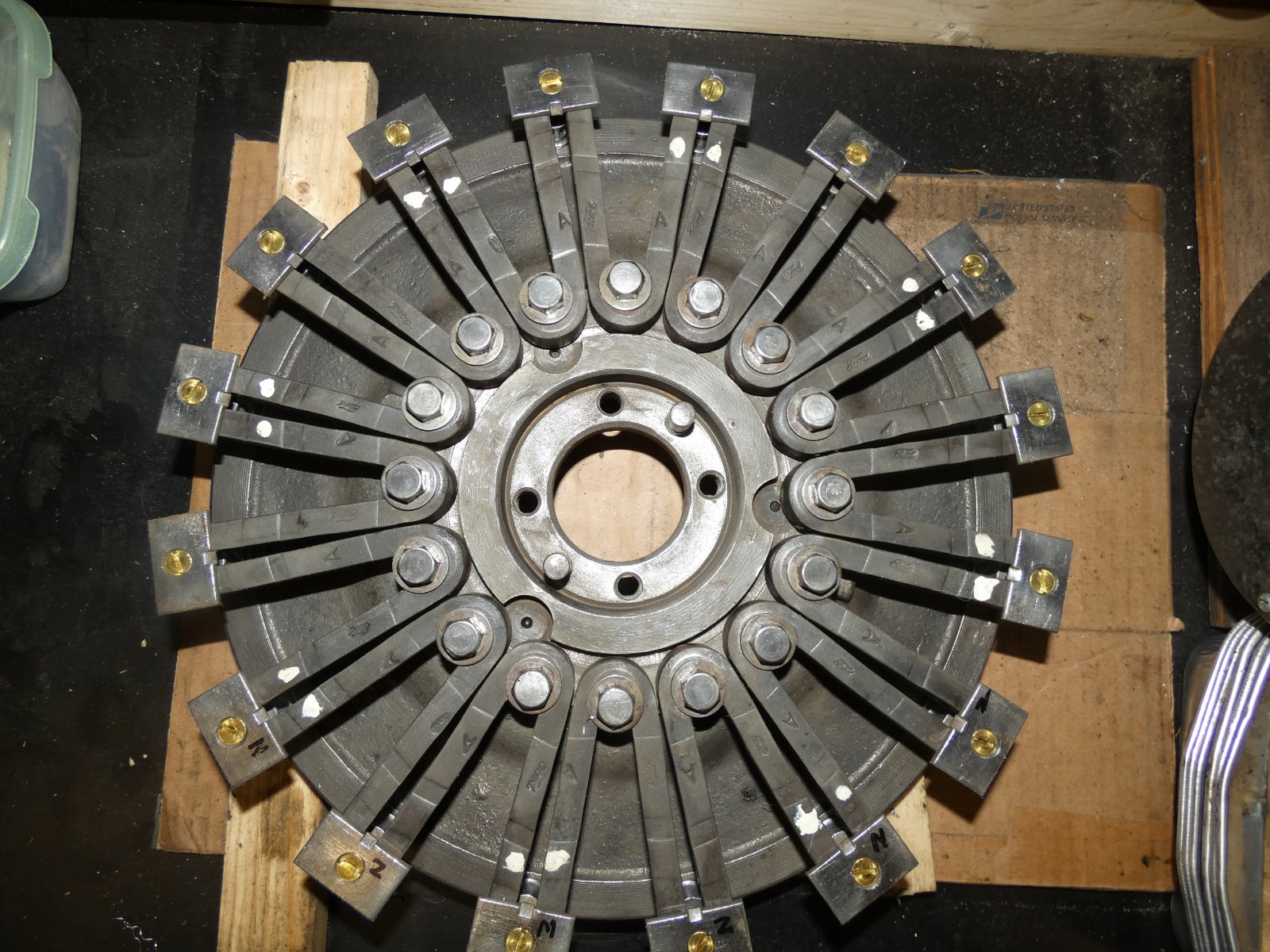

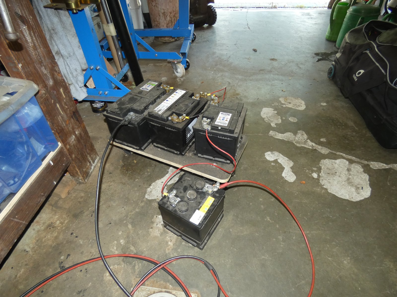

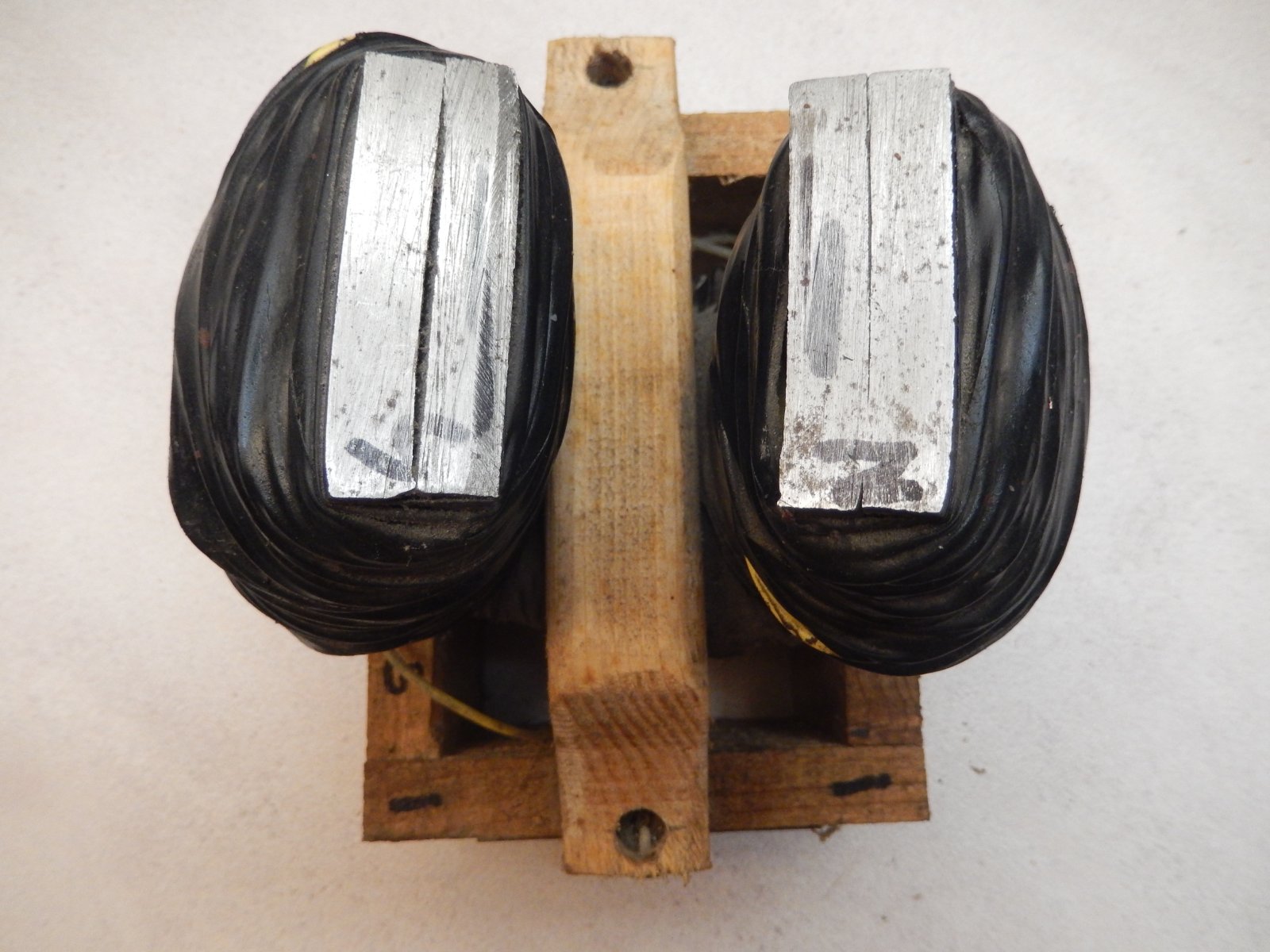

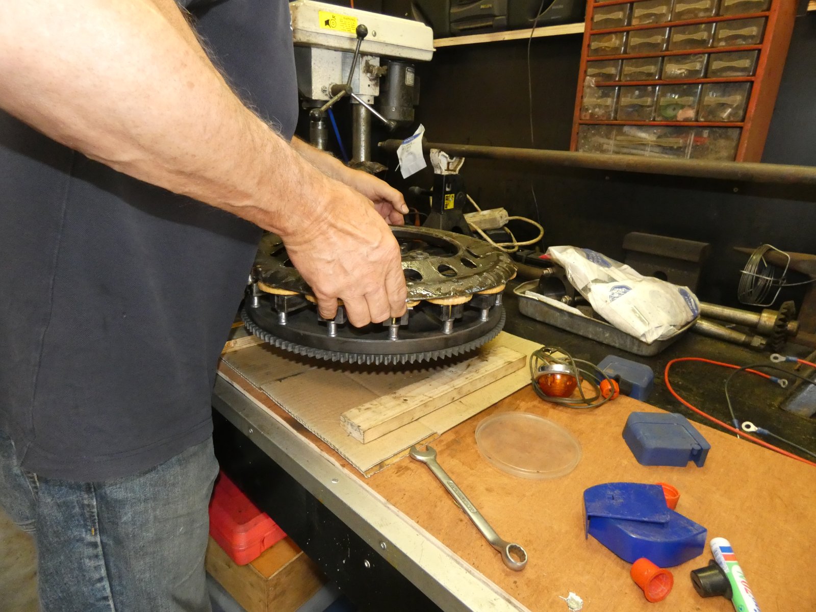

Re: Charging flywheel magnets with rare earth magnet technology?
There are countless ways to recharge Model T magnets, this is my method. I made my own home made set of coils and steel bars and used 3 12 volt batteries. The more coils the better. My first design did not work and this is my second second attempt.
