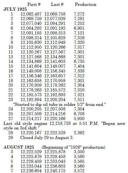

According to Bruce McCalley and the production records that serial number is on the 5th day of 1926 production.
If that is the real serial number then it probably was built with leftover parts, Henry did not worry about "correct" parts.
All 4dr bodies were made by outside suppliers (with many detail differences) and the only change was the cowl changed to match the new 26-27 hood.
During year changeovers a lot of odd ball cars were built.

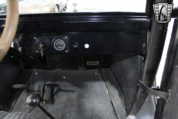

here is the photo of the dash, the dash choke is an earlier style dual choke and mixture set up.DanTreace wrote: ↑Tue Sep 16, 2025 8:59 amThe engine and wide pedal transmission are the Improved version. Obviously was swapped into your ‘25 -24 model year Fordor since your T isn’t Improved model with crowned fenders and sitting on the Improved Car frame.
You may be able to date the body by features, the dash shows the butterfly for choke to carb, by mid ‘25 that setup changed to the single dash combo choke and carb adj. The butterfly was eliminated.

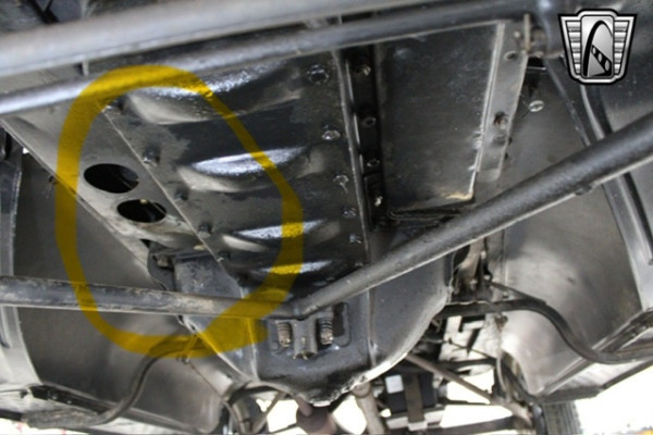

Interesting: Look at the engine pan with two holes under carburetor. These were made for dual use, carb or vaporizer. I have been told “They never made those.”
I had those that came out of Ford dealership in the 50/60’s.
See yellow circle in picture.

I also have one of those two-hole pans that they never made!
The choke knob is round, and under the dash will be a rod with triangle bend end to adj. the carb setting.
Yes, seems to be a '24-'25 body, the patent plate below the dash is the rectangular style, these are used 1919 to March 1925. Sometime in March 1925 the 'clipped' or angle corner patent plate were used to end of production, July 1927
