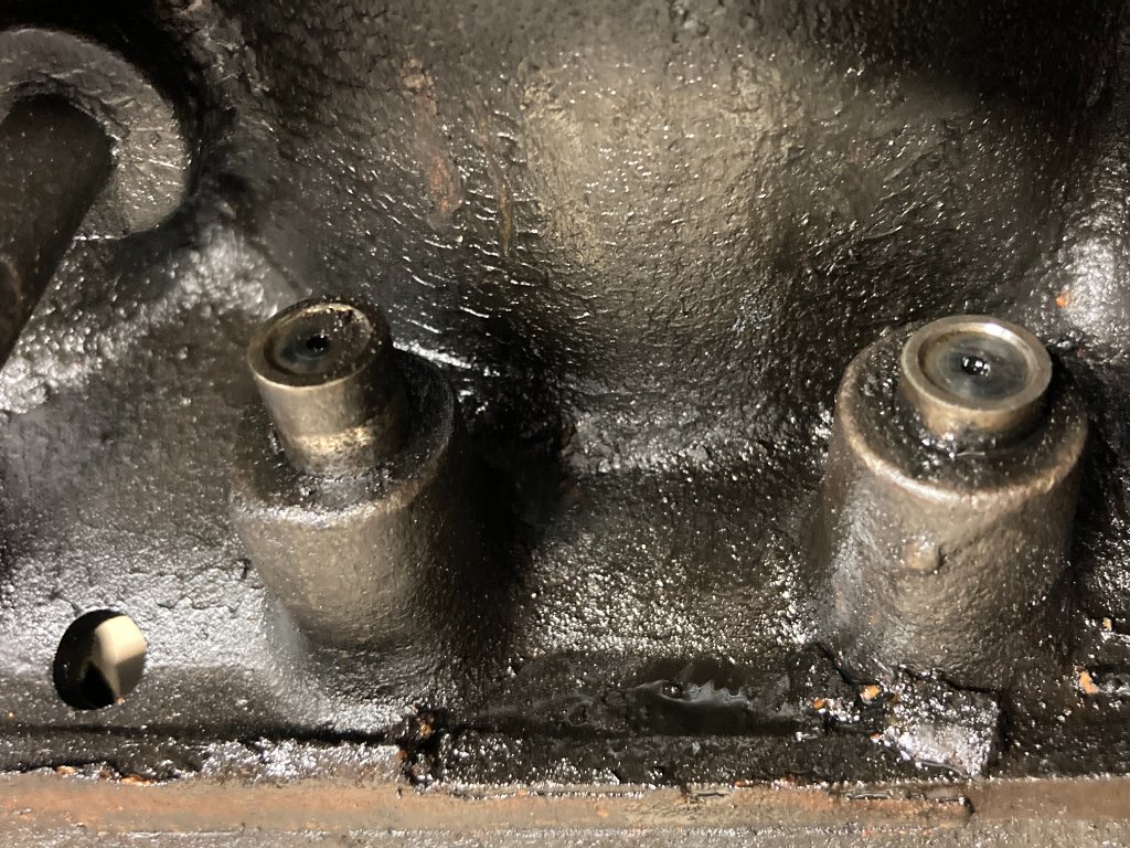

My engine was rebuilt at some point a long time ago. It has .020 over cast iron pistons. The pistons have no markings on them anywhere. My valve lifters have depressions in the tops that the valves sit in. They are all the same, and appear to be made this way. So, my questions are:
How do I measure valve clearance with these lifters?

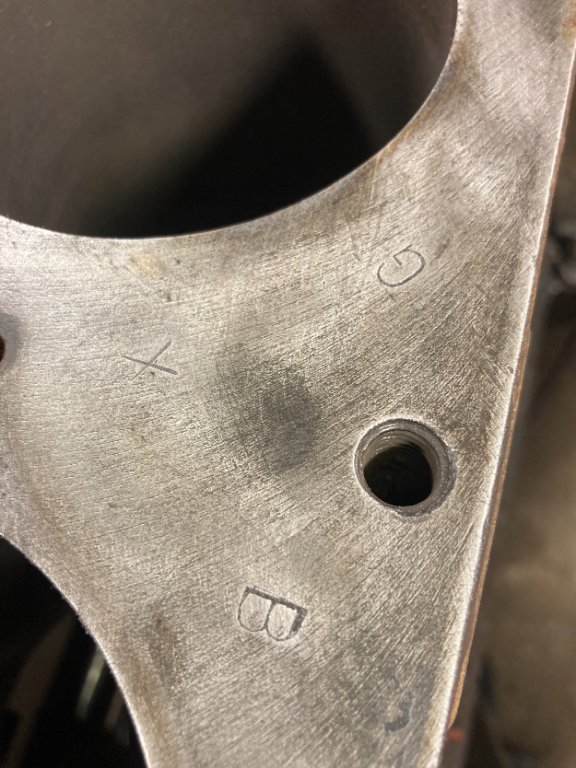

What do these letters stamped in the deck mean?

Lifters usually wear from flat to a cup on the top, making adjustment difficult/hit and miss. Your lifters do look like they were machined that way. I have no idea why. They do not look like standard T issue.

I would bet the lifters were machined flat before. They often wear that way. I dress them flat very carefully with a bench grinder when I rework an engine. Provided of course they have not become too short to reach the valve stems with proper clearance. The other best option is to buy good adjustable lifters. Plenty long and easy to adjust.

Honestly, I would replace those lifters with the adjustable style. My suggestion would be the style that uses the lock nut. From experiences with a friend's T, the "self locking" thread style does not seem to be so self locking over time.
I agree that the ones you have appear to have been made that way. If you still want to use them, I would carefully grind them flat. But again, once you consider the chore of doing that, getting new adjustables may seem the way to go.

I have seen many lifters worn exactly like these. I would sure like to see evidence they were made with the recess and explain the reason they might be made this way.

No lifers were made with the cupped top. That is wear. There were cups made (aftermarket) to cover that. I have found them on engines although not lately. The valve timing is the way Ford recommended for used valve train. Both valves are made to open at a certain time of piston travel. This from the top of block to piston bottom dead center or bdc. This works good if you know block has not been decked. His block looks to not been because of the letter mark is still there.
KRW made a tool to measure this, which is still being reproduced. I use the method for the top dead center or tdc.
Ford method is in the Service Manual. TDC is in Tinkering Tips.
You may want to consider valve seats to raise the valve heads back up.

If you look closely at the third photo, you will see a distinct, sharp transition between the flat on the lifter and the upward chamfer on the side. That chamfer has a clean, straight face. These lifters were made that way. That is not the rounded pattern created by worn valves stems/lifters. I have no idea why they were made like that, other than to maintain an oil reservoir in which the valves operate. Another poster queried the diameter of these lifters. It would be interesting to know just how big they are.
The cup in the lifter looks to be deeper than any valve lash setting needs to be. Perhaps that cup is designed to accept a range of different thickness shims to adjust valve lash.

I agree. The depressions are too perfect to be worn in. I measured the diameter, and they are standard size.

I had lifters like that before and I put the feeler gauge on top of the lifter then added the depth of the depression of the lifter to set the clearance. I can’t remember how I measured the depth or if I guessed, it’s been too long but it seemed to work fine. On my 21 I pulled them out and ground them flat. I would be afraid adjustable lifters would come loose somehow.

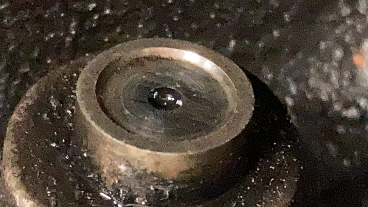

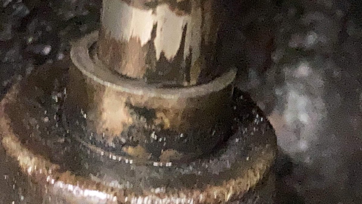

My 1919 Model T engine has the same type of lifters shown in this post. I just put new valves in and 5 of the stems sit on the lifters, inside the ridge around the edge of the lifters. Those 5 valves do not sit in the valve seats. I can slide a narrow strip of paper all round the valve.
As pictured in the post below, there is a small hole in the middle of the lifters. It appears to me that the middle part, that is slightly lower than the ridge that goes around the outside, has been inserted that way. It seems to be a different material as it is very shiny. I can look through the little hole and see empty space below it. My questions are: those valve lifters adjustable somehow? Are there layers of these apparent inserts? If yes is there some way to remove one or more of the inserts so the valves sits lower? Can what appears to me to be inserts just pushed down with a punch achieve the necessary clearance? If the answers to my questions is no, I’ll take the valves to a machine shop and have 1.5/64ths (0.024”) ground off and the edges bevelled a bit. I do not want to take the camshaft out and replace the lifters.

Post by Jerry VanOoteghem » Mon Sep 22, 2025 10:49 am
If you don't use adjustable lifters, you have to set the valve clearance by grinding some length off of the valve stem, (and not by just holding the stem in your hand and using a bench grinder) . You can't just drop in new valves and expect the correct clearance. Having the cupped lifters, as you do, makes the tedious job off setting valve clearance even more so. (And, better not get the valve stem too short... :? )
The advice to use adjustable lifters is spot-on. I do not recommend the "self-locking" style. Get the ones with lock nuts. Some call them the "three wrench" style.

I agree the “cupping” in those tappets looks as if it was intentionally machined into the parts. Why ? Baffles logic.
As for setting valve lash by measuring piston travel and grinding valve stems, it may be the better way if the camshaft is appreciably worn. It’s not that difficult.
What’s difficult is measuring valve lash (hot, of course) with “3-wrench” tappets . . . While the engine is idling. :shock: :shock:
