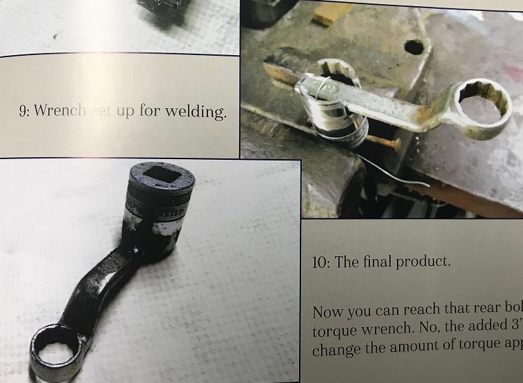

Another excellent edition of Vintage Ford arrived yesterday. On pages 40-41 the author describes how to make a three-inch-long extension for torquing head bolts near the firewall. He concludes the article by saying "No, the added 3" does not change the amount of torque applied." No explanation is given, but it seems to me this extension could effectively add up to 3" to the length of the handle, making the applied torque greater than the indicated torque setting on the tool. Any comments, clarifications? What am I missing in my analysis? Thanks, jb

You are correct, James. The % increase depends on the torque wrenches handle length and design.

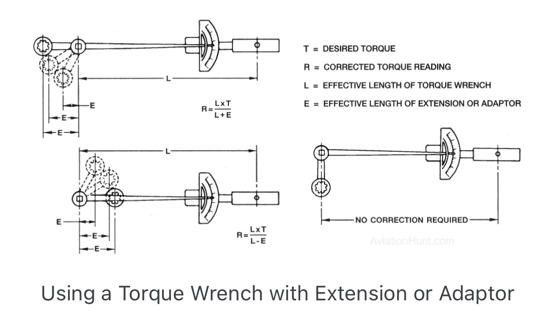

I agree, adding an extension will increase the amount of torque applied to the bolt for a given push force on the wrench handle. See the link below.

If it is simply a regular extension that lets the wrench sit high but doesn't effect length there is no effect on the torque force.
I'm thinking if the extension is at a 90 degree offset type, the effect on the torque value would be based on the hypotnuse of the triangle formed by the wrench and extension. For grins, I plugged in 3" as the extension and 22" for the wrench lenght into a Hypotnuse calculator. The hypotnuse or effective lenght of the wrench is then 22.2". OK, not quite negligable but is it great enought to matter when torqueing something on a Model T?

Typing at the same time as Mark. The angle of the extension to the wrench is obviuosly critical.

It will have an effect on the final torque value. However, if you place the extension 90 degrees to the head of the torque wrench it will not influence the final toque value.
This picture explains in better detail.

As explained above, if the extension is at 90 deg to the torque wrench, the wrench should be within normal accuracy. This is a expected thing when using crows foot wrench or adapter.
As copied from the interwebs "A crowfoot (or crows foot) torque wrench is a specialized attachment for a standard torque wrench or ratchet that allows you to apply torque to fasteners in tight, inaccessible areas where a regular socket won't fit. It features a head similar to a box wrench that fits over a nut or bolt and a square drive that connects to your torque wrench or ratchet. For accurate results, the crowfoot must be kept at a 90-degree angle to the torque wrench to maintain the correct lever arm length and avoid over-tightening."
So used correctly, the extension described will work as expected and measure the bolt torque accurately. This is common knowledge for those that have used them before (the old guy that showed me how to use one many years ago did explain this), the article probably should have included that information.

Both the Norbar formula and Mr. Redding are correct - how can that be? Look at the Norbar drawing and you will will see that it applies when extending the lever arm. Mr. Redding's tool does not do that, and he is correct in that his method will produce correct torque readings.
