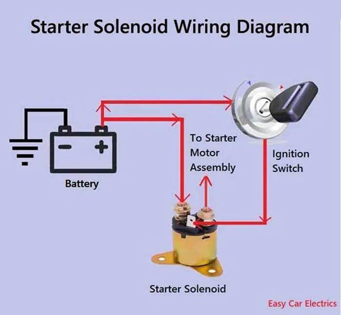

Remote shutoff switch and solenoid. Shutoff switch from Lang's. 6v
1948 ford pickup starter relay.

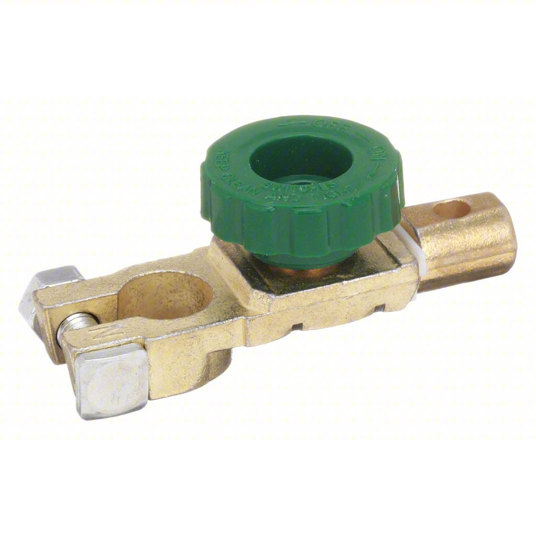

NOTE TO ALL: DO NOT BUY OR USE THE BATTERY POST TYPE SWITCHES. I have extensive experience with both types. They both break or corrode and become useless quickly. NOT WORTH THE MONEY.

My '27 Runabout came with a battery post cutoff switch, that was probably installed in the '90s. I've had the car 5 years and the switch is still perfectly functional and is not broken or corroded. Getting to the knob through the battery access panel at the front of the trunk is fairly inconvenient, but there is nothing inherently bad in the design or construction of the switch itself. Your milage may vary.mtntee20 wrote: ↑Fri Oct 03, 2025 3:36 pmJohn, I can vouch for the Harbor Freight switches. I've used mine on 6volt systems for a couple of years now and have had NO problems with either one.
I am unable to find an amperage spec. on the Harbor Freight unit, but similar units are rated at 300 amps.

use this and hope it doesn't back off or vibrate loose while engine is running.... no ground makes your generator produce "The magic smoke...." use the one i posted from LANG'S and put it within reach of the driver, so you can shut power down quickly and safely without having to pull over, get out, and access the battery....

This depicts what I use. But I use the switch to cut all power to the battery. The battery remains grounded whether switch on or off.

I have seen failures with the "green" disconnect switch.
