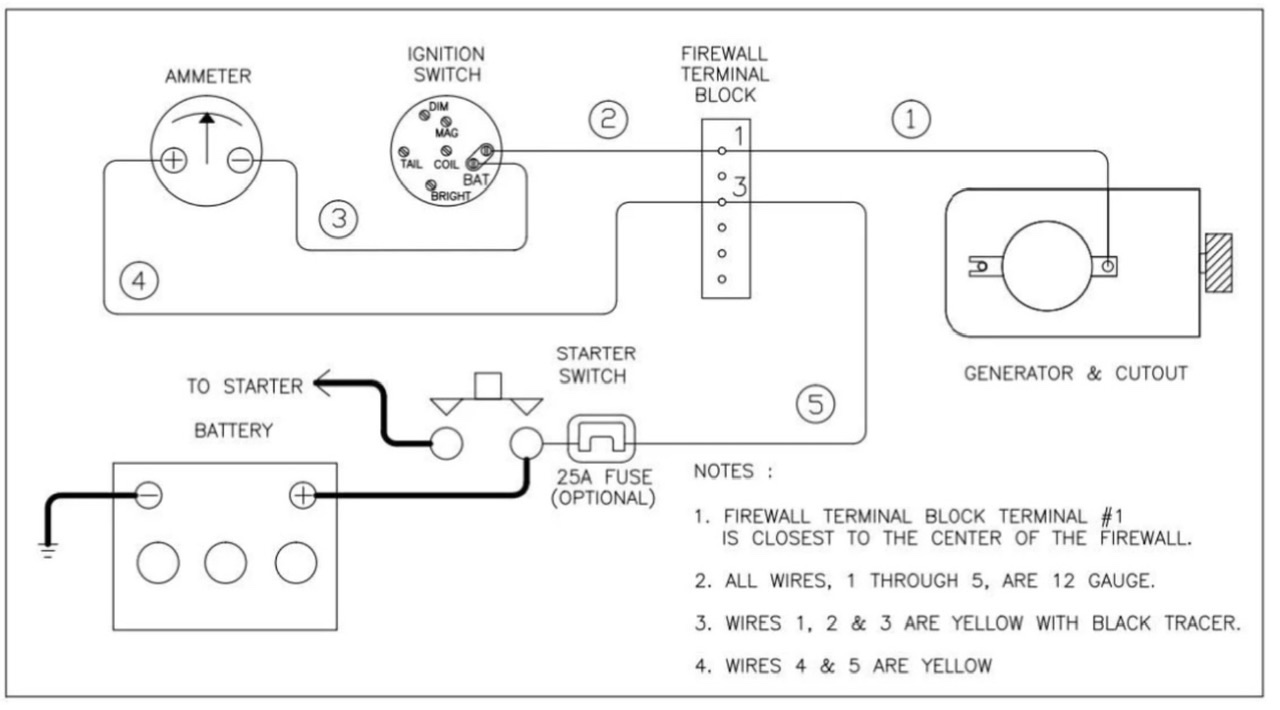

The 23 coupe I recently acquired had a cut off switch under the driver's seat that had failed from a load when the plastic base melted, it is also going to be a pain having to lift the seat or reach into the trunk to get to it to operate it .
I have a good quality switch to replace it but was thinking about putting it behind the left splash apron on a bracket attached to the frame. I may have to get on a knee to reach under to get to it, but it would be high enough to be in a fairly dry area.
Any comments appreciated.
I am also putting a 6 volt starter solenoid on it using the foot switch to trip it. Reworking some battery cables as the starter does not turn the engine over very fast. I put a woven strap from the frame to the hogshead and no change.
One question I have on cables and draw. The cable from the battery to the solenoid appears to be a 1-0 size. The cable from the switch to the starter is just over 2 feet long and smaller than 1-0 in size.. could my starter problem be located there. The ground cables are 1-0 in size.

The original 6v Ford starting system works great when everything is in specs. My advice is to yank out all that new stuff and return to original...no cut off switch, no solenoid, no local auto parts battery cables. If your 100 year old starter still turns slow like a tractor with a dead battery your starter needs a rebuild, if your starter has never been rebuilt it needs a rebuild, if your starter was repaired by a previous owner it needs a rebuild, and by rebuild I mean buy one from a reputable model T starter/generator rebuilder.

For 6v starting, the battery to switch and switch to starter cables must be 0 gauge or known too as 1/O gauge , they are appx 1/2 inch thick. Don’t use premade 12 volt cables you will have problems starting. The ground cable preferably should be a woven strap.
Have tested or new battery, have all cable contact points cleaned to bare metal, esp. all grounds.
Remove the cut-off, it’s just a trouble maker. A solenoid is optional, mounted satisfactorily , (use O cables ) and frame mount the solenoid for it to be grounded.

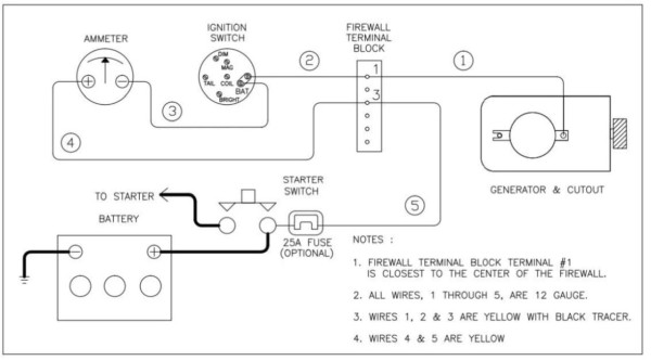

For best safety, add a fuse to the yellow wire from the switch 6v hot terminal, mounted in line near the switch, but mounted in line near the terminal block is easy access, for disconnecting 6v hot to the chassis when working on dash, lamps, or other 6v items on the T. The fuse will save the T from rare but can happen shorts to the wiring, which will smoke wires and start fires.

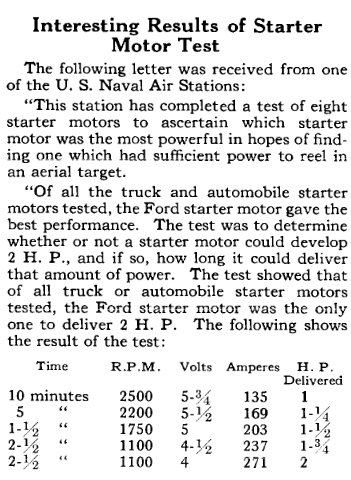

Starter draw should be 200 amps or less. Electric starters typically have a duty cycle of 10 to 15 seconds. Don't grind the starter for more than 10 seconds. Less is better. If the engine won't start in under 10 seconds of cranking, stop cranking and find out why. The starter should rest for a minute or two between consecutive starting attempts. A well charged battery of adequate size is essential to good starter performance and long starter life.
- Posts: 8663
Re: Location for a cutoff switch and starter draw
Not clear what the test consisted of.

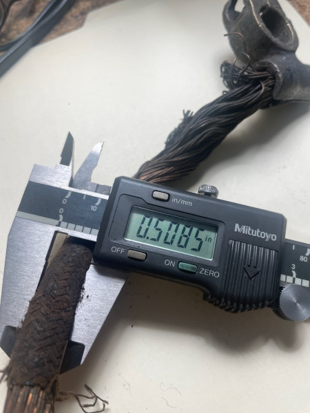

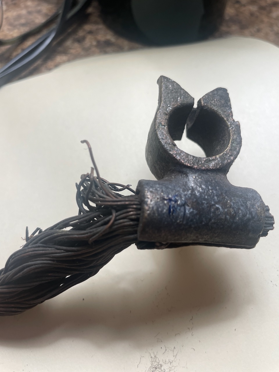

I checked an old Ford battery negative ground cable, Part # 5049B, Factory No. T-1890B that I pulled off a '23 chassis. This cable was used from 1919 to 1923, then Ford went to a ground solid flat strap (woven can be used too)..... This cable is 9 15/16" long, and I measure the OD as .500". The inside wires ID measure .0419".
For ref, modern 1/0 is called to as .035"-.038" ID, and OD of 0.500"

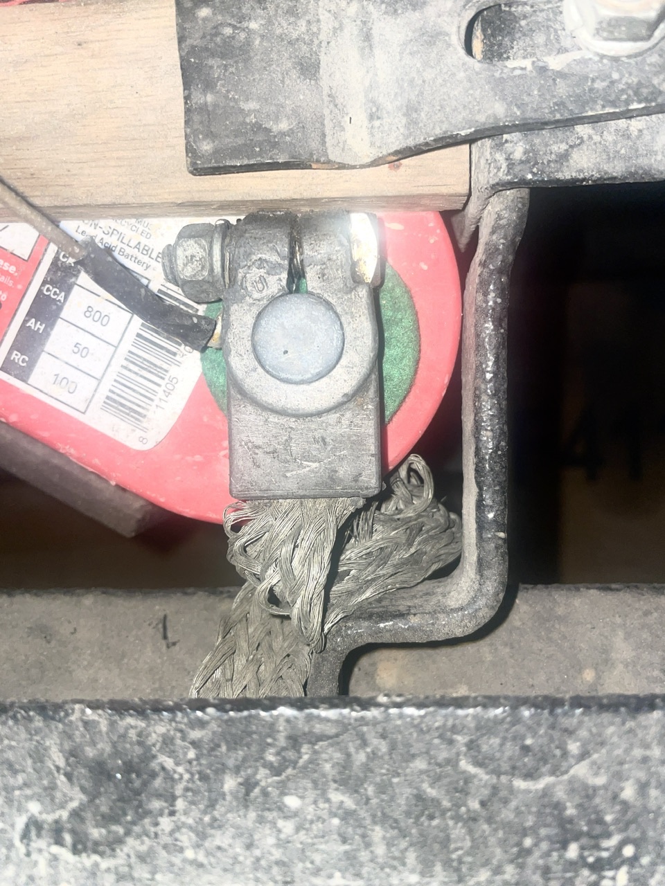

what is the value if a "woven" battery ground cable?
- Posts: 4090
From a mfg. source:
Ground straps are braided by interlacing multiple strands of flexible wire. Braiding creates a structure that is thicker and stronger than non-interlaced wires and that will resist twisting under load. Compared to a battery cable, a ground strap braid provides greater resistance to breaking. During manufacturing, flat electrical braids that started as tubular braids are flattened with a pressure roller for increased surface area.
The flat braided cable in a ground strap is made of tinned copper wires that improves electrical conductivity and corrosion resistance.
For the twisting the Model T chassis does the ground between the battery and frame benefits with a flexible woven strap that is more easily placed by bending the twists and turns needed to fit from the frame to the top of the battery post.
Once read that electrical theory held the negative electrons flowed ‘over the connector surfaces’ , if true, then a wide woven strap would assist!

On all my T's the ground cable goes to the frame, adjacent to terminal on the battery. There is no twisting between the two connection points as they are on a common rail. Flexibility is not necessarily a priority in this application. That said, my son makes my cables using highly flexible cables with a gazillion wire strands that he uses in solar installations on houses.

henryford2
- Posts: 829
- Joined: Sun Jan 06, 2019 4:14 pm
- First Name: Joseph
- Last Name: Andulics
- * REQUIRED* Type and Year of Model Ts owned: 1926 Fordor, 1926 Truck, 1927 Roadster GOW, RAJO Sprint car
- Location: North Ridgeville, OH
Can the gauge of the braided ground strap be less than the positive cable? I’ve not seen a braided cable @ 1/0 or 2/0.Or doesn’t it matter? Thanks

At this length, yes. It's 6 inches.

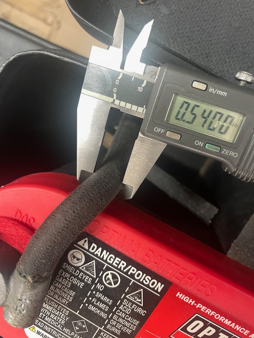

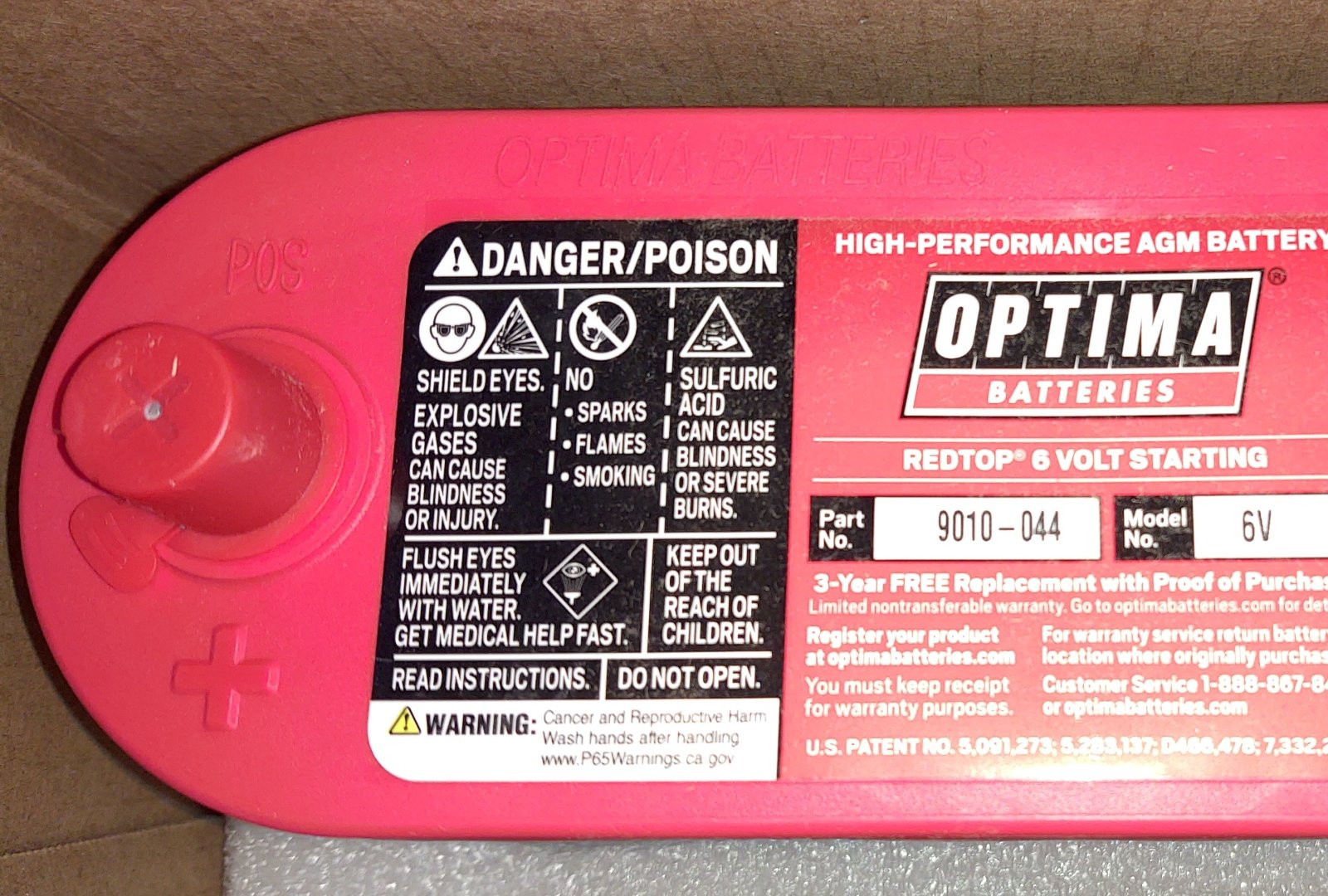

The picture of the red Optima 6 volt battery shows the positive cable connection to the positive terminal of the battery... What is the problem with having a insulated 1/0 or 2/0 size negative cable?.... It's the size of the cable that counts!
- Posts: 8663
I don't know why flat braided battery ground straps and engine ground straps were widely used, but a round cable of the proper size will work just as well. Round cable was commonly used for both "hot" and ground cables on many applications, including dual and quadruple battery set-ups and vehicles with radio equipment installed. In radio equipment and in RF ground applications, flat braided cable is often used because it offers low resistance to RF frequency AC current.
- Posts: 4090

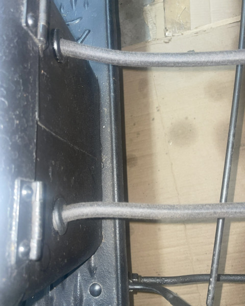

I agree!! In fact that Optima is in the running board battery box, cables exit the box, so for the negative ground, used the same size 0 cable. Works ok in this install as that cable had to reach under and up to the frame.
On other installs that Optima is angled in the Ford battery bracket so positive stays away from any body or frame parts. The ground distance from frame to negative post is short, flexible woven strap was my choice.
