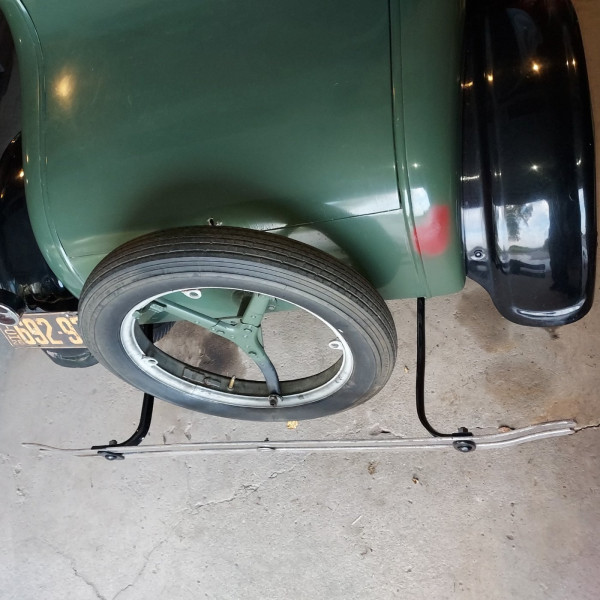

Installed the rear bumpers on my 26 coupe. The Ford bumpers are a real quality product, the bumper bracket holes lined right up with the preexisting holes in the frame. I thought the bumpers sticking so far out would block access to the trunk but there is plenty of room to stand between the bumpers and the body. It is a well thought out design. If I ever do it again though I will be sure to clean the soot off the right rear axle first.

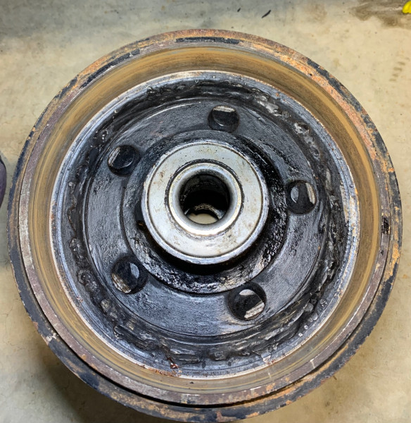

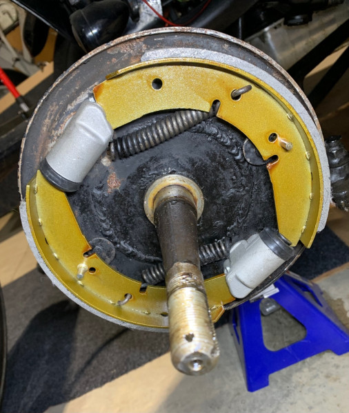

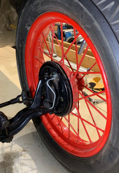

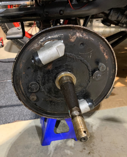

Finally starting the restoration of the “aftermarket” brake system on my ‘27 runabout.
the front brakes aren’t very visible.
“early” metropolitan nash backing plate welded to the spindle.
matching 8” metropolitan nash drum welded to the wire wheel T hub.
new brake shoes and wheel cylinders.
wheel back on with new steel jumper line connecting the wheel cylinders.
more pics to come as I work my way back through the system to the 11” GM rear brakes (early ‘60s).
Keep crankin’
Eric
