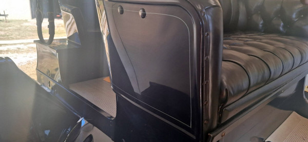

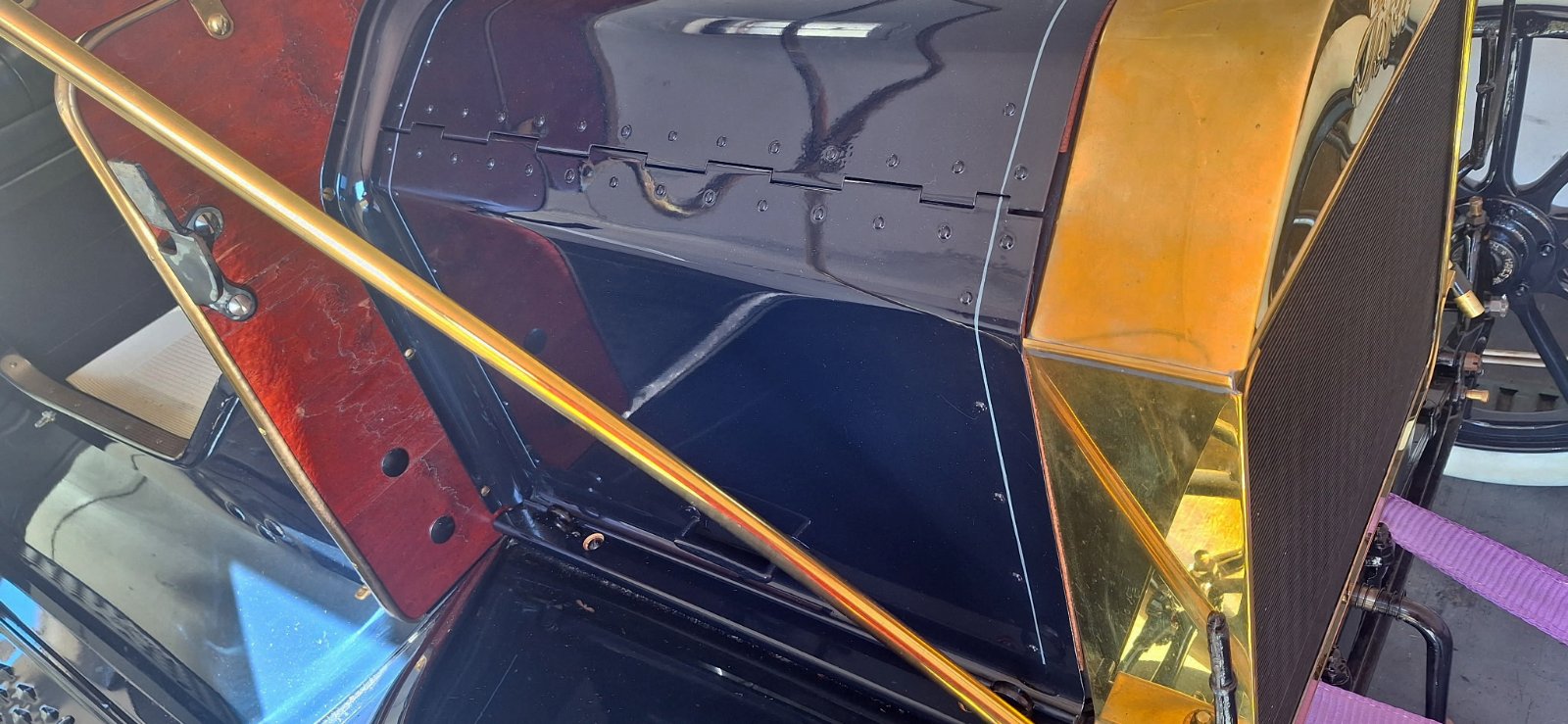

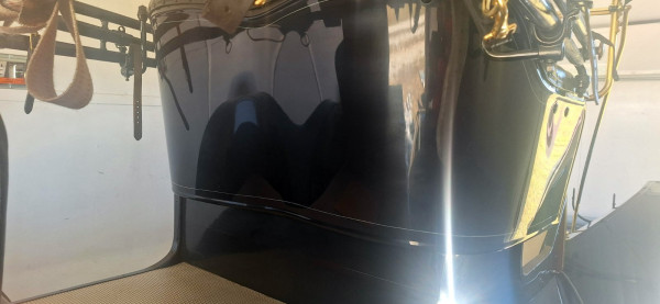

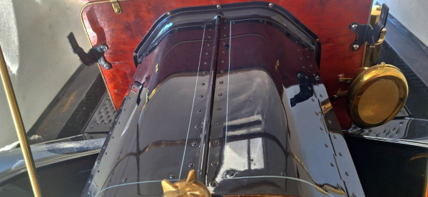

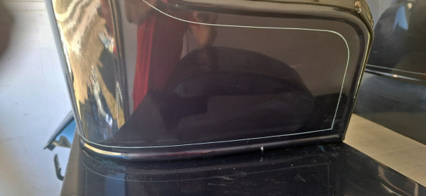

My pinstriper worked his magic on my 1912 Roadster and sent me some pictures. They are iPhone pictures and not the best, but I am so excited I had to share them! All done by hand. He is doing the wheels tonight and tomorrow.

Re: Pinstriping Details 1912 Roadster
OUTSTANDING!!!
You are now an expert!

By the way, those brass screws holding the hood former on were originals taken from an old firewall. Larry Smith would approve.

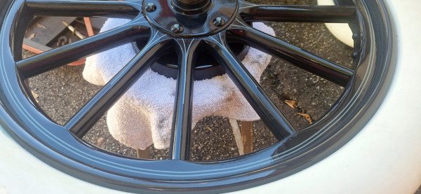

For those who are not tired yet of me blathering on about pinstriping, here is a picture of one of the wheels the striper finished today. I can't wait to get the whole car back and into good light to take some more pictures. Some might think the stripe is too dark, but it is French Gray as Ford defined it.It does look lighter in better light.
