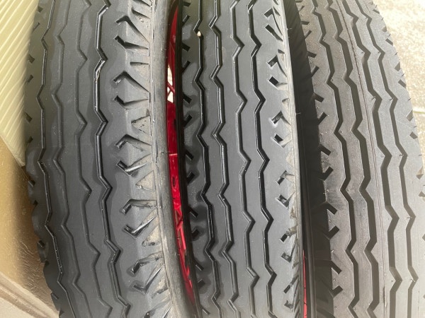

I’ve been told that front tires on Model T’s usually wear faster than rears, but mine are doing the opposite. The one higher in the photo has always been on the front, and the lower one has always been on the rear. All four are Blockleys with about 5000 miles put on them over the last 21 months. I run 60 psi all the way around, and have never seen less than 57 when I check them. Both rears seem be wearing significantly faster than the fronts. The fronts have about .060 - .090” of tread left in the center, while the rears are near zero. The tread depth on the Blockleys I just bought are .220 - .240”.
I have checked the rear radius rods and they are adjusted to the same length as best as I can measure with a steel tape so I think the rear axle is running square to the car. Is there anything else I can check?
Miles

Looks like too much pressure in the rear tires for the load they are carrying. The front tire looks normal. My T wears the rear tires faster than the front. Driving habits and traffic conditions will affect tire wear. Excess wear in the tread center almost always indicates too much air pressure for the application. What kind of car are you driving, and what size tires?
It’s a 1924 touring car with 30x3.5 tires, all four installed new at the same time and always run at 60 psi. The fronts are wearing more in the center as well, just not as fast.

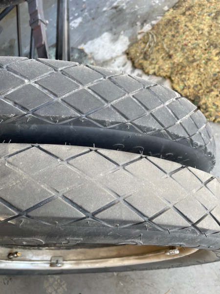

Put these 21" 4.50x4.75 Universal, 4 ply, Nylon tires on the '27 touring in March 2019.
5 years later a bit of tire wear, lots of tour season miles.
The worst one on the left is from the right rear, likely from fast acceleration, or perhaps braking hard ;) The middle is a front tire, and on the right is the spare is as new 2019, hasn't been on the pavement.
Put 2 new ones on the front, last year and moved the better fronts to the rear.
tire wear.jpeg (111.65 KiB) Viewed 851 times

My dial gauge matches my 2022 Grand Cherokee’s sensors at 40 psi, and the wear PATTERN is the same on all four, so I don’t think inflation is the issue. I once had a tire roll off the rim on a straight road while inflated to 55 psi (thought I’d been shot when the tube blew!), so I too will never run less than 60 on a clincher.
Michigan roads are relatively straight, and in the attempt to remain on less travelled roads it’s rare to run more than 5 miles without a stop or turn, so it sounds like faster wear on the rear is to be expected, and maybe I should swap front and rear occasionally.
