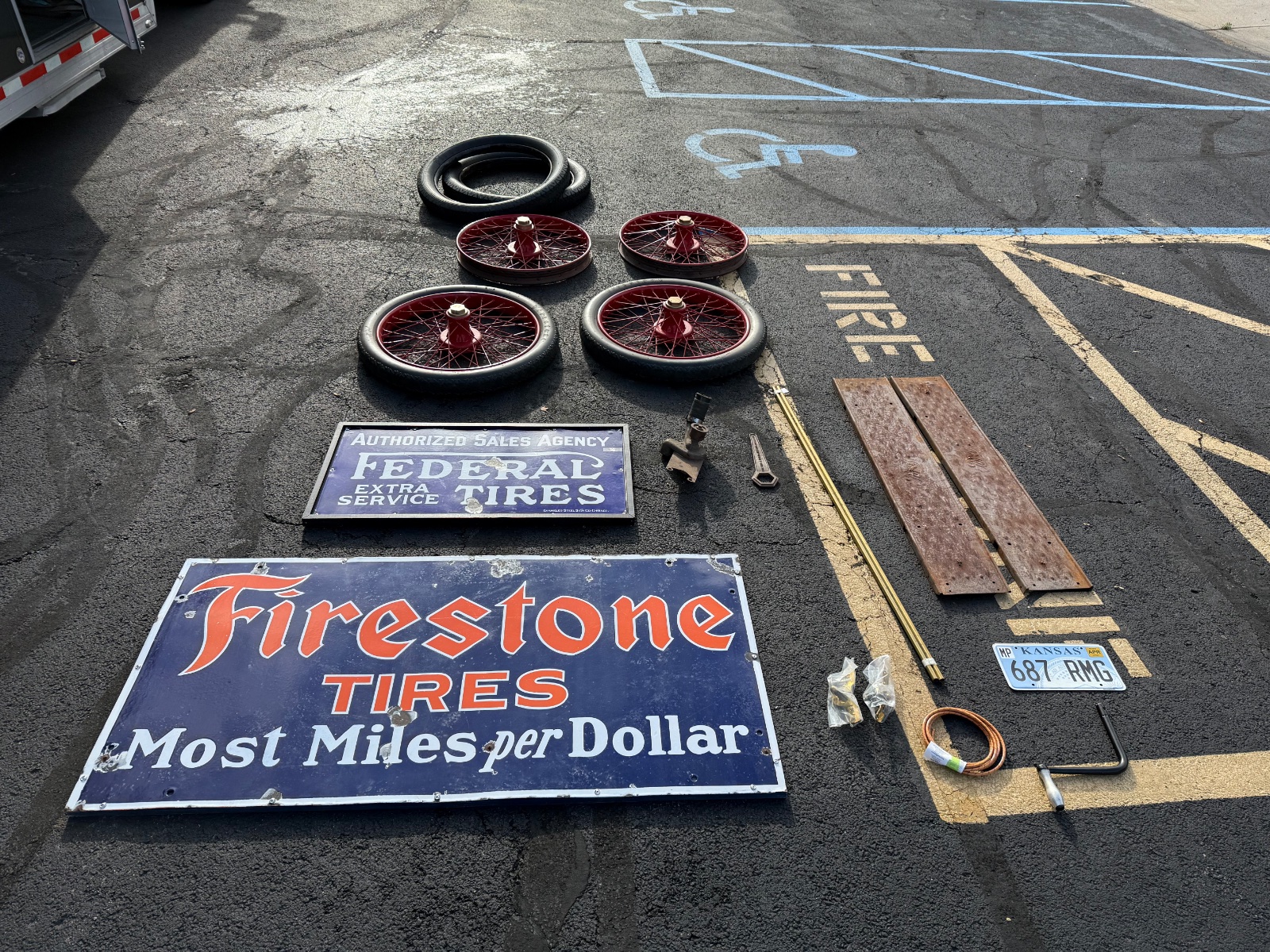

Does anyone have a solid model or drawing of the front hub? Need it for a Buffalo wire wheel that the front bearing was modified. Hershey find!

Got the hubs, they came complete. The inner race was machined closer to the rear race for an Essex car. Need to make a spacer
