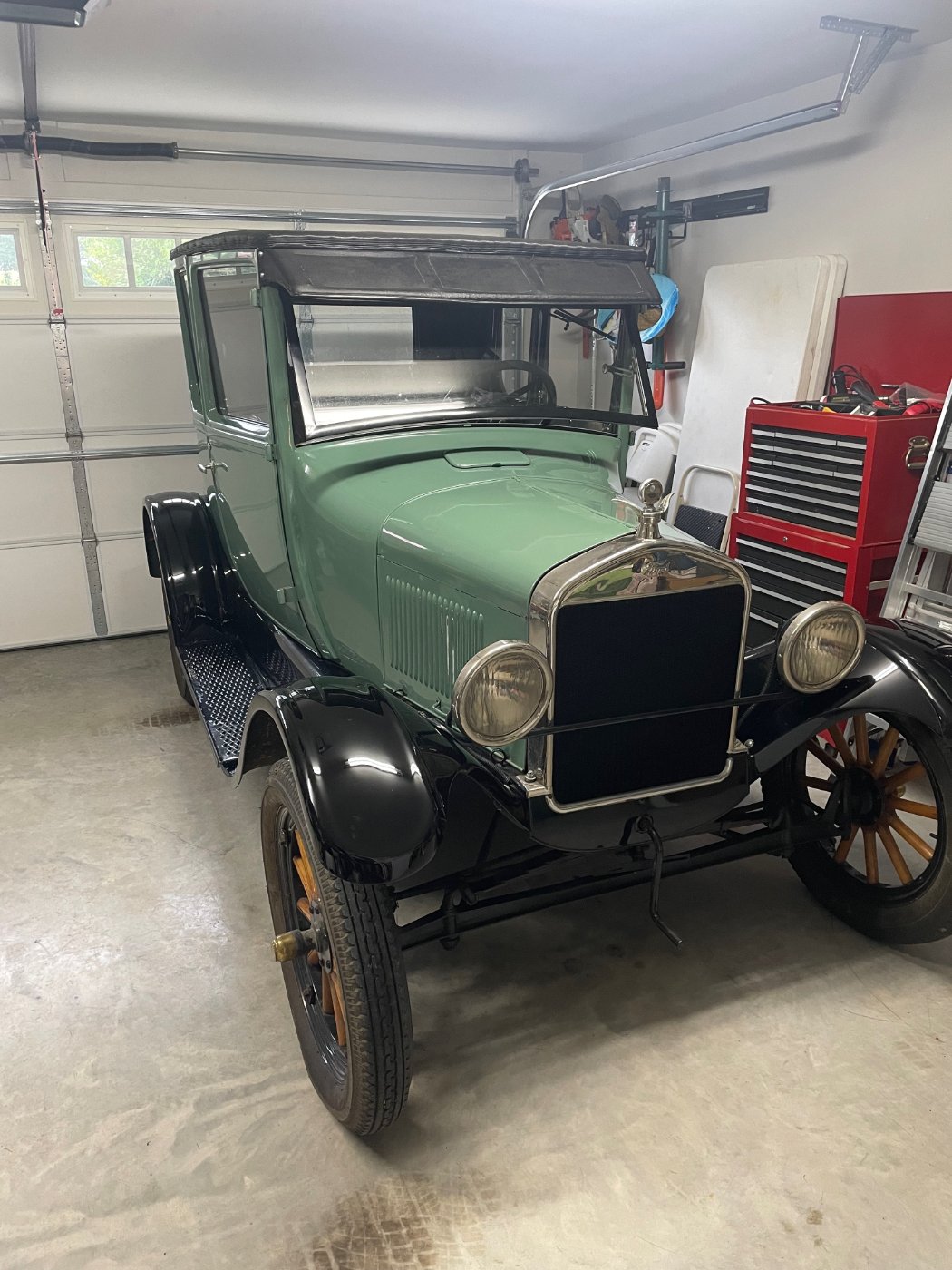

Okay, first off, I want to sincerely thank all of you for providing information for me to get my '27 Coupe up to snuff. I had to get a new timer, had the carburetor rebuilt, and got the coils fixed up.
When I got this car, it had obviously been worked on by someone who just did what was required to get it running, well sort of!
I am going to drain the radiator and replace the coolant just for safety since winter is approaching.
I have NO idea when the oil has been replaced. It is very dark black, which I would suspect is normal for these vehicles. So, I am going to drain the oil tomorrow and replace it with new oil.
Somewhere along the line on these forums, I read where someone flushed the system out with kerosene to clean it up. Is that a wise practice? I don't know when or how this was done previously, so while going through the effort I want to do what is best for the vehicle. Whoever had it previously, had put a regular nut on the band clamps and the vibration loosens the nut, so I ordered replacement ones with the indent and am planning to replace them when I drain the oil.
And yes, I have been told to stuff rags into the transmission opening to keep from dropping parts in there. That might be the cause of the non-standard nut and washers on the bands.
If I can get enough of the oil drained/cleaned, maybe I can use a scope to look in there. Am I going down the right path?
Thanks in advance as this is all new to me.
