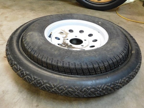

Photo courtesty of Dan Hatch.
My father used this same procedure 60 years ago to stretch a set of metric Dunlop 875 x 105 clincher tires so they would fit the 27 inch wheels of his 1910 IHC. He said he let each tire sit on the modern tire over night.
Note that this works only with clinchers because there is no wire in the bead. It will not work with straight-side tires due to the wire in the bead.
