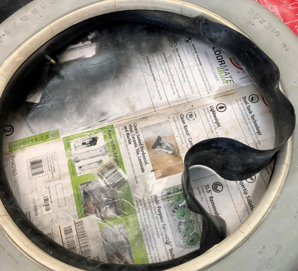

I'm a flap guy when & where needed - been doing most of the local club's guys' tires for years - never had a do-over ! I do wires also but clearly those use rim strips !

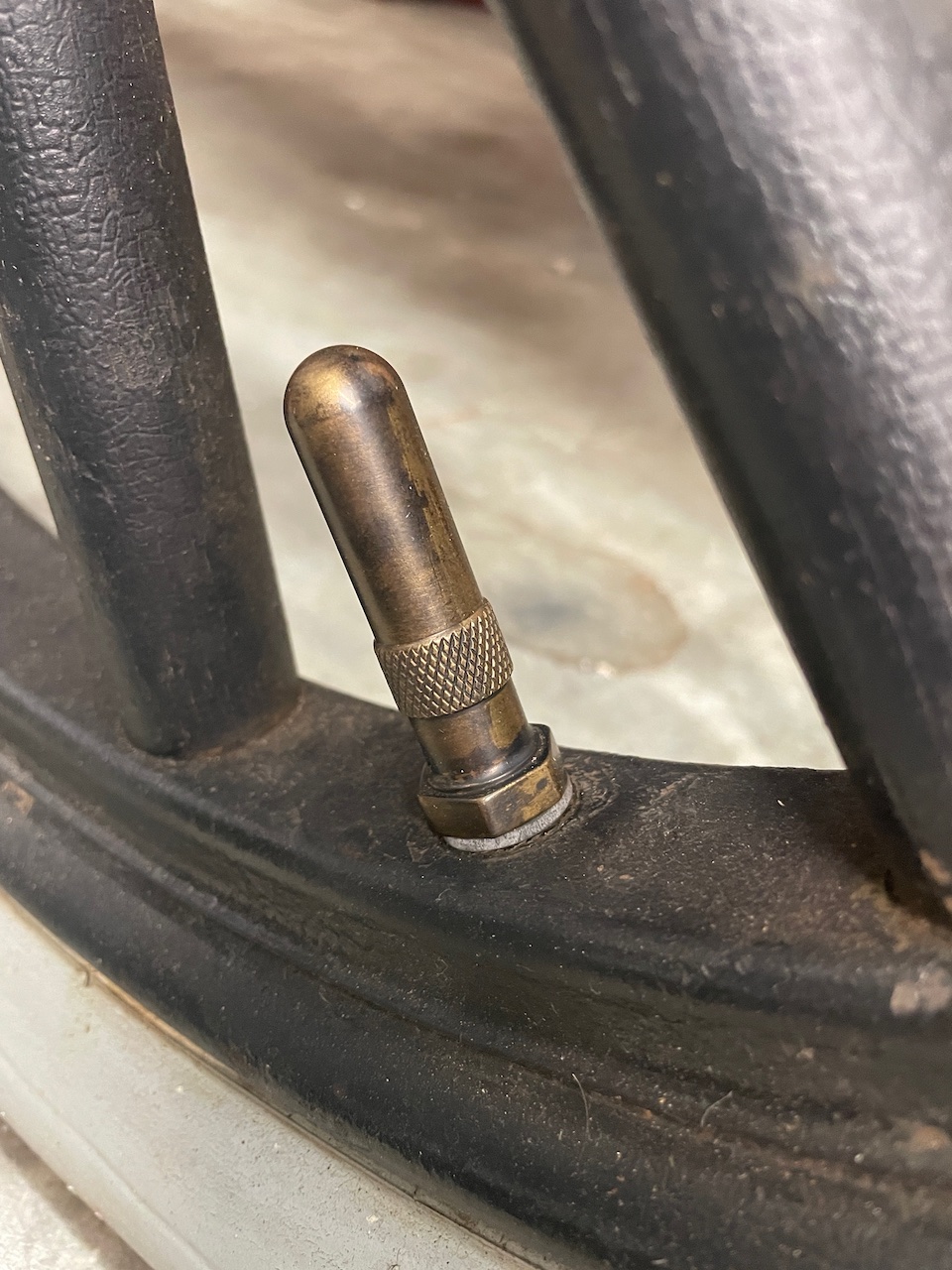

I recently had what I thought was a simple flat tire, but evidently was a blowout (I found it while parked, and the tire was still fully on the demountable rim). The damage to the tube is on the inside diameter, so it just about has to be from chafing on the rim, or possibly some small foreign object (no rim liners). There’s weld spatter evenly distributed around the rim, but no apparent chafing anywhere else on the tube. Both the tire and tube had about 5000 miles since new, and I had never let the pressure get below 55 psi. I have rim liners on the way.

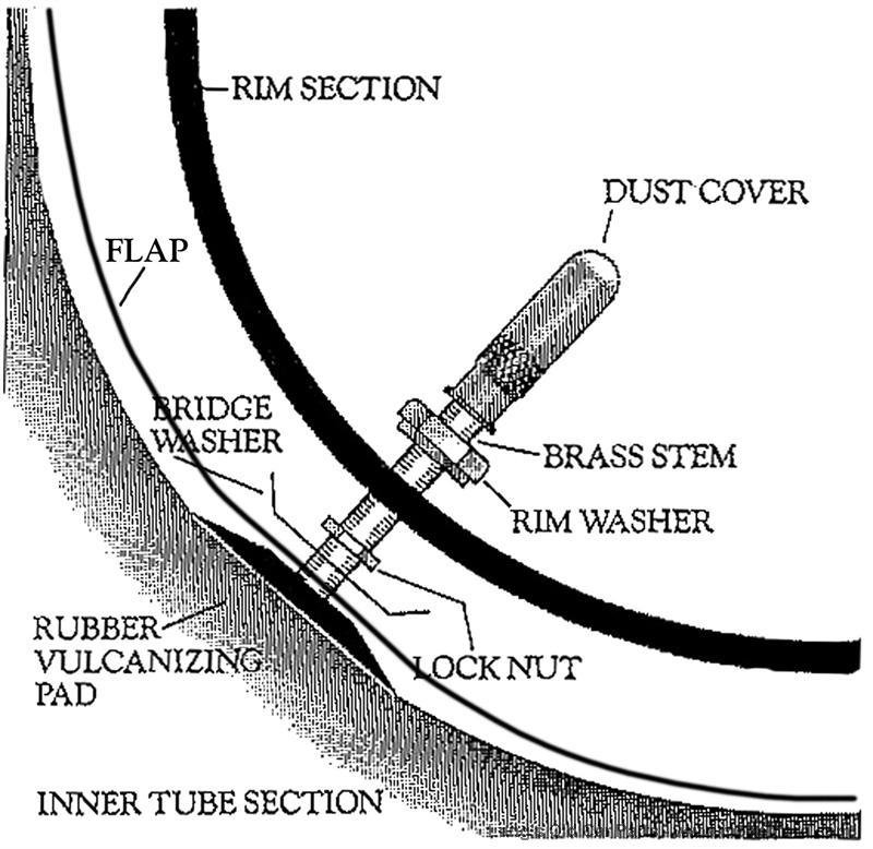

I wish there was a way to have that erroneous drawing of a tube/flap assembly gone forever. It clearly shows the flap sandwiched between the tube and the bridge washer, making it an assembly. This is just plain wrong! The valve stem, bridge washer and nut have the task of jamming the tube and the flap to make a leak proof seal. Given the junk material used to make flaps today, and the thickness of same, getting the correct crush to make a seal is never going to happen, and if it does initially, it is not likely to be maintained. There is little elasticity in the flap "rubber." It is more likely to be displaced than crushed. Things may have been different in the old days when both tubes and flaps were reinforced with fabric layers.
Flaps and rim liners do the same things. They protect the tube from irregularities within the rim. Flaps will protect the tube from potential damage if your tyre fitting technique is wanting, but conversely, they inflict considerable damage to your bank bank balance. It is a matter of choice.

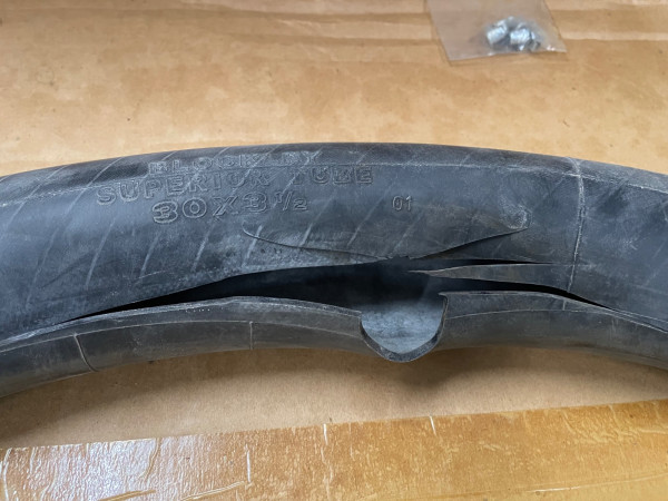

Blockley tubes are recommended to NOT use flaps and based on their very hefty thickness, I tend to believe Blockley - and they're the ONLY tube I would chose to not run with a flap. Every other brand would and does, get a flap and I've never been let down by that decision in over 25 years of "T" driving.

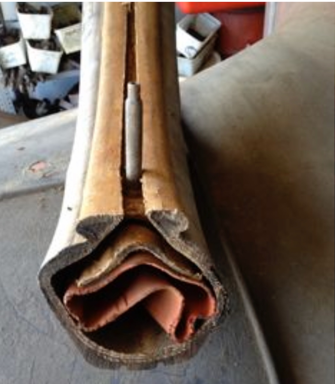

Here's a really old time tire, with red tube, cut away to show flaps used in the T period.
Use flaps too, they help prolong tire life and resist tube fails, IMO
Have always using rubber stems, the rubber stems hold up.
For dress, add the faux dust cover that affix to the rubber stem valve thread ;) for bit of authentic look. :)

Dan great cross section showing the flap.

Nice photo of an original cross section Dan. I note that even with the wide bead foot on that original tyre, there was no need to notch the beads to accommodate the valve stem.
I once bought two excellent rims with two as new, but extremely hard Good Year tyres that even had the blue and yellow flag motif on the sidewall. I fought those tyres off the rims, and salvaged two thick red rubber tubes that were also new. That was about 15 years ago and those tubes are still in use. I learned not to resort to a sawzall when a fellow I was helping on a restoration cut four tyres off, taking with them 4 excellent Olympic butyl rubber tubes. I hope your tube was already shot.
Note also that that flap has a fabric cover. A few years back mate of mine hung four new rubber flaps on a nail in his workshop. six months later they were al in a heap on the floor, having perished at the hanging point. i think they were made from floor sweepings at the tyre plant.
