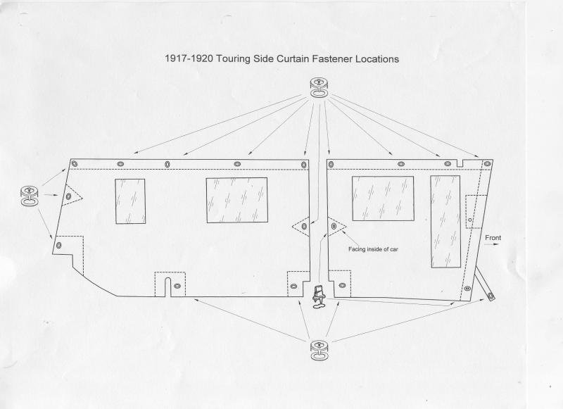

I found this pic on fastener location elsewhere on the forum.

I looked at pictures and diagrams from the forum (especially those from Larry Smith) to give me a good idea of where the fasteners were placed on the top bows and body. Once those are installed, use Larry Smith's method of making paper or light cardboard patterns that match the shape of the side curtains to locate the curtain side of the fasteners. Iterate as necessary until the paper patterns fit perfectly, then use the patterns to locate the fasteners onto your real curtains.

Thank you for the info Mark. Today we put up my top to protect us from sun and/or rain. I noticed the top has 3 fasteners in it and the back panel has 2. Do not know how they knew where to put the top fasteners. They are pretty much equally spaced. Yet in the diagram above, there are more than 3. Maybe that is why side curtains come without fasteners installed - so you can match them up yourself.

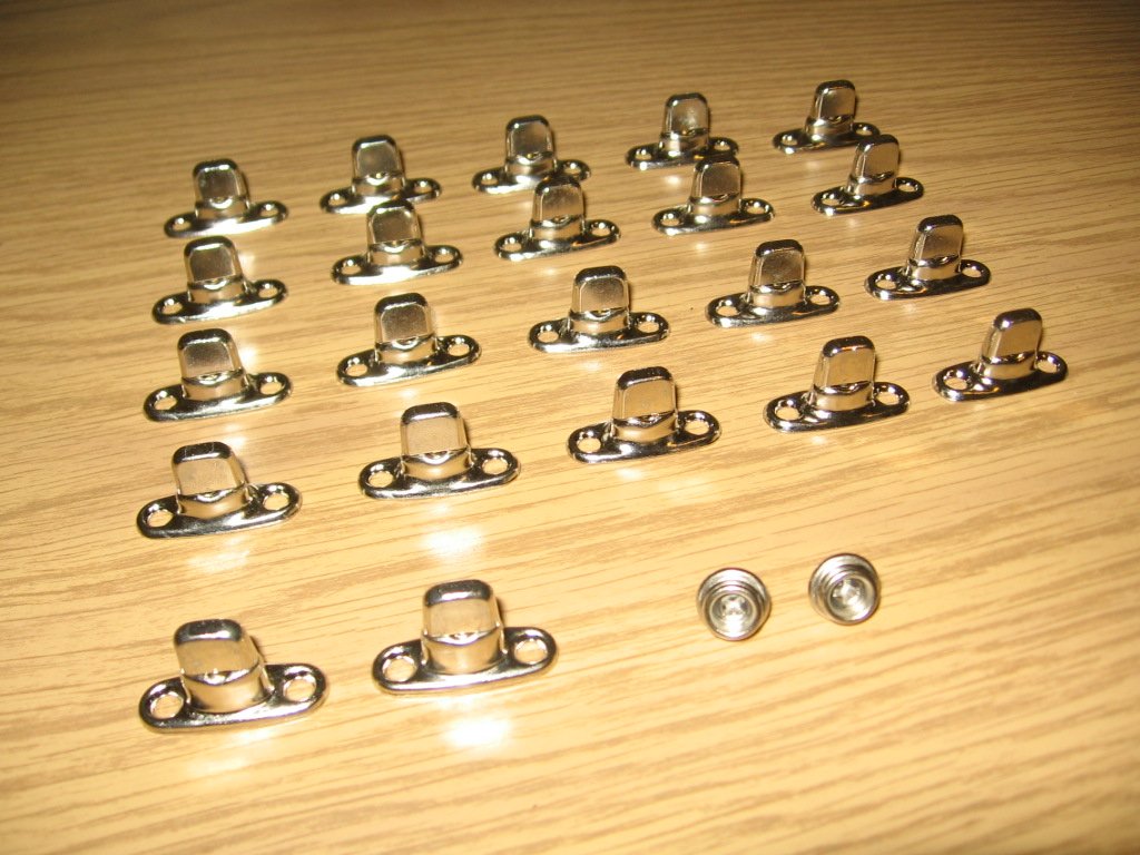

Just came back from a dealership that has an old 1917 Ford in the showroom. I noticed the side curtains on the floor and was allowed to take them out of the car. The side curtains have no fasteners of any kind on them. They must have been purchased and thrown in the back, never to be used. I also searched the entire car. The top has 5 fasteners and the windshield has 2. There are none on the bows. In the above picture it appears that there are about 18 grommets in the curtains. Is 18 the number that you have on your curtains?
