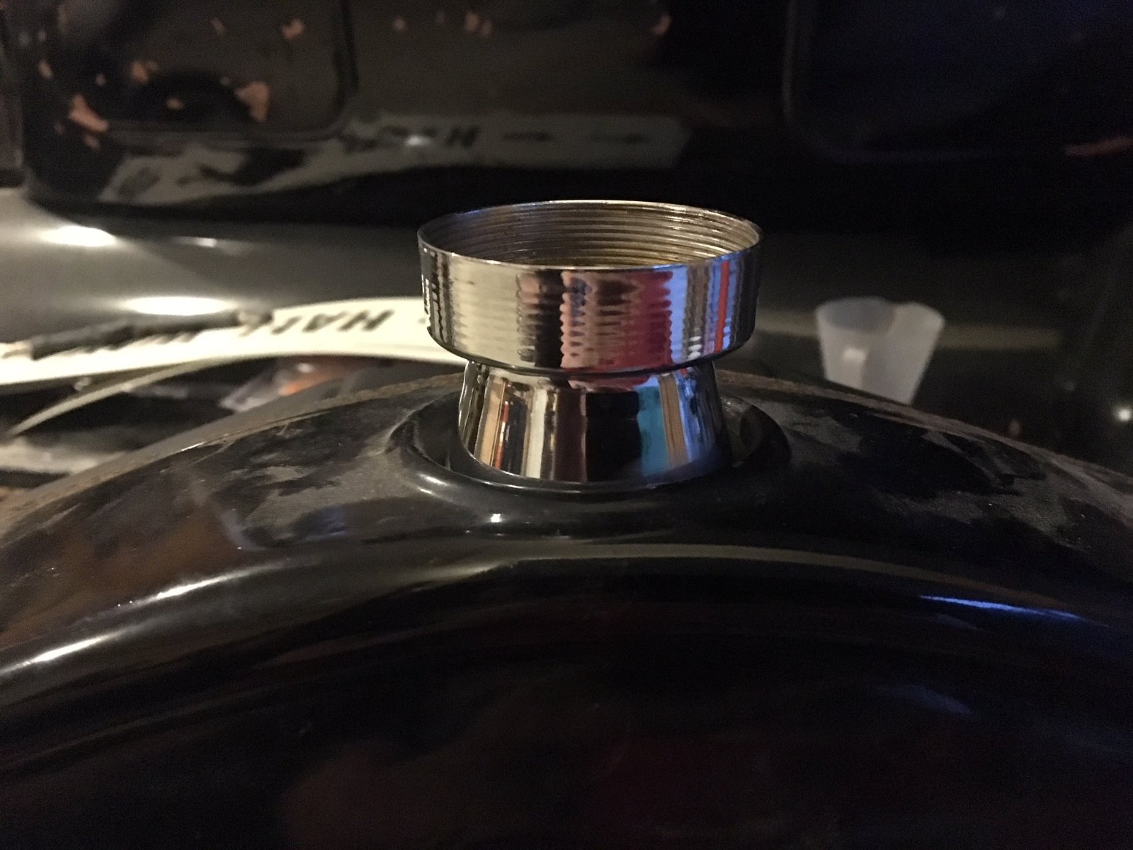

I just bought a brand new radiator from Berg's. It was delivered today! It looks really nice. You can tell the quality is very high. There was an issue with the supplier who was making the necks for the radiator but Gery was able to finally get them made. I knew it was going to be a bit of an extra wait but I didn't mind since the weather hasn't been the greatest in the Northeast anyway....
Here is my question. I measured my old radiator several times. I was VERY confident that I had the low radiator based on the measurement of the core, the measurement of the hood and the measurement of the firewall. When I went to install the radiator tonight, the shell isn't fitting all the way down on the neck. I can't really remember how my old one fit....The problem is I threw it out because it actually blew a huge hole in it on my last ride as it was literally falling apart. I never thought I would have needed it. The shell fits about 1/2 inch above the top of the radiator. since it doesn't sit on the wide, lower part of the neck, the shell is able to move back and forth a bit in the opening. Do you guys have any thoughts on this? I still think my car is supposed to have a low radiator. I think the high one wouldn't fit right either based on the measurements. Is the shell supposed to fit right down tight to the top of the radiator?

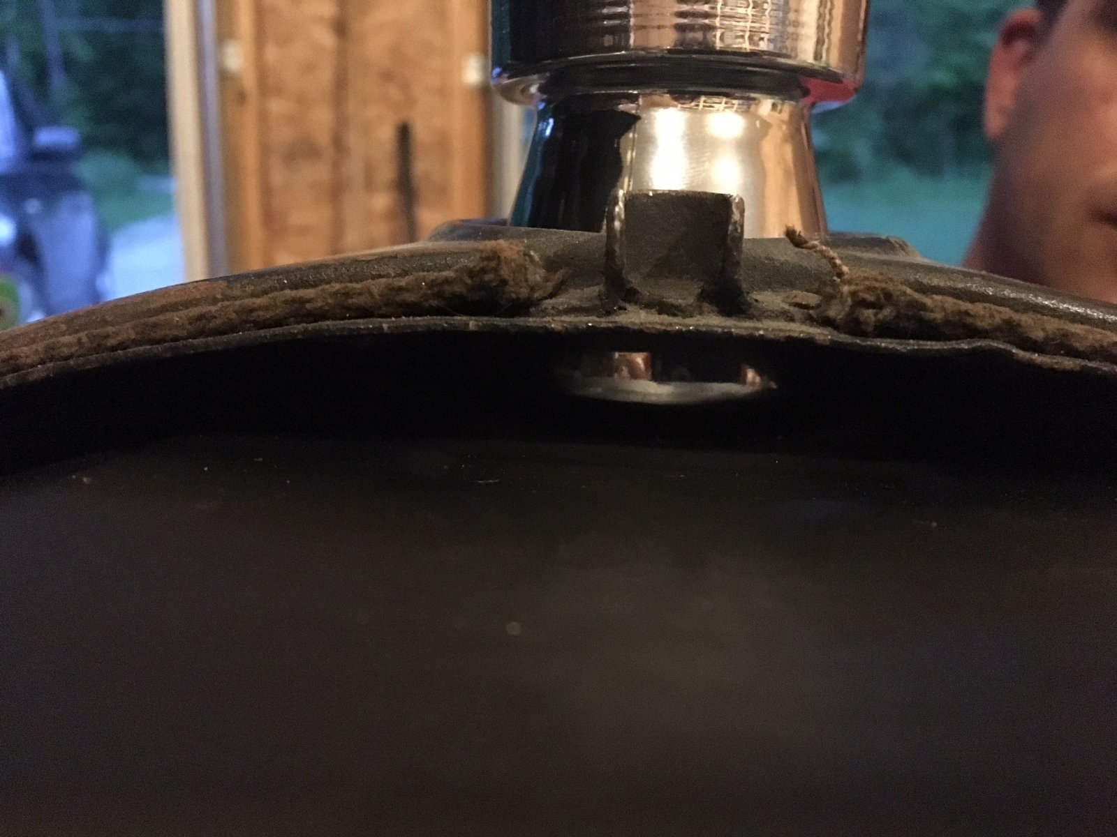

In the photos I posted, I have the radiator off the car, and the shell over the top. The tabs on the shell are resting on the tabs on the radiator with no space between them. The shell can't get any closer.
I double checked the hardware I was using against a parts diagram I found online. It appears to all be correct.

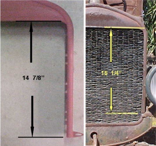

I measured my High shell. The triangular section with the Ford script from its bottom lip to the top of the shell is approximately 4 3/4 inches in height. From the bottom of that section to the top of the shell dog ear is approximately 16 1/4 inches. Total 21 inches. Now there was a photo (attached) in an old Forum thread that implies that the High shell triangular section is approximately 6 ". Having said that, the arrows in the photo appear to show a different reference point, so that measurement is in question. It would help for others to provide measurements as well for comparison. Hope this helps. Frank

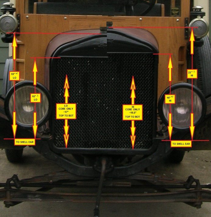

Another photo for High & Low shell differences

There is almost an inch and a half difference in height between the low and the high shell.
Looking at the top (OP) photos, it appears to be missing fitting by only about half an inch.
A high shell put onto a low radiator almost reaches the top of the radiator neck.
Looking at how much of the neck shows in the OP photos makes me think it cannot be a high shell on a low radiator.
