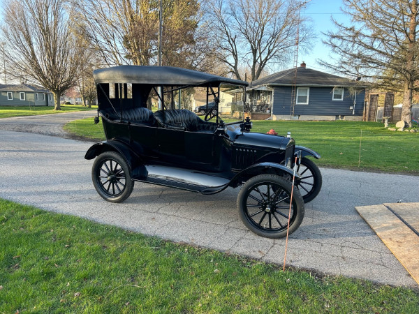

Here is a late 17 model probably and 18 model year. This is for reference only.

Mark E, I don't know whos car that is? However, it is beautiful, and from what can be seen in that photo a very right looking 1917/'18. It appears to have the proper non-demountable "rounded" felloe wheels (changed somewhere around 1918 to the "square felloe" wheels. I couldn't be sure whether the top sockets were the earlier oval type or the later square type. That is another detail that changed "around" 1918. I suspect that both the wheels and the top had a longer than usual crossover time than most changes. But that is a factor that is still being debated.
I also couldn't tell if it has the earlier or later style horn button (and companion light switches?)?

It my sons has the combo horn switch and the rectangular sockets. It has a dec of 17 casting date. It was last year’s stynoski winner. It was from Texas and was a car that had been burned in a barn fire.
