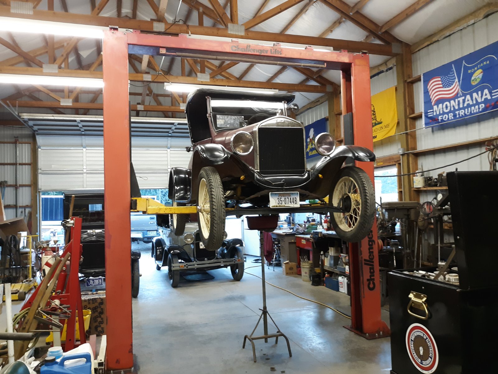

Movin' stuff

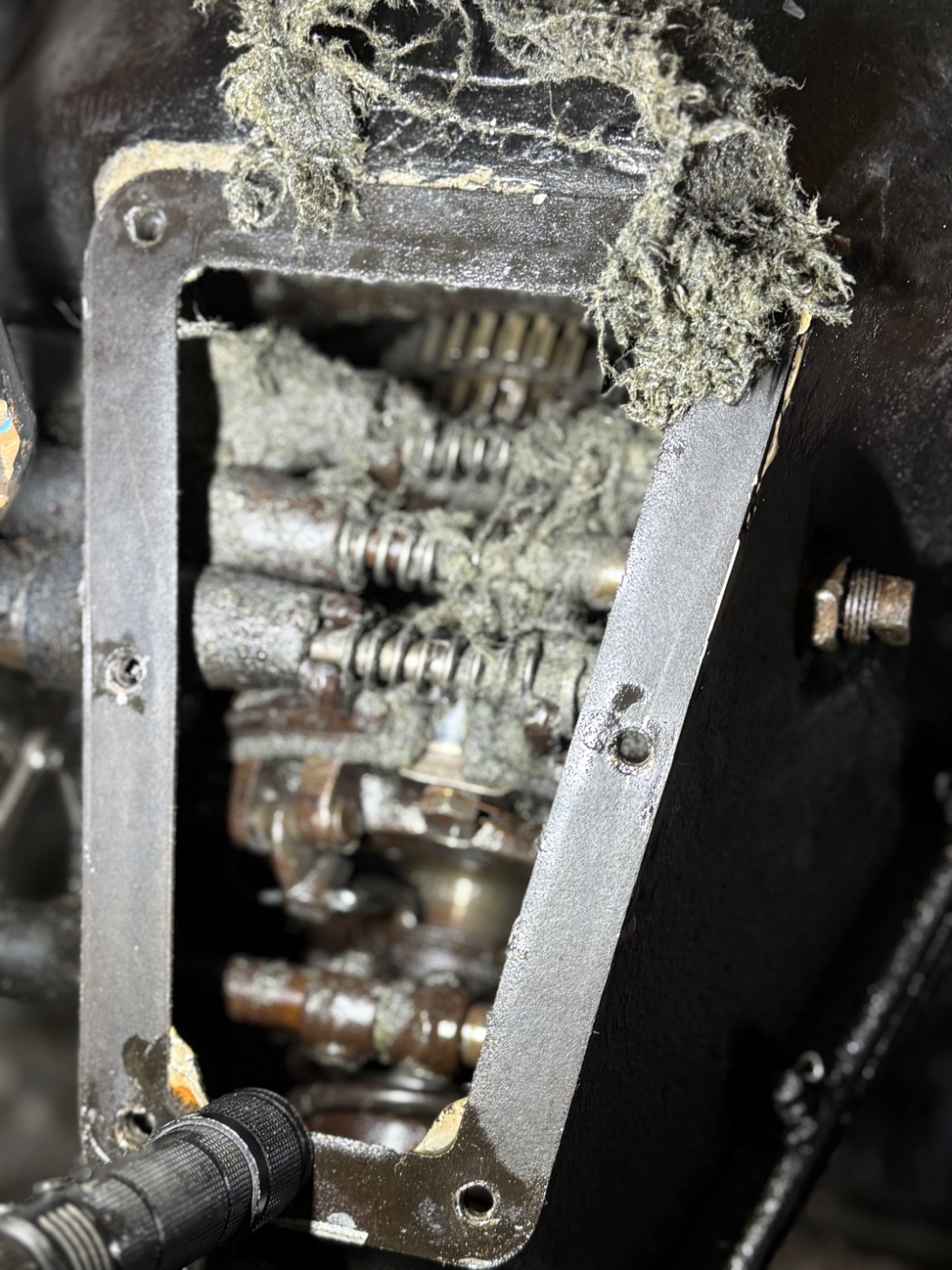

Getting to know the status of my Grandfathers T. Took off the inspection cover to take a look around in the engine. Just want to get familiar with the engine and it's current state.
Have to say I was pleasantly surprised! First thing I see is dippers on the rods, then aluminum pistons. Everything looks good and I can see shims still remaining on all the rods and the mains. The car has no knocking, but being new to Model T's figure any knowledge is good knowledge. I wiggle the caps and there is no noticeable play, only a very small amount of side to side play. No sludge or build up.
My plan was to figure out how to blow out the oil line, just to make sure it is clear. Then add two of the internal accessory oil lines, figured they can't hurt to have. Oh and check the rod bearings to see how they are doing.
I rigged up an air hose setup that I was able to worm through the gear to the stock oil line outlet. Gave it a few generous blasts with the air and could feel the air flow coming back from the hogs head. So seems clear to me.
Pulled the #1 cylinder rod cap and the babbit looked great. Still had shims left on both sides and the crank was perfectly smooth. Put a piece of plastigage in, retightened then compared to the gage. It was a nice uniform thickness all the way across the bearing, measuring 0.0015".
Did the same to the #4 rod and had the exact same 0.0015". Decided to leave #2 & #3 alone as all looks and sounds just fine.
Now time to add the two accessory internal oil lines. Took out the "horseshoes", cleaned them up, ran a tap through them to clean the threads. Then test fit the oil lines to them. They needed some tweeking to get a good fit, but nothing crazy. It was a bit tricky to get them in position, but managed to after a few derogatory words. Then made sure there were no clearance issues, all good.
Cleaned up the Inspection cover, un-dimpled the bolt holes and got it good and straight. Gave the IC bolts a good run in degreaser in my small ultrasonic cleaner, then rinsed and dried them. Gave it a thin film of Ultra Black on the gasket side, let it tack a little them placed the gasket on it. Then aligned the cover/horseshoes and oil lines up with some 4" long bolts. Then put a thin film of Ultra Black on the cover where the nylon washers/bolts would go. Put a small amount of Ultra Black on the bolt threads at the shoulder of the bolts, slipped the nylon washers on and slowly started bolting it up. I very gently snugged up the bolts with a nut driver using a torque pattern from the center of the cover to the outsides. When the gasket was compressed uniformly, did a two stage tightening lightly by hand with a small 1/4" drive ratchet, Certainly didn't want to strip a horseshoe thread or over compress the gasket. Then let it all dry for 48 hrs.
Put oil in it today (10W30) and gave her a start. Sounds great, purrs like a kitten with a gas problem and no other noticable sounds. Oh and the big question..... No Oil leaks from the inspection cover! I would call this a great start to November!
The next project is to rebuild the rear axle, drive shaft tube and add some Rocky Mountain brakes. Need to do some research on all of these then will start the work.
New Caretaker of my Grandfathers Model T. Learning how to maintenance it, keep it running and fun drives around the New England Seacoast. Not new to working on cars and motorcycles, but definitely learning the unique things that the Model T has. It is a fun journey and am thankful to have a community like the one here to help. Cheers, Steve

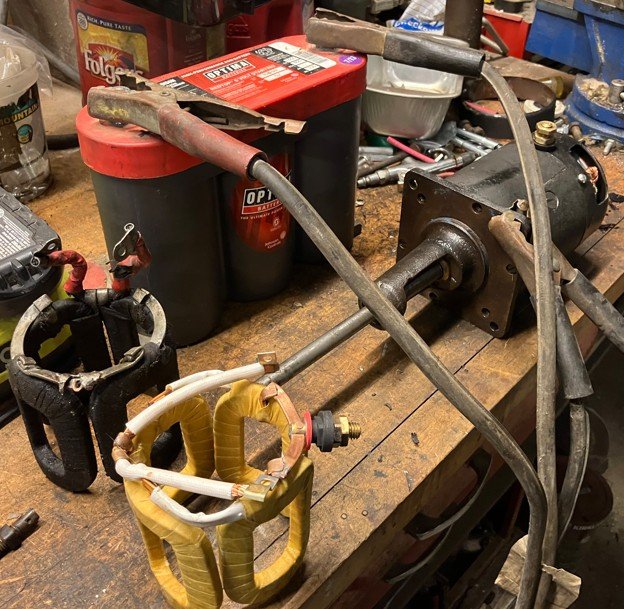

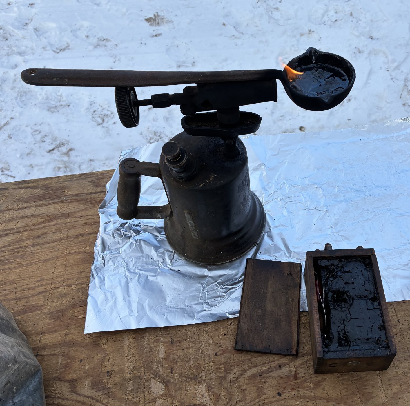

I needed to use my press to remove the pole screws from the starter that went bad at the Old Car Festival. I spent several hours putting stuff away and sweeping the floor so I could use my press for ten minutes. I felt like I accomplished something and the shop is a bit cleaner.

Post by TMiller6 » Wed Nov 05, 2025 9:41 pm
Dennis, you’re wrong about the 30%. My wife didn’t call me, my son was at work, so I did get to work in silence.
I did throw a new switch into my parts washer as I shoved it in a new corner. That wasn’t planned.

I rebuilt the starter off my car. This one got away from my previous rebuild projects and had to be replaced at a show.
This one received the new design one piece field assembly along with a new brush plate and brushes. I stamped one of the pole screws so I or my son can identify it someday without taking it apart.

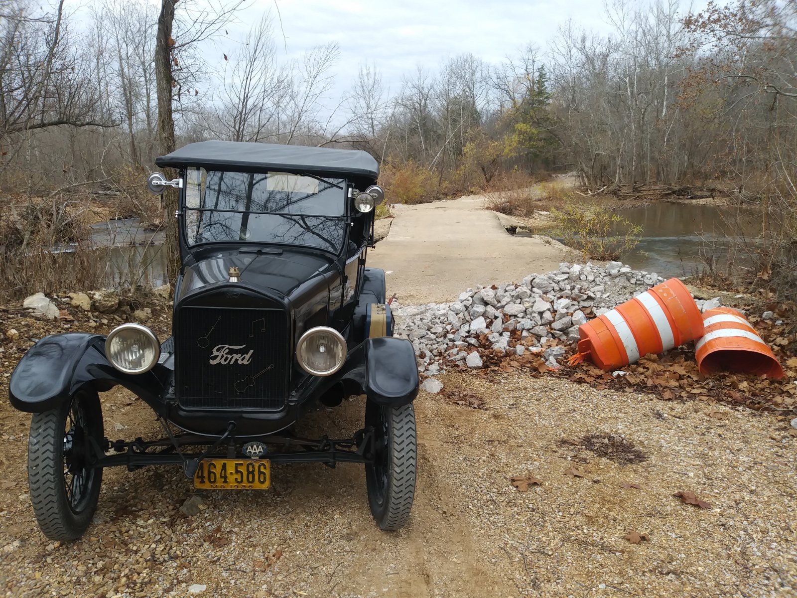

When it is 75 degrees in mid November in Kansas, you take your T for a drive! I also finished putting together the engine from my 1914 touring project. It is a low mileage car, and the babbitt was good and the dimensions within tolerances everywhere, so I put new rings and replaced the original standard size cast iron pistons with some later standard size cast iron pistons from a 22 engine that I rebuilt a couple of years ago. I can see why the Ford service information encouraged the service shops to replace the old pistons if they were into an engine; the newer cast iron pistons are each about 1 lb lighter!
