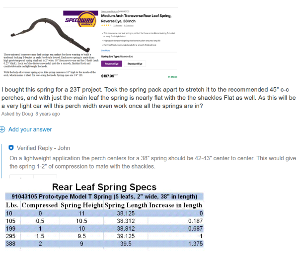

You will have to have the eyes of your existing rear main lief inverted by revering the arch. No one is doing Model T' springs anymore.
This may be a long shot, but Speedway has a medium arch 2in reverse eye spring. the arch is 10" (note the spec say 11") but should give a 1" drop if it works. You may need to ask them for your application. The price for the entire spring is about what a single main lief would cost & they ship free. You would need to make up the difference in thickness in fitting & clamping in the rear cross member
