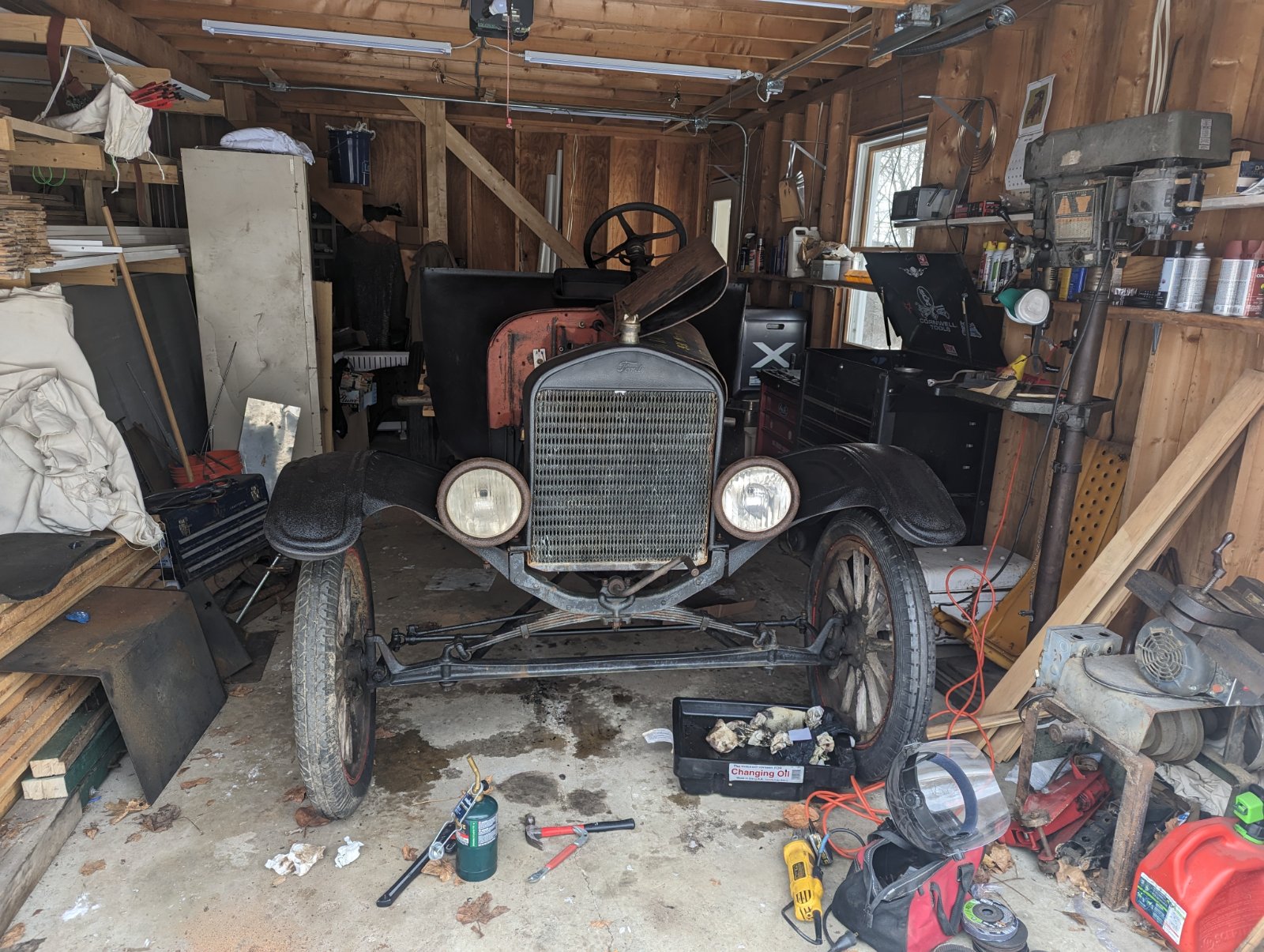

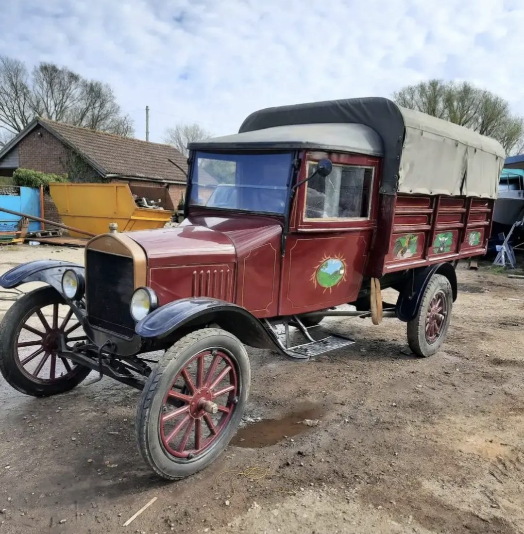

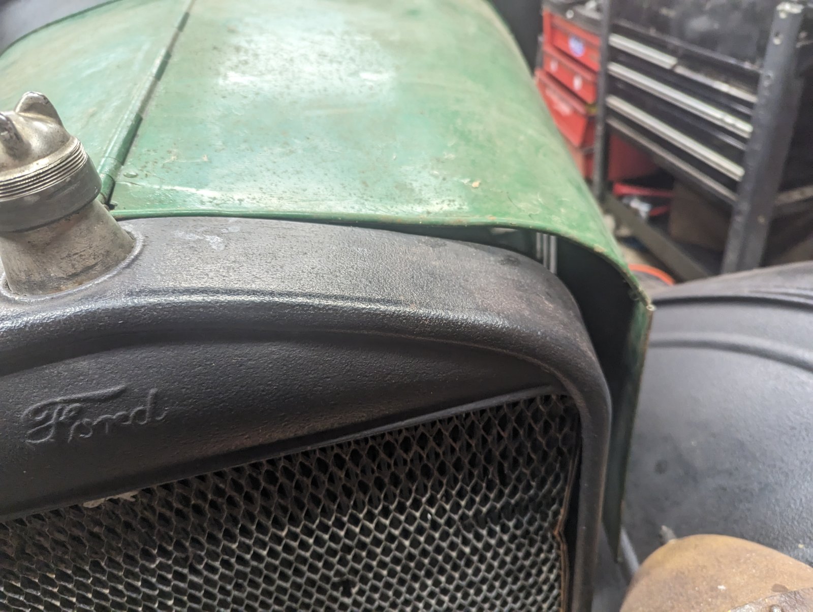

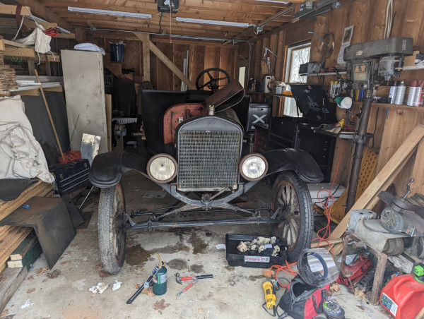

Hello all! New member here, working on rebuilding a 24-25(?) TT I procured up here in Maine, and have been slowly piecing it together ever since.
So far, the old girls been pretty cooperative, and has shown no issues in the course of my inspection and repairs (save for the radiator and wheels). The engine has good compression on all four cylinders, and the starter kicked right up when I wired in the battery (Finding the battery holder straps was a real test).

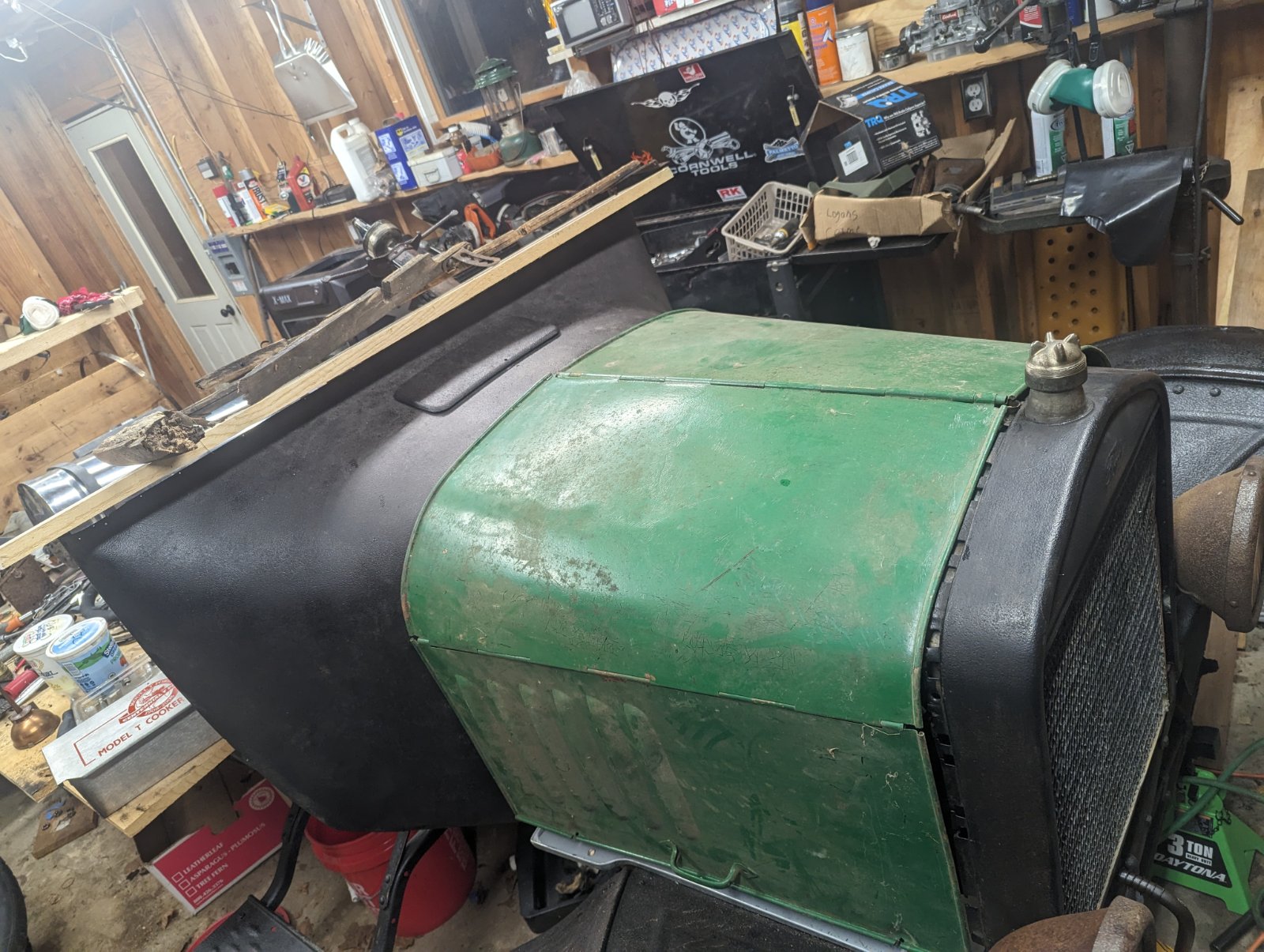

The hood has the original business attire, and luckily, I found a replacement hood, as I don't plan on incorporating the original writing.
Found the cab cowl locally under a bush in someone's backyard, for a song, haha!
Anyhow, here's to further smooth sailing!

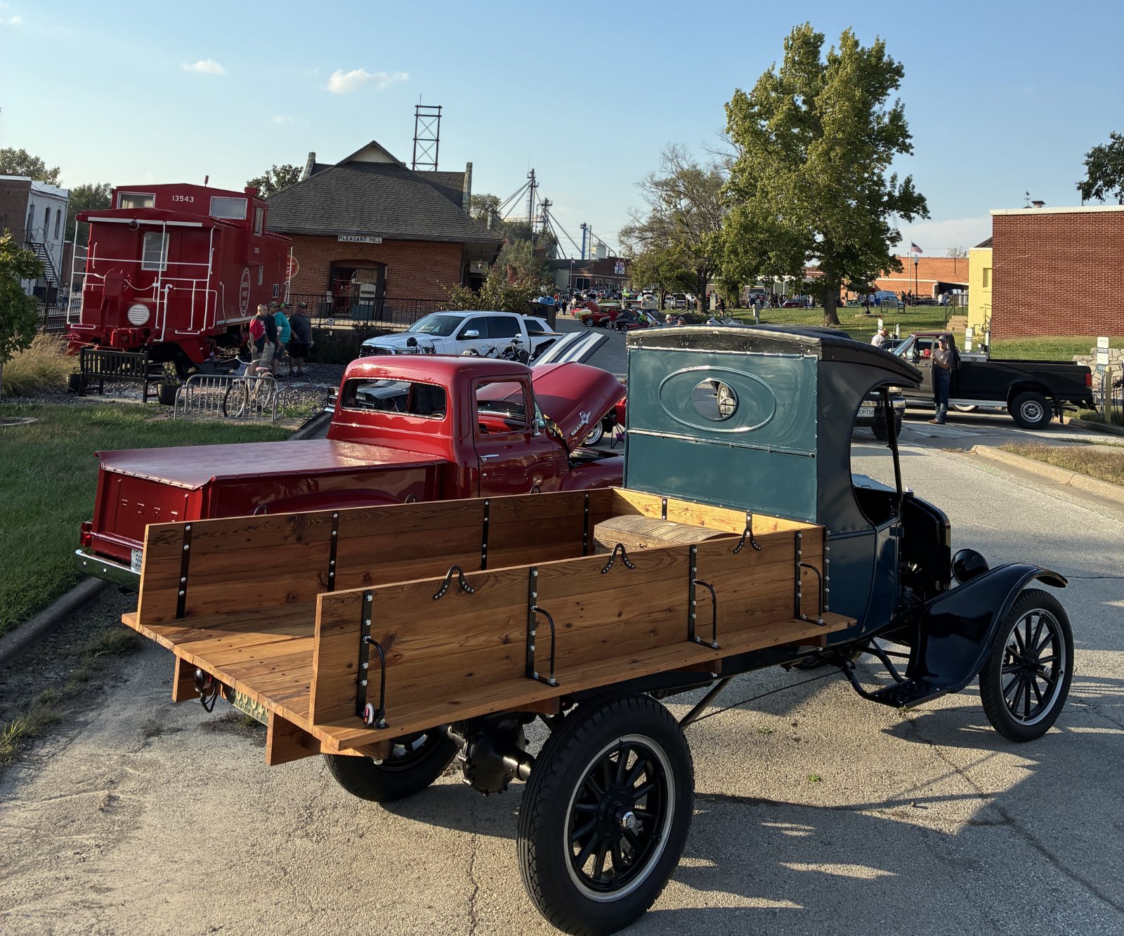

I just finished a '25 TT in October. Let me know if you have any questions, need any comparison pics, measurements, etc. I don't have all the answers, but I learned a lot getting mine back on the road. Picture is at a late October cruise night in Pleasant Hill, MO. That was its first journey out of my driveway and yard. My best to you on your restoration.

I like the C-cabs with an express bed.

Thanks for the welcome!
I have done precisely nothing with the rear end, save for checking (and adding) oil levels to make sure it wasn't rusty inside. I can only speculate on the ratio.
Frankly, I'm looking into modifying a car diff and pumpkin to attach to the TT driveshaft and axles to attain something resembling the neighborhood speed limit! Since the old gal isn't going to be hauling a ton of rocks anytime soon, the torque won't be missed.

That's a beaut! I'm planning on building it in a fashion similar to this one, with a canvas top option and semi open cab. An important feature, being that it will *just* clear the garage door! :P
I'll certainly be posting questions on the forum as oddities arise, I've already found and corrected a few!

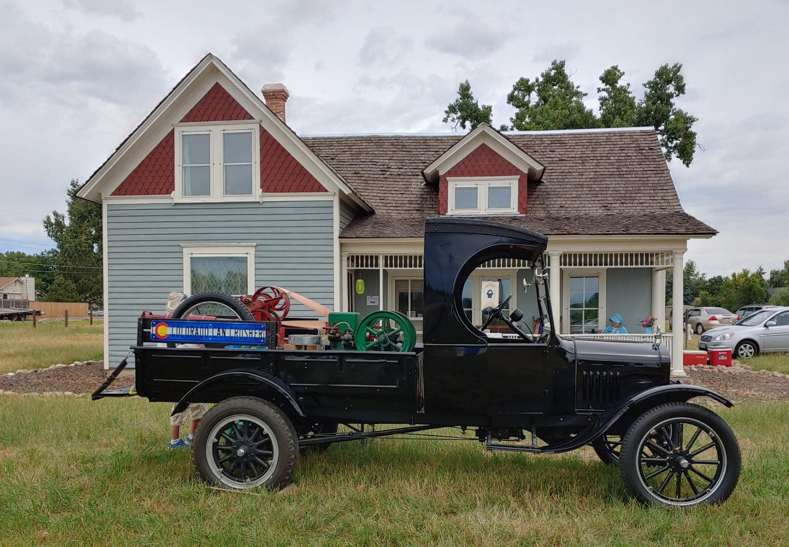

FOR TXGOAT2:
1925 C-cab with Express bed.

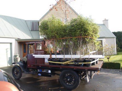

Welcome to the madness ! Here's mine - Gramps bought it new in Seattle in '24. Use to take it camping with our 2 daughters when they were small.
grandpa's truck0001.jpg (27.44 KiB) Viewed 1872 times

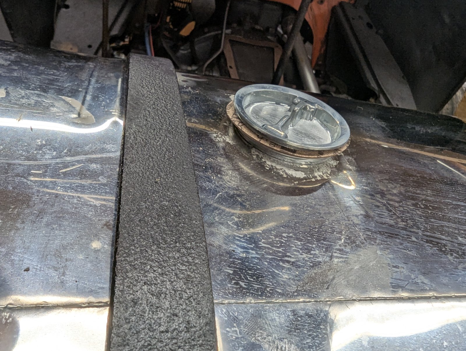

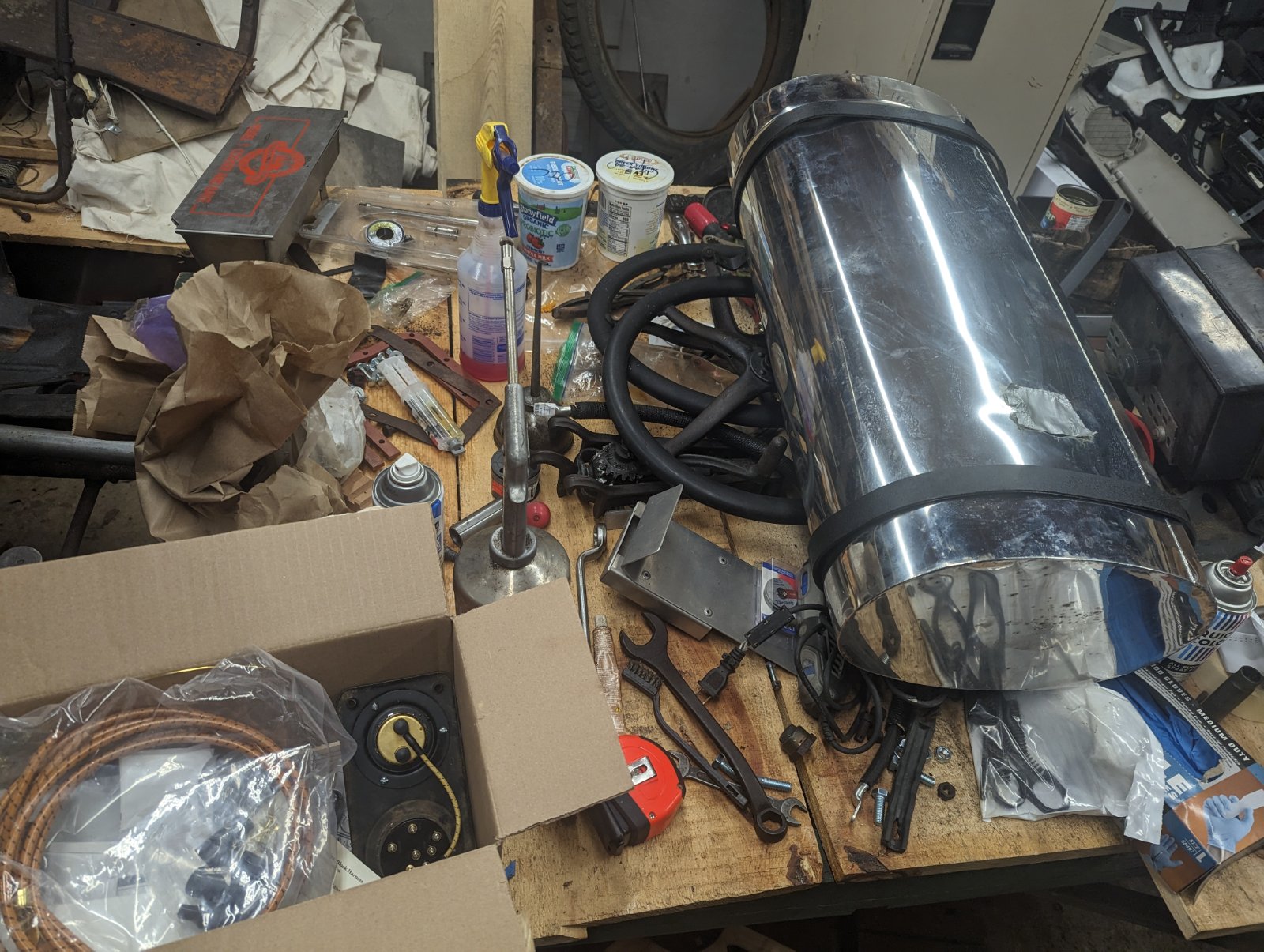

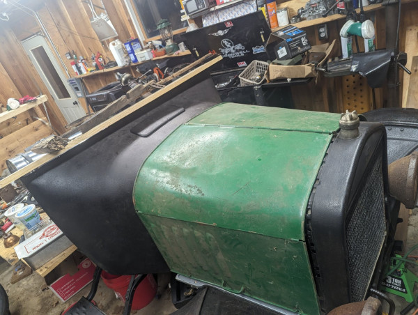

Good news, I picked up a hood and stainless steel tank from a fellow in Vermont. The hood will require a bit of tin knocking to fit, and one minor hinge weld, but should prove satisfactory.
The tank... Is going to require me moving beaucoup detritus out of the way.

I really liked that hood with the advertising on it.
Mike

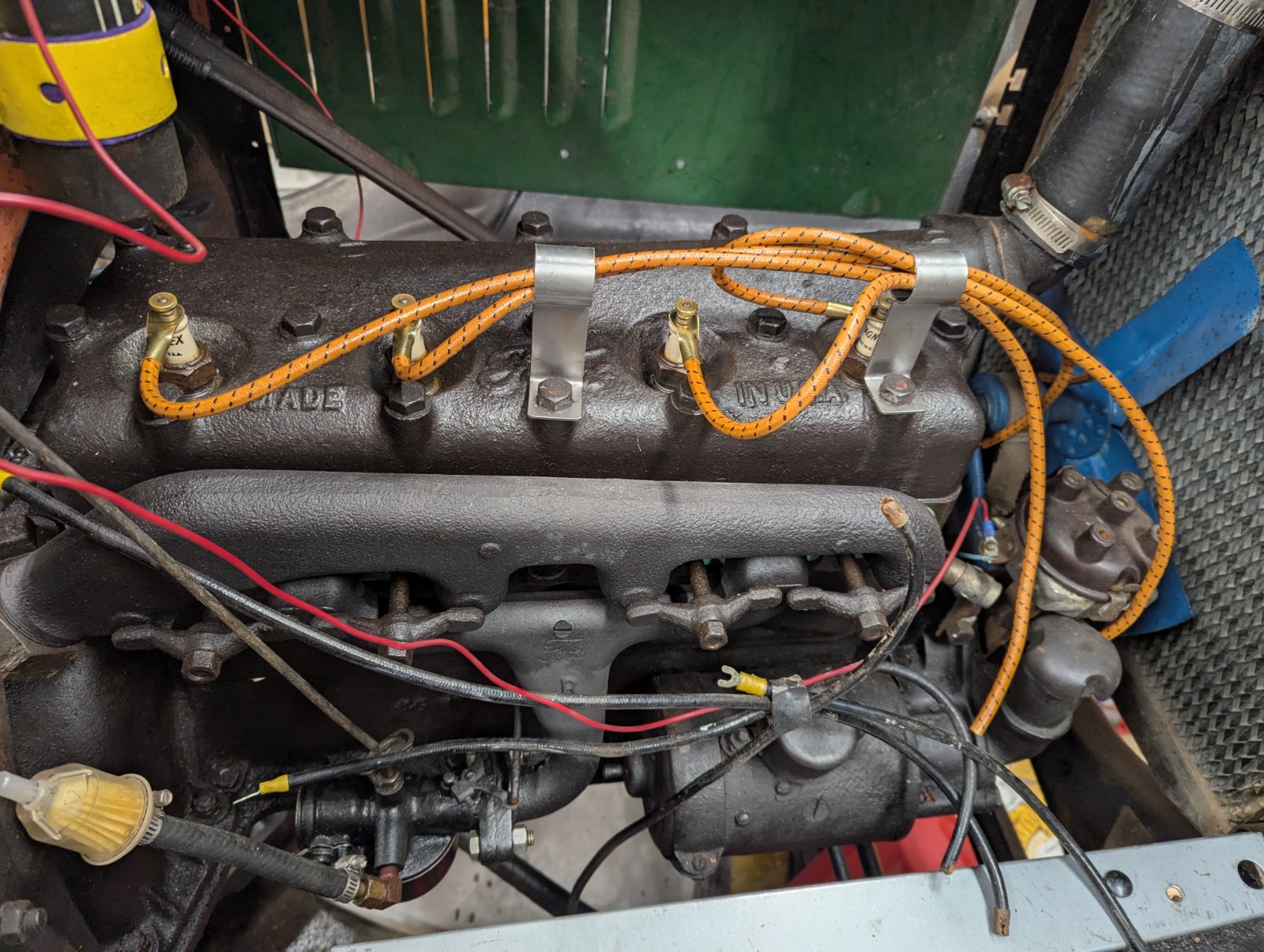

Post by Maineiac » Tue Nov 18, 2025 9:56 pm
Courtesy of Varmint here on the forums, I now have a fuel sediment bulb! By my untrained and amateur eye, I suspect it'll clean up nicely.
My collection of reference material is slowly growing as well. Picked up an original 1927 owners manual off marketplace locally.

36mike wrote:
Sat Nov 15, 2025 12:38 pm
Mike
It's available to a new home if you're interested. I'm building the truck as a personal vehicle, rather than a "work" truck. So the old work clothes clashed.

Post by Maineiac » Sun Nov 30, 2025 10:37 pm
Well, one step forward, two steps back, as such things go.
My original gas tank bands are too small for the stainless tank. I reckon I can splice a small band extension in easily enough..
On top of that, the new made gas cap from Langs is slightly oversized, and as of right now, I'm uncertain as to how best to measure and find the correct cap. Thoughts on this would be appreciated. Perhaps I ordered the wrong cap? Or the bung weldment is for a different model?
But on the plus side, new electrical components have arrived! Im particular, new (shiny) guts for the headlights, and new distributor cables. Going to paint the cable holders, and make a pair of anti chafing inserts to protect the new wires.
Also, as a minor score, found a set of pull-a-part champion Xs locally for a pretty reasonable price.
mtntee20
Posts: 705
First Name: Terry & Sharon
Last Name: Miller
Location: Westminster, CO
Re: My 24 TT project (Hello all!)
Post by mtntee20 » Sun Nov 30, 2025 11:18 pm
I'm not sure exactly how your tank sits. If it is like mine, "standard", you might fabricate some riser blocks to go between the frame and tank strap ends. Use longer bolts as necessary.
Good Luck
Posts: 8433
Post by TXGOAT2 » Mon Dec 01, 2025 9:19 am
Does the stainless tank have metric threads? I'd guess your fitment problems are related to the tank, not the T parts.

Post by Maineiac » Mon Dec 01, 2025 11:23 am
The sediment bulb screws in just fine, so it's not likely a metric/ standard problem. Unless of course, there's a thread pitch that's close to interchangeable with the bulbs NPT threads.
Posts: 7139
Post by Allan » Mon Dec 01, 2025 5:19 pm
The in-line fuel filter can be ditched with a new stainless steel tank. They are notorious for restricting flow on gravity feed systems like the T. Yours even appears to be fitted backwards to my eye. Usually the fuel is fed into the canister and then through the paper filter, before heading to the carby.
