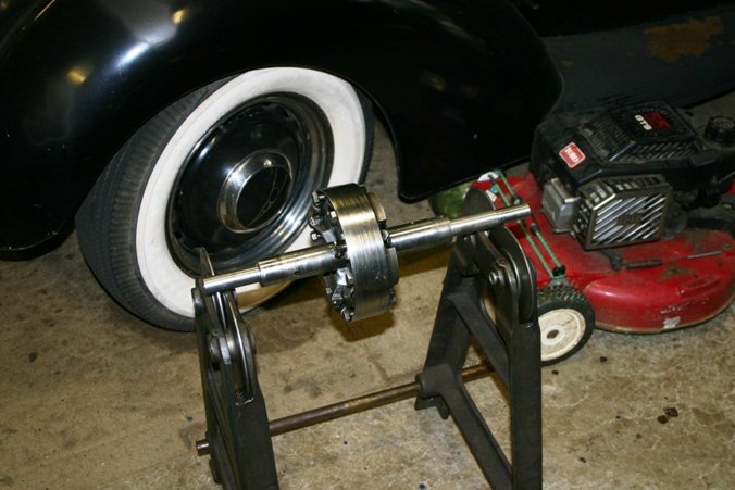

Here's my setup,
Mike
I noticed in Steve's picture (I'm assuming that is Bender's balancer) that there is one shaft and a couple of adpaters that slip on to the shaft for each different drum? Can to tell me what diameter the shaft is? I believe I should make those pieces, it may make my work easier. Mike

The balancer is Steve's but I have one much like it. To answer your question on balancing shafts I made one for each drum. I have found that finding the heavy side of the brake drum and drive plate and putting them 180 degrees out really helps in balancing them. I set up the brake/drum as a unit and then balance. Hope that helps.

Well..... I took a break for some lunch and while at the refrig, I grabbed a couple old regrig magnets and cut them up. They work pretty good as small balanceing weights. I tested the brake drum and drive plate. I find it amazing that my first choice of mating (probably the one I would have used in assembly) was the worst balance. Actually I found that at 180 degrees from this spot seems to be a spot were I will not have to remove any material.

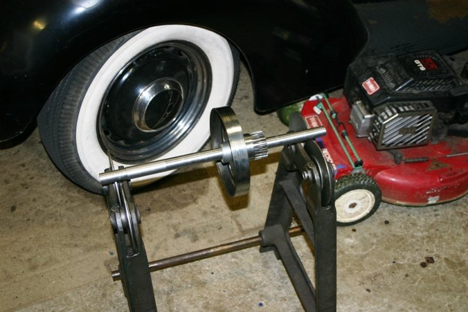

Well..... over the week end I had some time to make a shaft and a couple of donuts
Mike
Today, I found some time to first try these.
This should make balancing a lot easier. THanks for the helpMike
