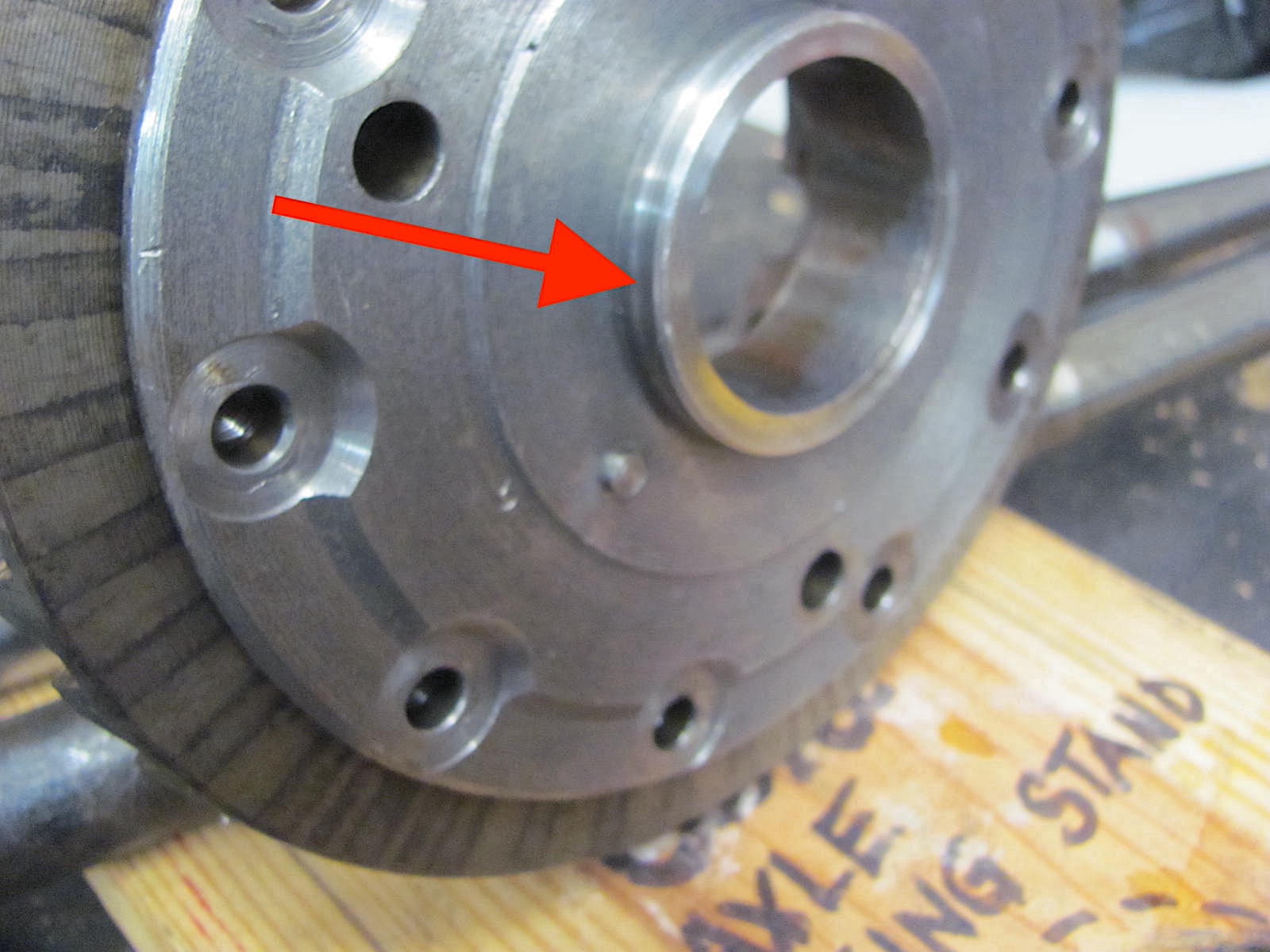

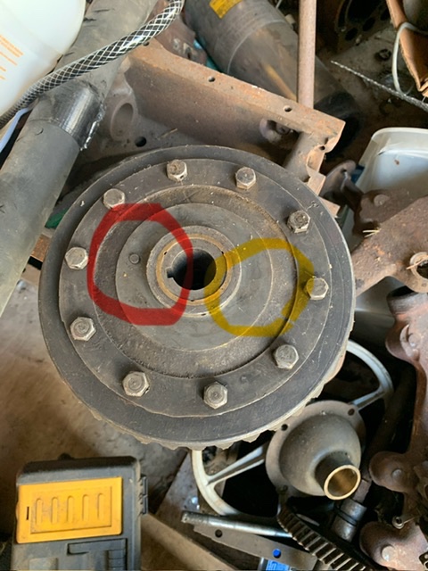

Looking at carriers I have. Most have grooves where the thrust plates have dropped down and worn a place. What does that hurt in the long run? I know why it happened, only one pin holding the plate. See red circle in picture.
What if you added a second pin across from it to hold th plate from more rubbing? See yellow circle in same picture.
Any comments? Dan

I see nothing wrong in adding a second pin.
That will keep the thrust washer from pivoting on the single pin, wearing into the carrier.
I dont see there being any more than minor wear in a well lubricated rear end. Where I have seen the most wear here is in a dry rear end from a trailer/hay wagon.
The dropping of the thrust washer is typically caused from a Babbitt thrust washer failure.
In a properly clearanced carrier that drop cant happen as the clearance is .005 & the pins are .062"+ proud of the surface.
- Posts: 4047
Re: Question about diff carriers?
Only thing that can concern is if the collar is grooved too deep or oblong from a loose thrust steel plate, might let a plate wiggle more if only the one factory pin.

Dan, I did that exact thing last winter when I rebuilt my rear axle on my Tudor. So far I have had no problems/issues with it. I also added a 1/8" pipe plug in the bottom to make it easier to drain lube when changing. I did drain and refill a couple of weeks ago, when I put it to bed for winter. I also took a look with my borescope going through the fill plug hole, and everything looked great. Not even any shavings in the bottom.Dan Hatch wrote: ↑Sat Nov 22, 2025 4:18 pmLooking at carriers I have. Most have grooves where the thrust plates have dropped down and worn a place. What does that hurt in the long run? I know why it happened, only one pin holding the plate. See red circle in picture.
Any comments? Dan

The reason for my question is it is getting harder to find carriers with out the usual wear groove. I have looked an about a dozen, all with different degrees of wear. Some are junk but others? As long as the wear is stopped from getting worse, you should be able to use the carrier.
On the other side of carrier could be harder to save. No where for a second pin. Unless it is a long pin? ???
Dan
Dan
