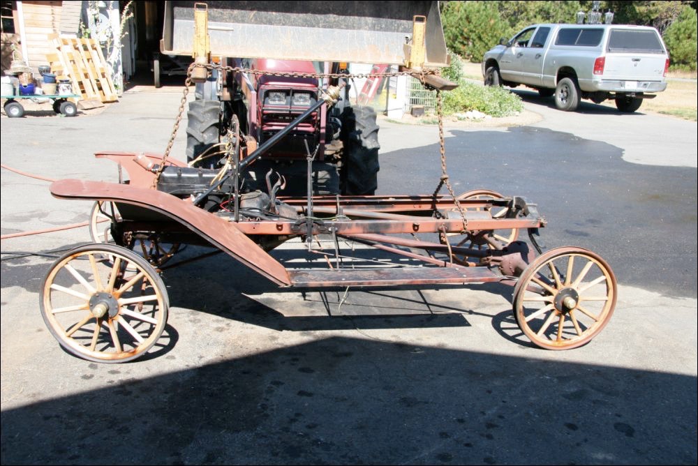

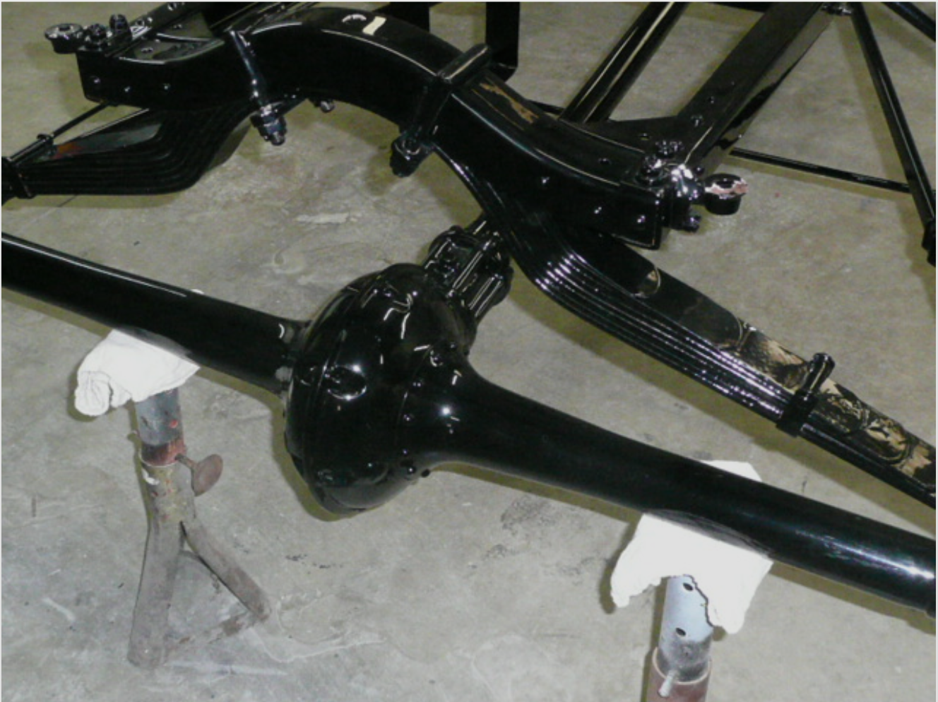

Andre,
There are a couple differences, between the 10-13 rear body brackets. The 1909-10 had the rear fender irons also attached to the rear body brackets they are called butterfly brackets. The 11-13 eliminated the need of the rear body brackets with the rear fender irons. The brackets are held on with three bolts two on the top and one on the side. The frames are different as well between a early frame 09-13 and a later frame after 13. These photos are of a 1911-12 frame.

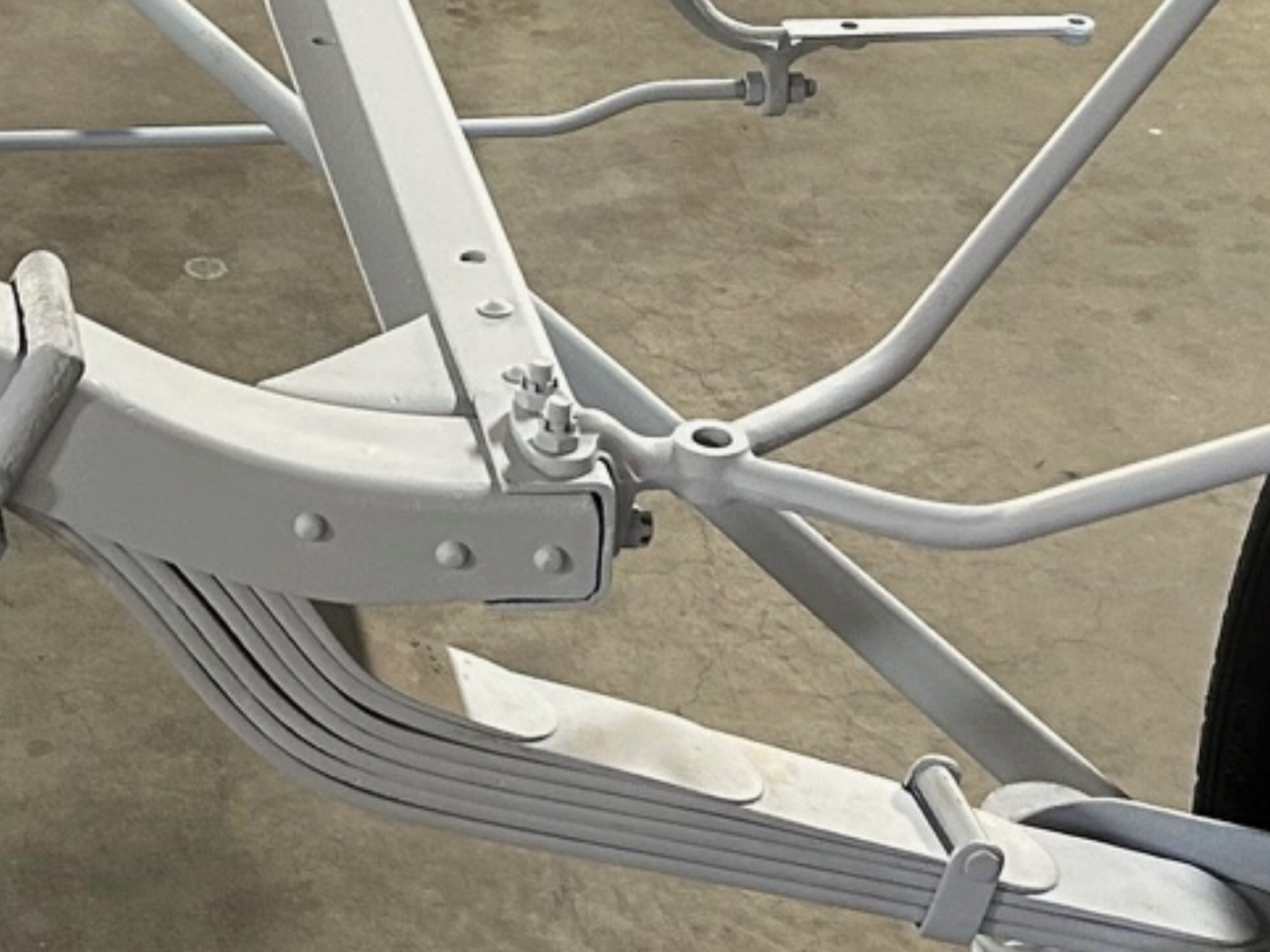

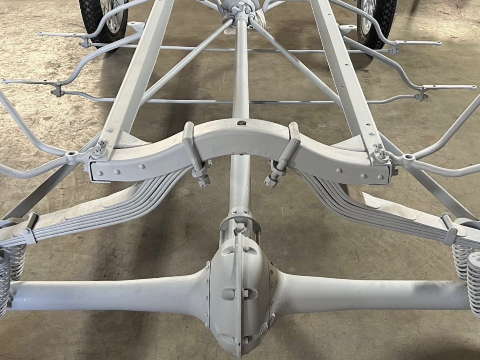

Re: 1910-1913 rear frame to body brackets.
Here you go.
