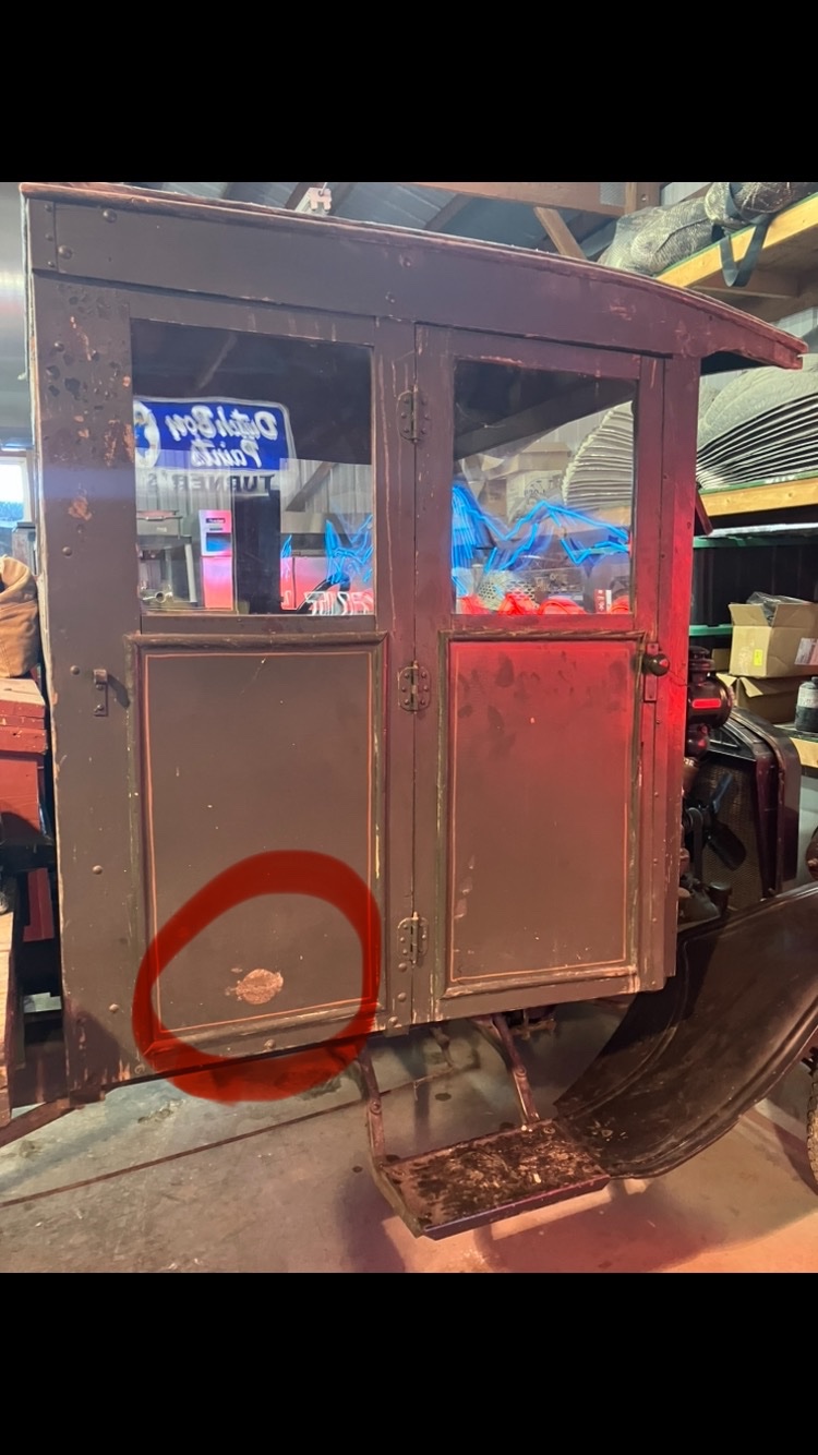

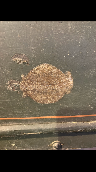

Helping a friend with a recent TT purchase. On both sides of the cab there looks like a decal that can’t be read. Didn’t know if this is a manufacture mark. Any ideas?
TT decal.

Perhaps a closer photo at a different angle.
Some other eyes may recognize it.

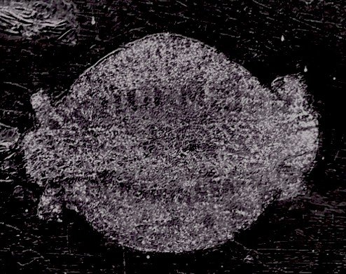

I believe it's a Schurmeier Wagon Company decal.
Part of "Schurmeier" and "Minneapolis" are discernable in the decal, at least to my eyes. Also, it is the right shape to be a Schurmeier decal.

Interesting! The little metal piece on the rear of the cab in your photo is for the original door handle to hook into and hold the door open I believe. Thanks to Tim Morsher I made mine for my Martin Parry wood cab. More photos please.

Ya sure, you betcha Erik ! That wood body is a Schurmeier from Minnesota by golly !
