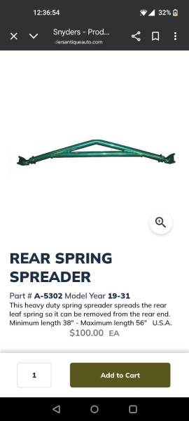

I need to do some more shenanigans on my rear suspension again. This time though I don't have access to the tools and shop i was able to borrow and hence can't replicate the janky definitely not OSHA approved method for spreading the springs. Would this model a spreader from Snyder's work on my 17 t? It's up there in my price range but I am no fabricator and I pay the price for lacking that skill.

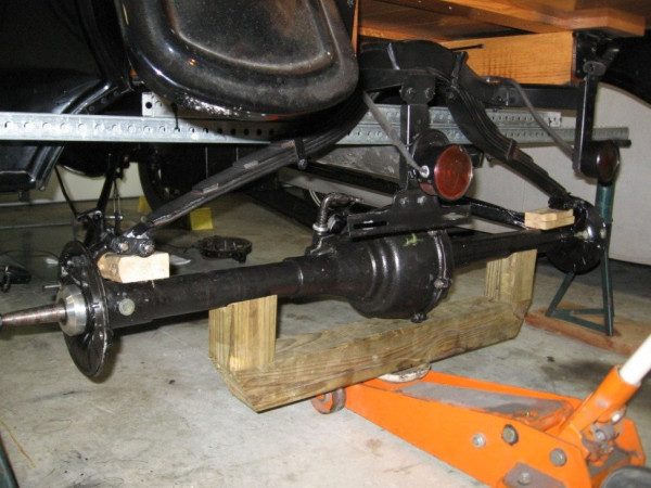

Using jacks & 2x4's under the leaf ends & Lifting against the body's weight will lengthen the spring to install the shackles.
My preferred method is to attach the perches first. Guide the perch stud into the backing plates. Pull home with the big castle nuts.

Use one jack on each side. (2 jacks) Or.......LittleTimmy52 wrote: ↑Mon Dec 01, 2025 1:32 pmWood might do it but I tried before and had no luck, though I think the blocks I used were too short. Side question, is that not bad for the axle all that weight?
I have A cradle I made that goes into my floor jack. Arms extend to either side to lift the axle by the end backing plate castings @ the same time.
Do not lift by the center pumpkin only.
Not that it wont work, but you will develop a gear lube leak & possibly bend the tubes.
