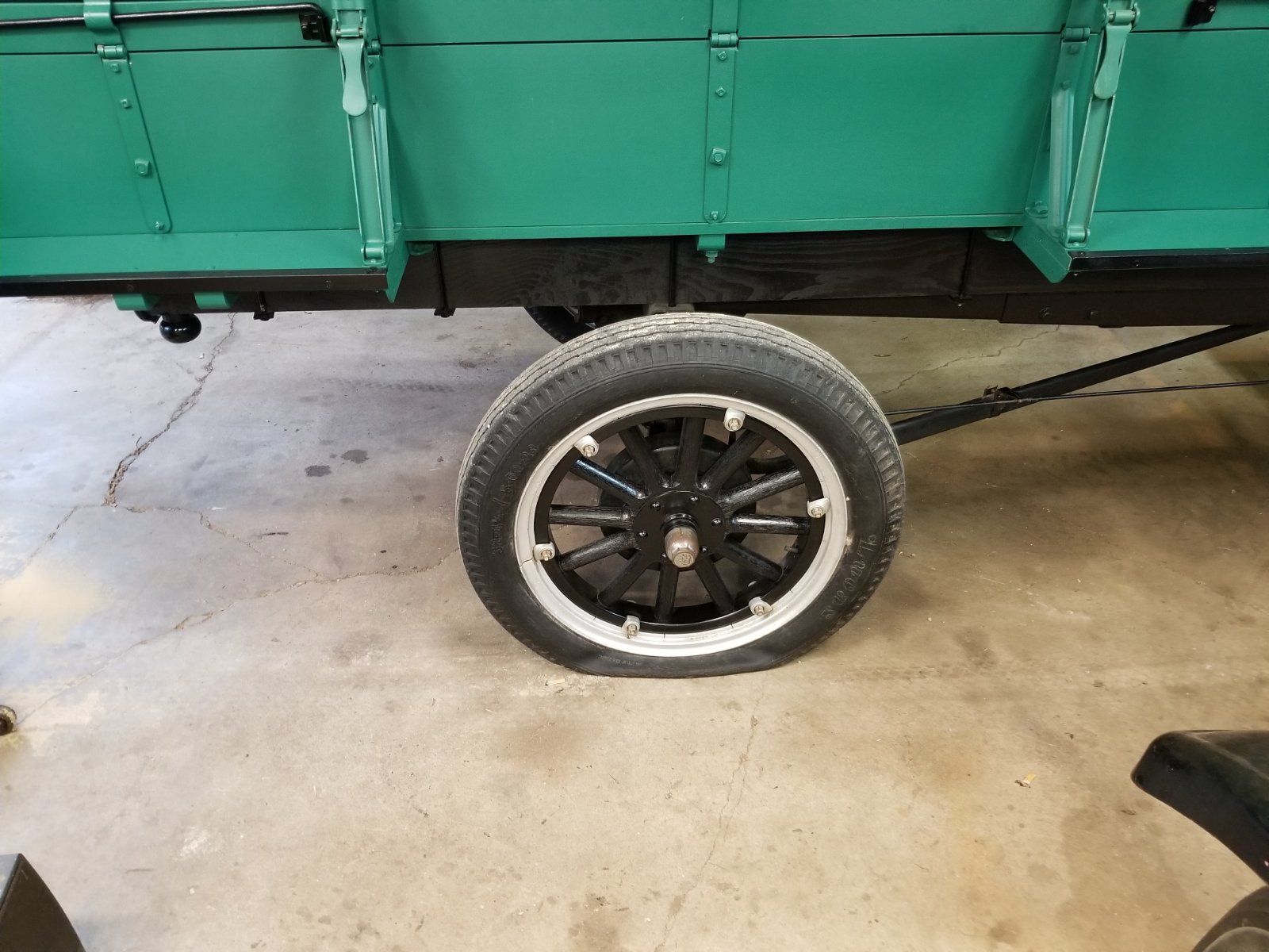

Friday was our 4th celebration in town. My TT was to haul girls from a local grocery to throw candy and lead the parade through town. Well at 5:30 am ready to leave for town for the day this is what I found.[attachment=0]20190705_061745.jpg[/attachment]
My plan was to patch the tube but when I put it in the horse tank I found it was leaking where the rubber meets the threads for the cap on valve stem. I am sure glad I got two 33x5 tubes from Hank in tin a see. One was a new universal made in Mexico. They were both powderd and in bags even tho one was used and had a patch. I fixed the tire and made the parade with no problem.

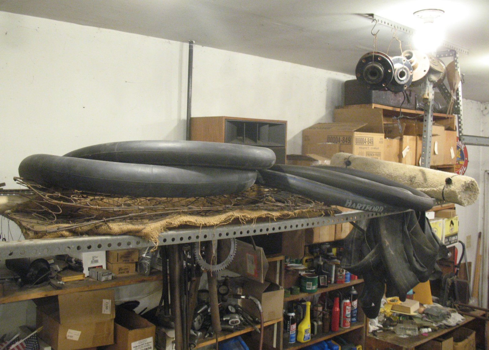

I put in just enough air to keep them round and put them on a high rack in my shop. Considering the exposure to light, maybe I should bag them.
