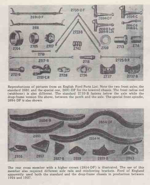

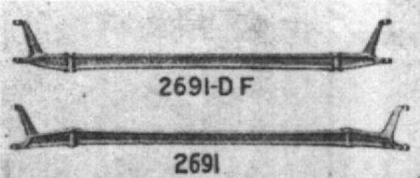

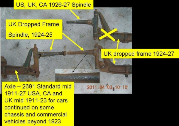

To lower a Model T it takes a higher (not lower) rear crossmember.
That is what was done (and more) on European Model T Fords
They were called "Drop Frame" cars and had a bunch of special parts.
See
https://www.mtfca.com/discus/messages/3 ... 75948.html
See

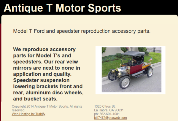

Antique Motor Sports out of La Habra CA used to sell polished aluminum disk wheels.
Looks like they have an eBay store now.
Maybe this is who you saw at the old swap meet?
https://www.antiquetmotorsports.com/products

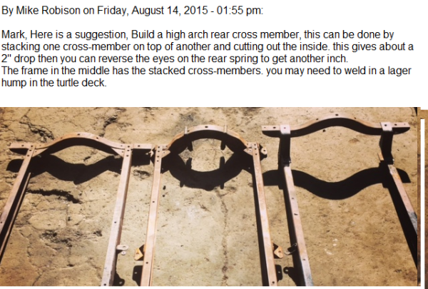

Here is some more info on Antique Motorsporst & link to their eBay sight https://www.ebay.com/str/antique-t-motor-sports-llcKBurket wrote: ↑Fri Dec 05, 2025 12:31 amAntique Motor Sports out of La Habra CA used to sell polished aluminum disk wheels.
It doesn't look like they have them available nor a rear cross memeber.
This image is from the link that KBurket provided https://www.antiquetmotorsports.com/products

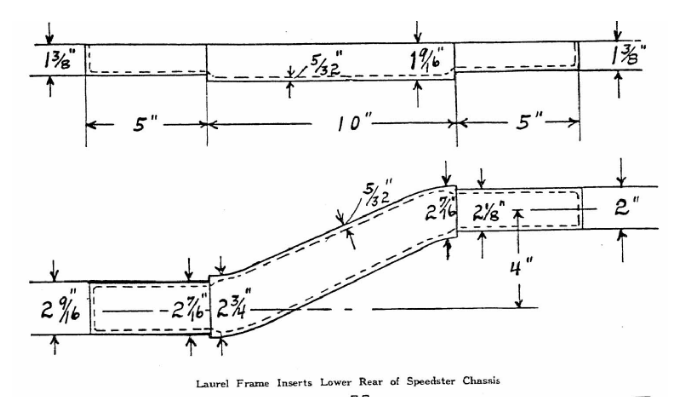

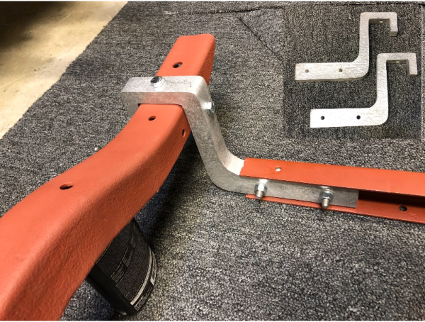

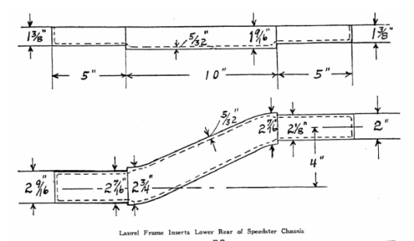

As I recall they offered the Z-Bracket individually or already welded to a rear cross member. The Z brackets are available but a different design (material & attachment method) There are several methods to drop the rear axle. The one that involves a high arch is to cut a section of one cross member, cutout a section of the one on the frame and then weld in the cutout piece (the middle example) I did see that there exists a high arch rear cross member see my next post
- Posts: 6487
Re: Rear crossmember question

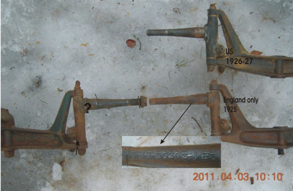

Here is a discussion about European chassis that were dropped via different front spindles & rear crossmember https://www.mtfca.com/discus/messages/3 ... 75948.html
For the front https://www.mtfca.com/discus/messages/1 ... 02362.html

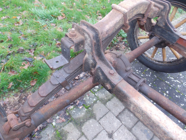

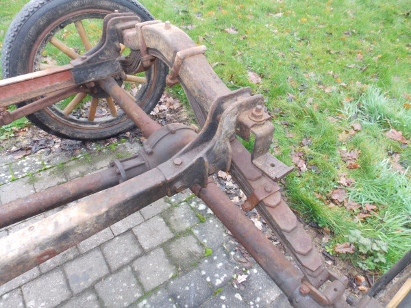

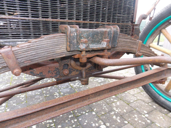

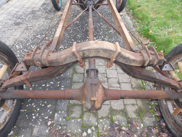

This I found three years ago.
Maybe an Idea to do it your self.
Andre
Belgium
Andre
Belgium

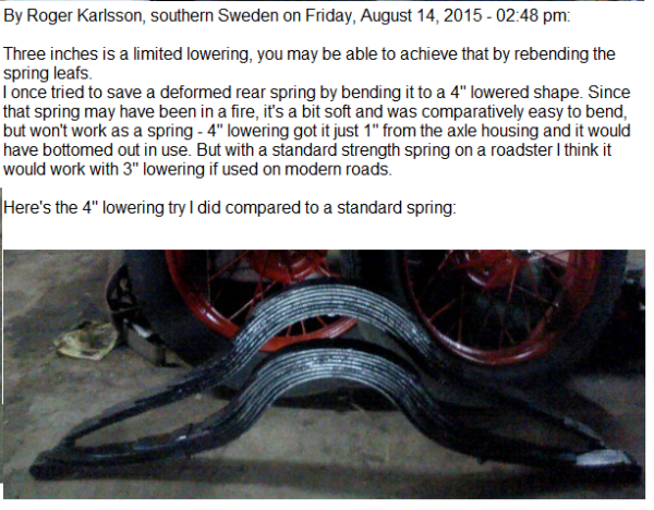

- Posts: 6487
Rear axle drop methods
Lots of ideas here
Lots of ideas here

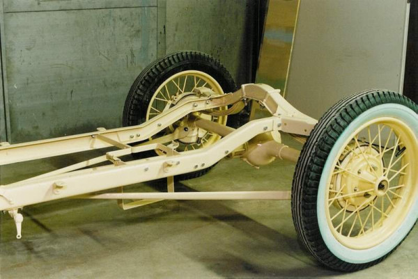

Wow! there are 12 leaves in that front spring!
- Posts: 8209
12 leaves looks crazy, but there may be method to the madness. If the leaves have low temper, or rate, it may take 12 of them to get the correct ride height. The stack of 12 leaves would have higher than normal inter-leaf friction, which can provide compression damping and some rebound damping if it is not excessive. Or maybe somebody wanted really high roll stiffness. Shocks would be a better solution, if only to save weight and allow easy adjustment. I wonder if they are stock Ford width... ?

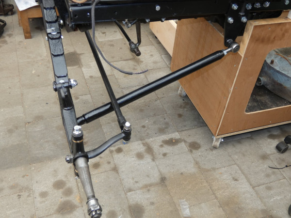

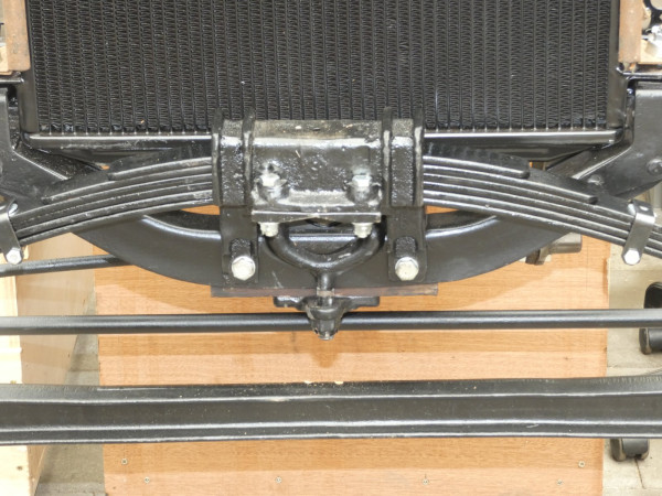

It was indeed not a stock wide front spring.
Here is what it became after rebuild.
The front spring was replaced by a spring assembly with original spring leafs.
On the photos you can count 6 leafs but one small leaf is hidden by the support on the top and one short leaf at the bottom is added to fill up the support.
Note also the way the suspension was stablilized with two adjustable rods to the back. The original V- rod was to short because of the new place of the front axle.
Andre
Belgium
