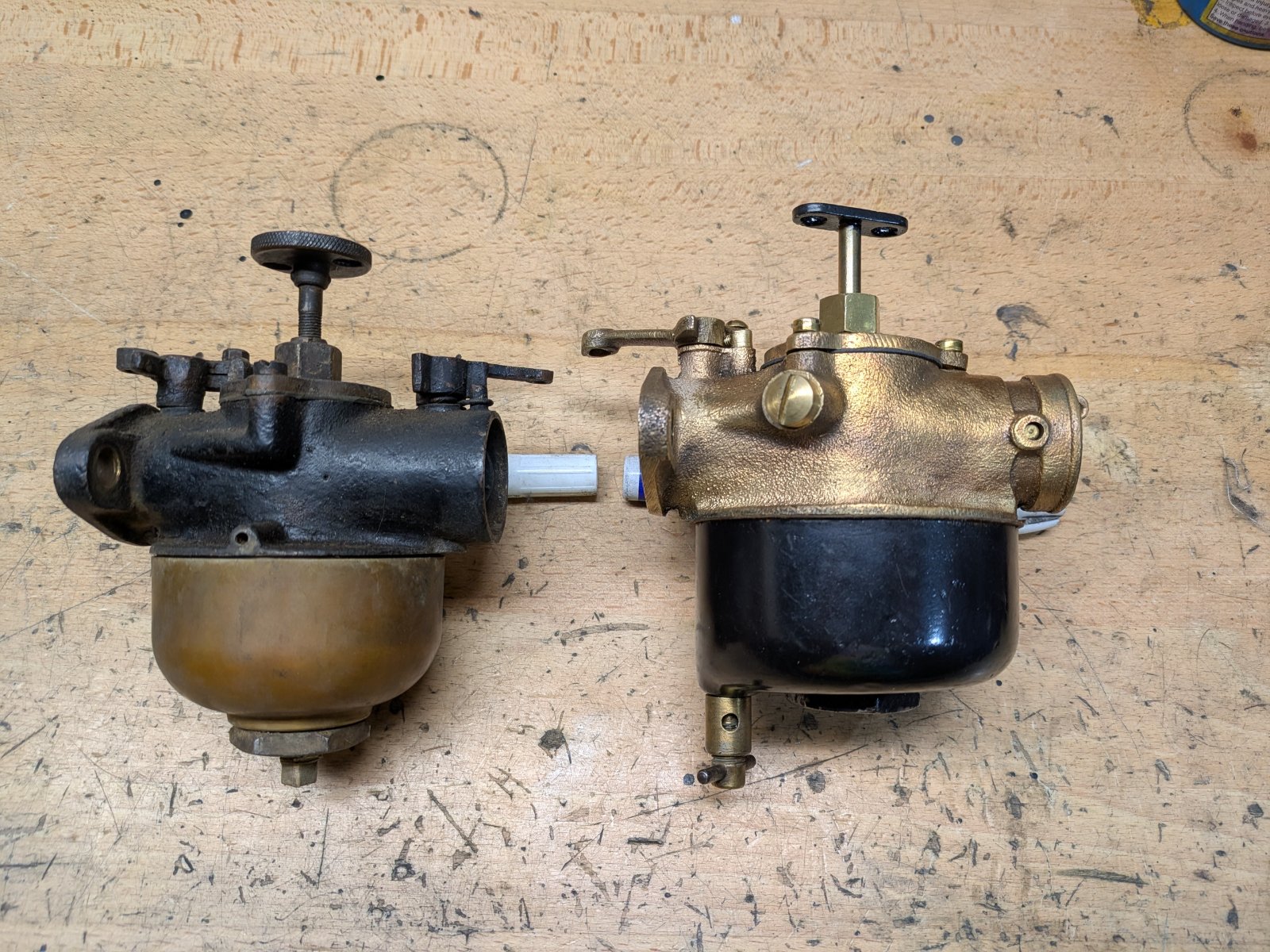

Did the Holley S that you removed have the body painted black? Stan's pictures of the S he rebuilt had no paint on the carb body, but the one that I have appears to have been painted black, or is REALLY tarnished.

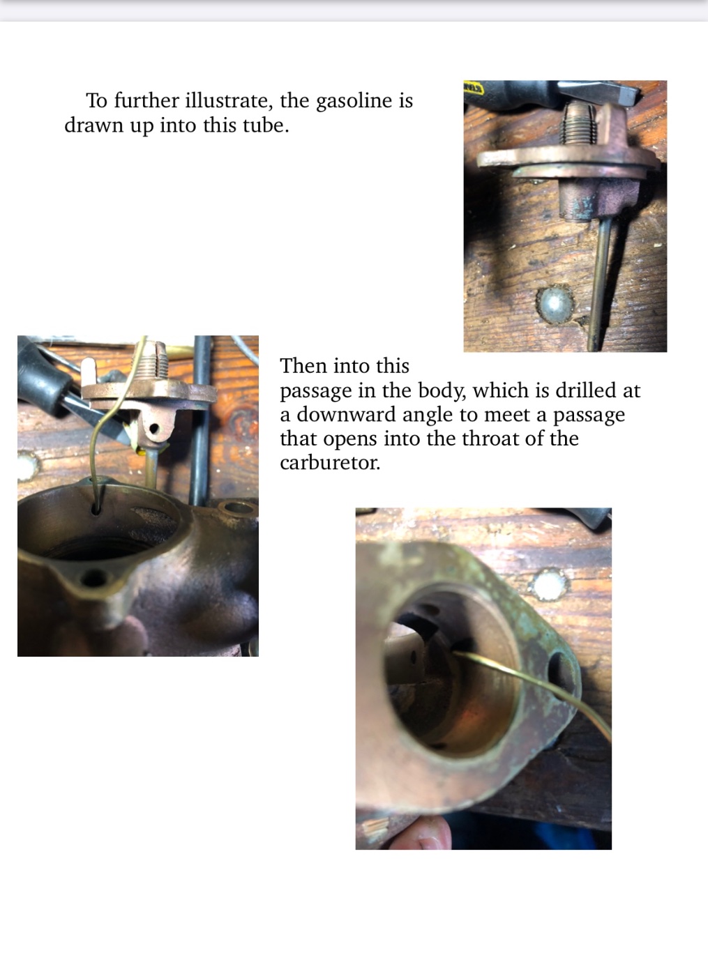

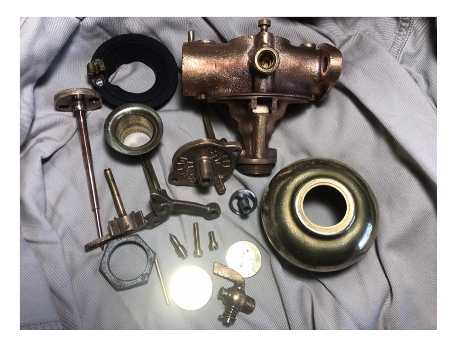

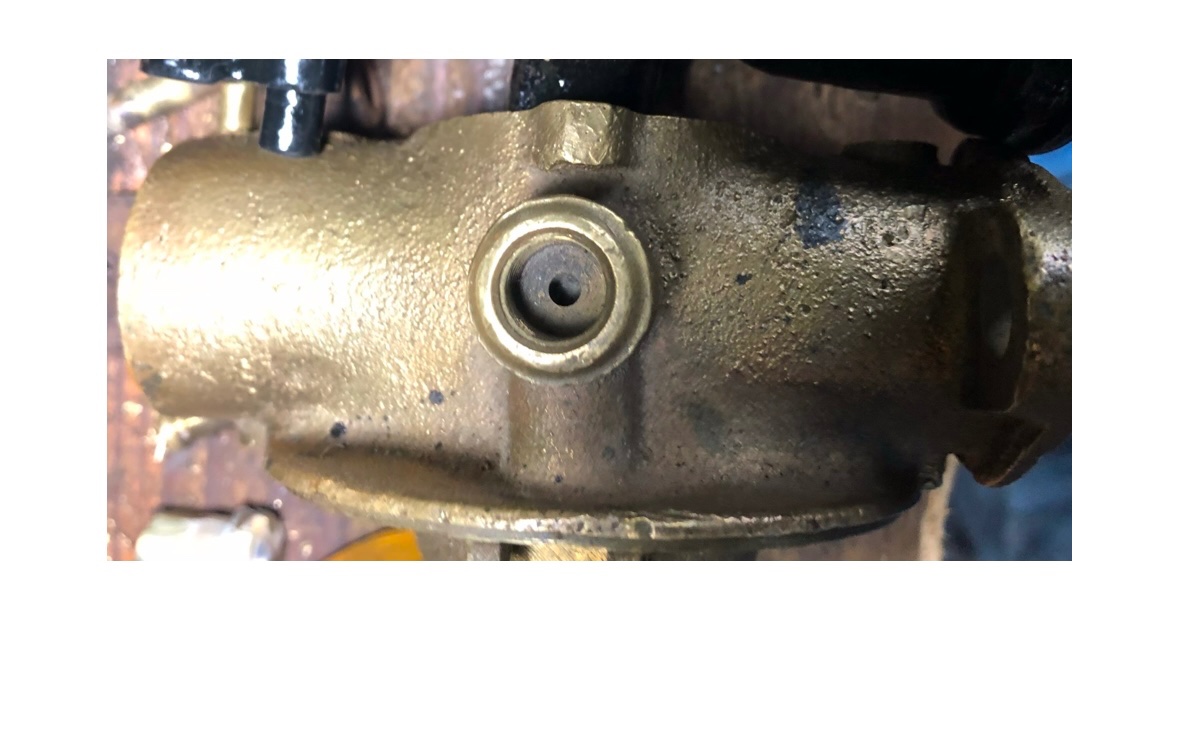

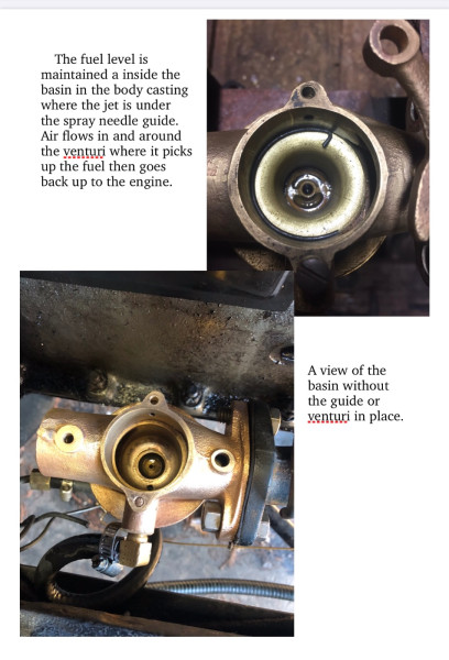

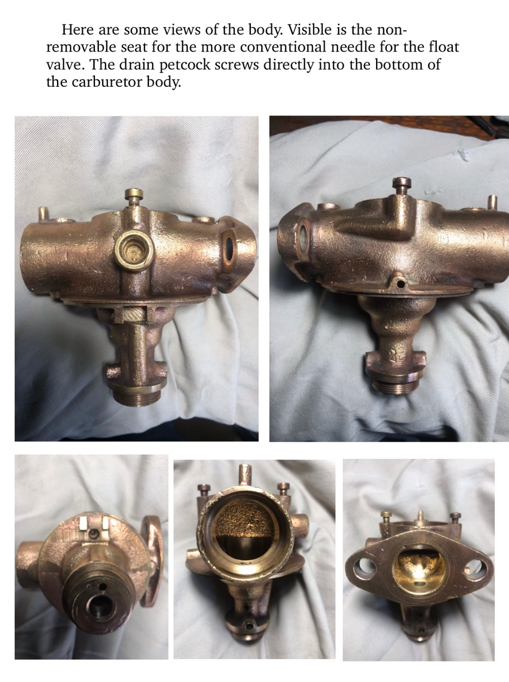

In my experience those run very well but don’t seem to have as much top end speed. I had one on my 14 several years ago when the temperature here in East Texas got down to -2 degrees and I went out and started it on mag and did a spin around the yard. I also have one on my 21 because I like them.
They are like a mini/simplified Holley H1 or G. The G is just an H1 with a simplified float valve which started with the S. The H1 and S both have non-removable seats but the S eliminates the complicated arrangement. The idle circuit operates through the same principle but without the little fitting screwed into the body and nut/flare on the pickup tube. You have to use the correct thickness of gasket so the holes in the body casting and mixing chamber cover align so the correct amount of gas can flow through. The H1 and G use the same pot metal venturi, whereas the S uses one of spun brass. The S however doesn’t have a removable spray nozzle. There is a pot metal guide for the spray needle which sometimes I’ve found broken. It’s not made to be removable, is swaged in, a new one can be made from a piece of tubing and a fender washer.
It probably was short lived because of the lower top end performance and it took an extra step and skilled worker to solder the idle pickup tube to the mixing chamber cover.
So they went back to the H1 design but kept the much improved float valve design for the G, plus made the seat for the needle replaceable.

What has anyone done about the float valve?
The one on my 13 has a Gross jet and we all know how that is.
I know it’s not spelled that way but this #*%# phone keeps changing it.
Another question, is there a metal float that can work in one? Dan

Thanks Corey for the information and pictures about the S carburetor! The Holley G carb that I replaced the S with is one that Corey refurbished.Corey Walker wrote: ↑Tue Dec 16, 2025 12:10 amIn my experience those run very well but don’t seem to have as much top end speed.

Neal, there was no indication the carb had been painted. Brass will tarnish near black in time though !

Dan, I have two “S” carbs, the one that was on my car has the original cork float with a failed gas tank liner coating, the other has a metal float, possibly from an NH, but it is bulkier than the original cork, and not a good fit. I don’t know if it was functional. A friend who lost his ‘13 in a fire gave it to me.
FWIW, the replacement float sold by vendors for the “G” carb is not a closed cell synthetic and will eventually “waterlog” and sink. I got a piece of actual closed cell material for float replacement from a fellow in Ohio who restores tractors. I’ll see if I can locate his contact information if nyone is interested.
