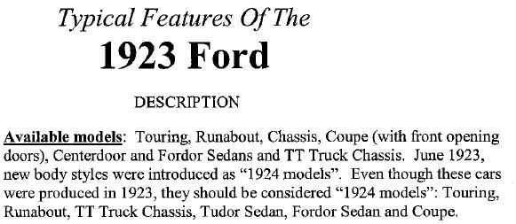

To be clear, 1923 was a mixed up year. Is your coupe a true 1923, basically the same as 1919 through 1922, suicide doors etc? Or the early production 1924 style which began production about June of 1923? This subject is as loaded with land mines as what oil should I use with model Ts! I have seen people want to get into fist fights (not kidding!) over this!
The 1924 style coupes all (standard from the factory) had the standard oval tank under the seat. Simple and easy.

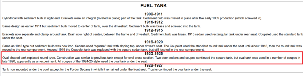

Perhaps some pictures of the under seat and trunk areas of your car can help find the clues to what type gas tank it is supposed to have?
Here is what the MTFCI judging standards have to say on the subject: Mike

From the MTFCA Encyclopedia by model year for the 1923
FUEL TANK: Elliptical, under the front seat. Mounting brackets clamped to the tank. Outlet was between the center and the right side, between the frame rails. The Sedan continued the square tank under the drivers seat. The Coupe used the sedan tank located in the turtle deck until the new bodies (1924 models), which used the standard oval tank under the seat.
General
1920-1925
Oval-shaped tank replaced round type. Construction was similar to previous tank except for oval cross-section. Two door sedans and coupes continued the square tank, but oval tank was used in a number of coupes in late 1920, apparently as an experiment. All coupes of the 1924-25 style used the oval tank under the seat.
