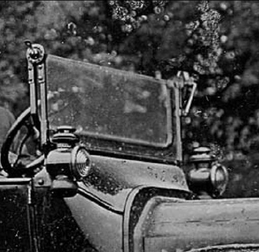

From the 1915 through part of the 1917 model year, the hinges are such that the edge of the two glass panes line up when the windshield is folded.
Refer to the photo below.

- equal half windshield.jpg (45.53 KiB) Viewed 370 times
