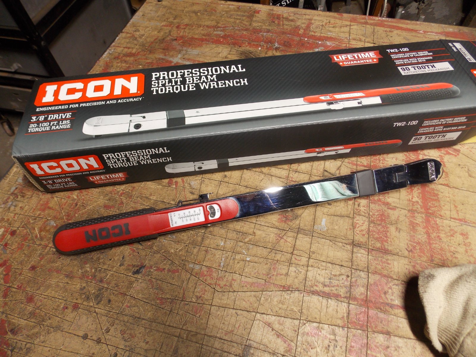

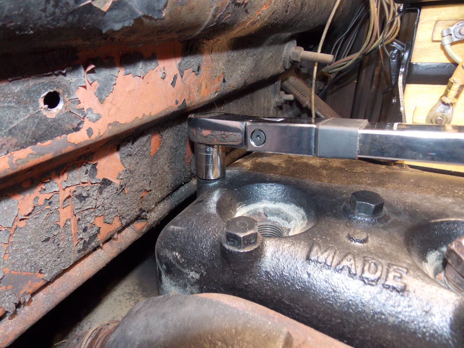

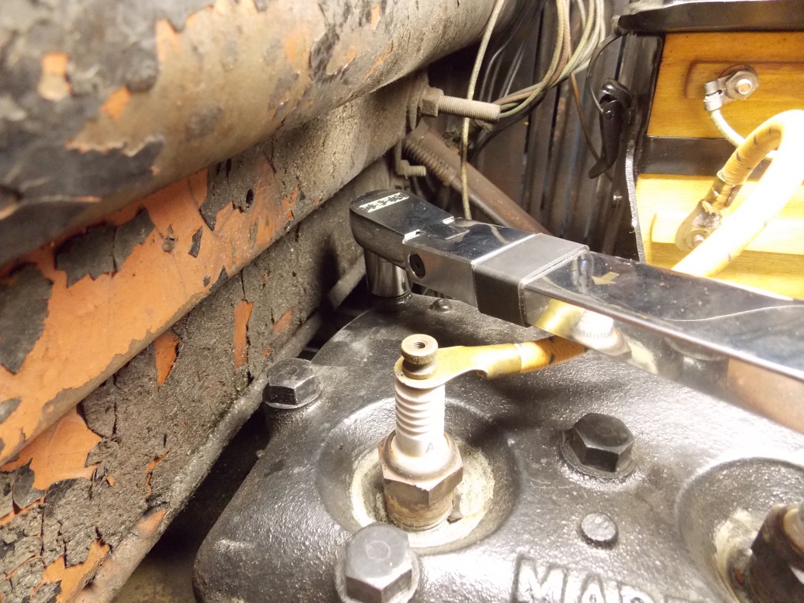

I had to replace the head gasket that failed on my 26 RPU, in replacing it there is always those two rear bolts you can't get a torque wrench on. Well I found a cure at Harbor Freight, a 3/8 drive torque wrench with a very thin flex type head. It gets in where I couldn't with any of my normal torque wrenches. I don't usually get tools from H.F. but in this case I made an exception. Hope this helps some of you out. Jim

A crows foot works too…, just saying.

Looks like harbor freight has finally copied my Snap On torque wrench.
Andy

Not digital it's analog so no batteries to go south when not in use. Plus my wife was happy to find something that I could actually use for Christmas. Jim

I have used crow foots.
My preferred way is to use my 1/2" proto torque wrench.
For the 2 rears, I use a long double box wrench on an already torqued bolt to calibrate my pull with that long wrench.
