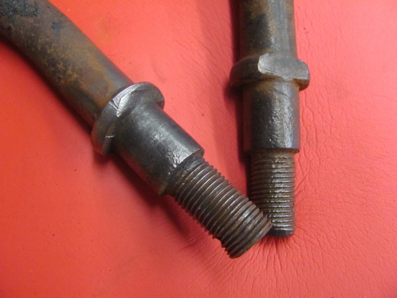

- Posts: 4040
Re: Headlight bucket socket orientation
Correct would be the side adjusting screw.
And the side version has the correct post, which is tapered on each side.

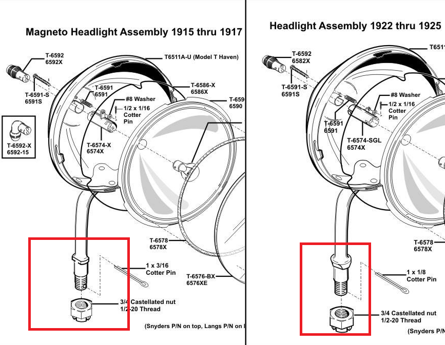

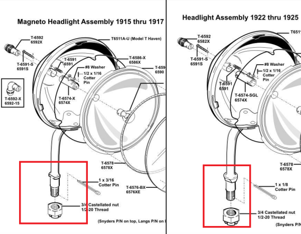

- Posts: 6531
The bucket with the adjusting screw above the bulb socket is for a 1915. I 'll be glad to trade you one with the screw at 9'oclock position (PM or eMail). I sent you an eMail.Cody Winters wrote: ↑Mon Dec 22, 2025 4:50 pmthat's what i thought. now i was tempted on sealing the other buckets hole up and redrilling
but i don't like modifying original parts so i'm going to hunt down an original bucket.
A true 1915 has the bulb base has contacts at different position, vertical in stead of horizontal & the end that fits into the fender bracket is different as well. The drawing for the 1922-25 headlight has the wire socket orientated incorrectly, contacts should be horizontal

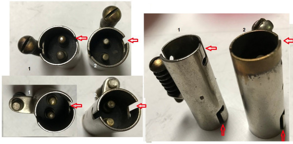

- Posts: 6531
