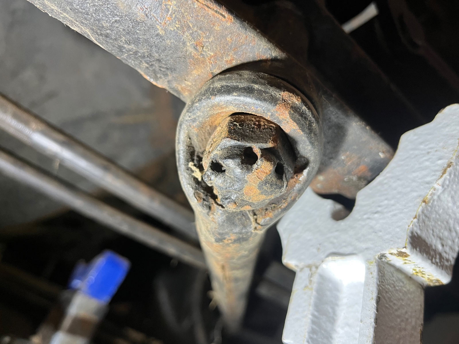

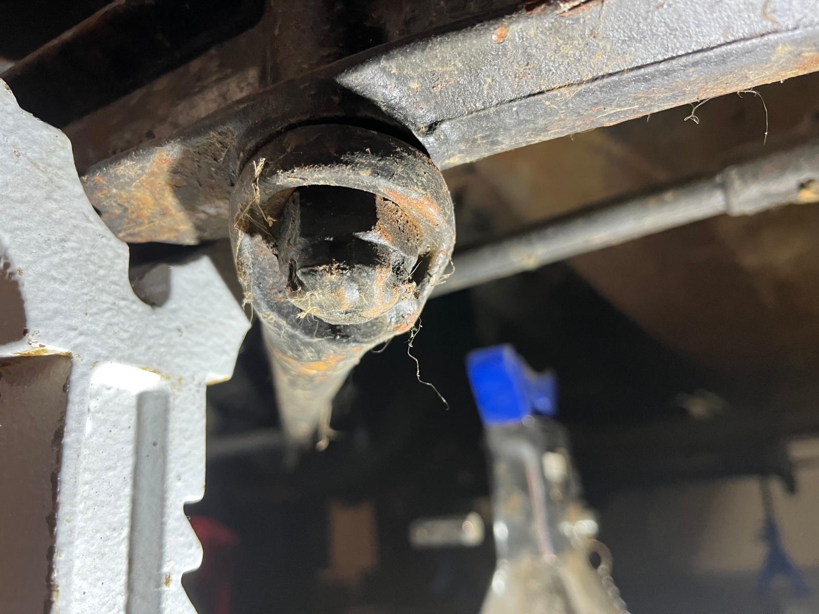

I’m getting ready to remove the front axle on my ‘17 touring, and I noticed that someone has welded the castle nuts on the bottom of the spring perches where they go through the radius arms. I can’t really get a wrench or a socket on it to try and break it loose. The only form of heat I could put on it would be a MAP gas torch, but I don’t know if that would do anything. Does anyone have any suggestions?

You could try carefully grinding the weld down flush with the top of the castle nut. Apply heat to the weld and try breaking the nut loose.

Question? Is that a secondary wishbone/brace with the above axle perches original for 1917? The studs were somewhat shorter on those perches than the ones on the later style perches. That brace (?) appears to be thicker than were many of the added braces. It may be that someone welded the nuts into place because the stud was too short to get a cotter pin in place. If that is the case, it may not take much grinding to eliminate enough of the weld for it to break free. Regardless, plan on destroying the nuts! No worries, they are a standard thread and easily replaced

Wayne is onto it. It looks like a later wishbone has been fitted to over-the-axle wishbone perches which were standard on a 1917 model. They have used a standard castle nut to attach it rather than the correct nut with a taper on be back to seat in a corresponding countersink in the under-axle wishbone eyes. So the nut was not engaged deep enough to be able to fit a cotter pin. You can grind on the nut as suggested. Don't go so far that you compromise the cotter pin hole in the perch. Once ground down, the remaining weld may just break free.
Alternatively, once you have tried the grinding trick, you might try splitting the nut. That too, may help crack the welds.

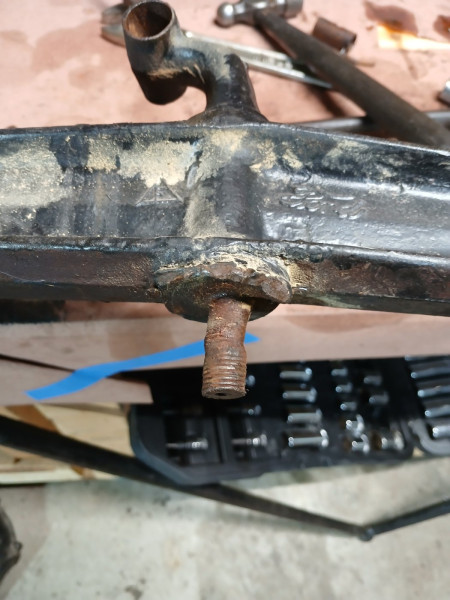

Don't be surprised if your spring perch looks like this. On my project T someone had welded the wishbone itself to the bottom of the axle. The weld had broken and the nuts were loose, so mine were easy to remove.
Whatever you do, good luck!
There's a reason someone welded those nuts to the bottom, and it is a good idea to fix it! The vendors sell very nice spring perches for $60. Money well spent in my book. The front axle and wishbone take a lot of sudden hits from bumps in the road.
