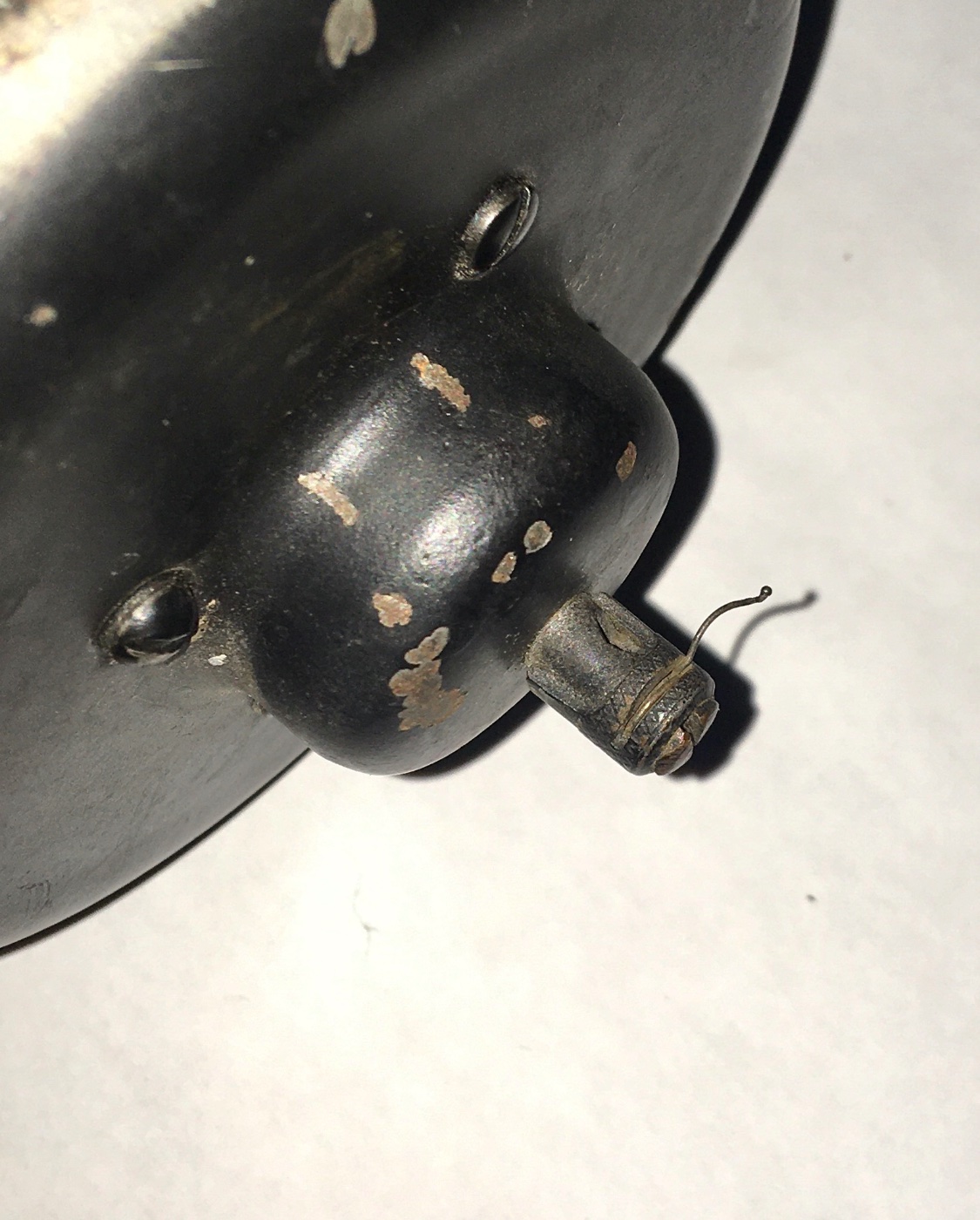

Looking to familiarize myself with the Model T generator. Picked this one up off the classifieds and was wondering what the piece sticking out the back is used for. Looks like a quick way to add a ground but I am guessing. iam sure someone will know on here.

it is a failed spring in the oiler. It used to make the oiler spring shut. Now all it does is risk poking a hole in your finger.

It all becomes clear! I kept looking at pictures but noticed some had them and some didn’t. Was this an improved design? Or the opposite

When generators are rebuilt, standard practice is to fit modern sealed bearings and the oiler is no longer necessary, A set screw can be used to plug the hole, or the oiler can be retained for looks.

I had a feeling and This makes sense. I see vendors sell them listed for all years.
