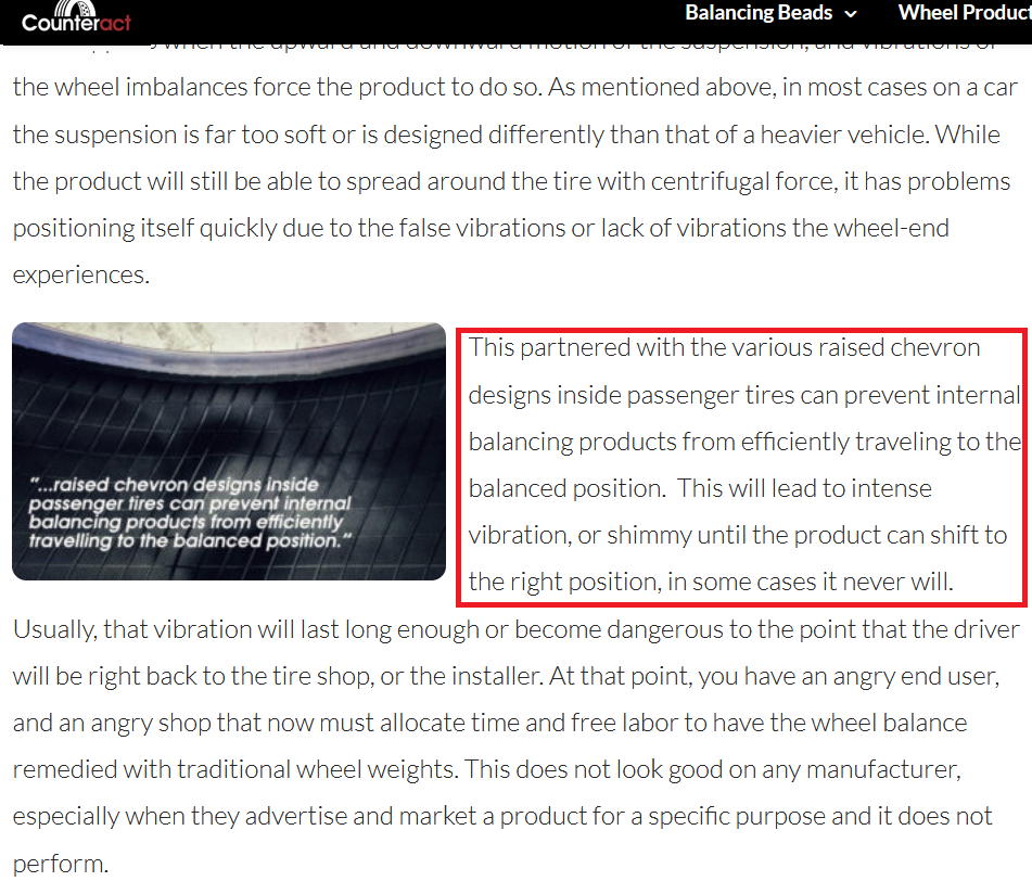

One source does not recommend balance beads for typical modern passenger car tires, citing the irregular inside surface of such tires. That ought not be a problem with any tube type tire.

Honestly I'm with Allan and Shrshot as in I don't believe the hype. First off if you're installing new tires you should definitely drive them first as any balancing might not be necessary. I class beads right up there with the Marvel Mystery guys. They'll swear it does this and that (usually it was Grand Pop talking), but there's no proof that it does anything except thin the oil already in the engine or blows smoke out the tail pipe if dumped in the fuel tank. Beads are the same thing to me. They settle to the bottom when stopped and HAVE to throw any balancing off when starting. They simply have too. Nothing else is possible. I've been in the trade for decades and spin balanced hundreds of tires and came across 2 odd situations where the tire couldn't be balanced. One was full of water (probably the remains of a sealant) and the other was full of minute rubber like beads. We thought at the time the beads were caused by rubber flaking off the inside of the tire and picking up more bits of rubber as they spun inside the tire. Like a snowball rolling down a hill getting larger as it goes. I now believe they were actually these beads. These 2 tires COULD NOT be spun balanced until they were broken down and the debris removed. They then balanced perfectly. Some of Brents explanations are oddly fascinating by the way. What I'm reading here is the usual "I spend my dough and I'm sticking by it".
- Posts: 8665
Re: Balancing beads
My experience with semi-liquid tire sealants in tube-type tires is generally poor. I've found it useful in ATV-type tubeless tires, although it seems to lose effectiveness in about a year. I've used it with good results in LT tubeless tires that are worn to 30% of the tread or less. These tires often develop slow leaks, and with the cost of having them patched being so high, using the goop is usually the better choice. It also seems to lose effectiveness in about a year, and prolonged wet weather may allow leaks to re-develop.
It seems from what I've read that balance beads must be used as directed, and that they work best in larger diameter, tube-type tires, such as are found on many pre-WWII cars, and HD oversized pickup and OTR truck tires.

I know the physics of balancing and how it applies to balance beads and the theory of how they work. I am NOT a tire professional nor an expert in Balance Bead applications, and given that the factors involved have changed, the specifics of what went wrong in your application are beyond any certain analysis at this point.
However, I can research and read Manufacturer's charts and I find the following: per multiple sources, for that size tire/rim a 1/2 ton truck would typically require 4 oz of beads and a 1 ton truck would typically require 6 oz of beads. Given this, it would seem that despite advice you received or retail packaging label, you may actually have been a little short on weight. Any other reason for your trouble would only be speculation on my part.
I would assume that the disparate amount of weight called out (4 vs 6 oz) is related to the tuning of the suspension relative to the weight of the vehicle and the stiffness of the assembly - meaning that the stiffer the rotor assembly (tire/suspension) the higher the natural frequency of the rotor and thus the higher speed necessary to attain 180 degree offset of oscillation to mass unbalance. Whether or not a little more beads would have worked for you throughout a lower speed range or not, I don't pretend to know, but the amount you did put in appears to fall below recommended standards.
Now, here is a little bit of speculation: in balancing, the best balance is attained via 2-plane balancing which is why sometimes weights are placed both on the inside and outside of a wheel...beads on the other hand, will automatically compensate at Critical Speed. Perhaps one of your wheels has/had a very small amount of runout which is fully compensated for with tire weights yet required a significant amount of centrifugal force (40MPH) to allow the beads to compensate for the runout...OK, enough with the speculation...
Hopefully this will be of some use to you - or since this is a past-tense situation for you, hopefully will be of value to someone else in the future

In reading the manufactures site there is a disclaimer. So that may have an issue with the Cooper Tires
The also indicate the amount by tire size and truck weight from this chart https://counteractbalancing.com/wp-cont ... -truck.pdf
