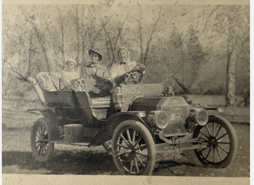

This looks like a fairly early Model T.
Any comments?
Early Model T - Photo

Based on the bills on the front fenders, no windshield, and no top I say late 1909
1910's had tops and windshields standard.
Although the top and windshield are easily removed.
Early 1909's had no bill, late 1909's had a front fender bill
Kinda blurry so hard to see details.
The people seem very happy with the car!

That 4 inch firewall riser suggests it is an early 1910 Model Year or Late 1909 Calendar Year.

This photo shows the 1910 or a little later firewall riser.
