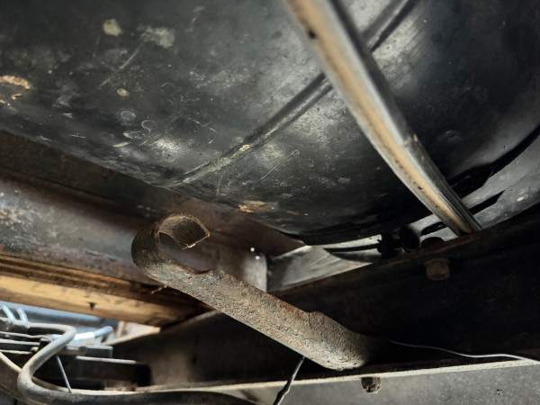

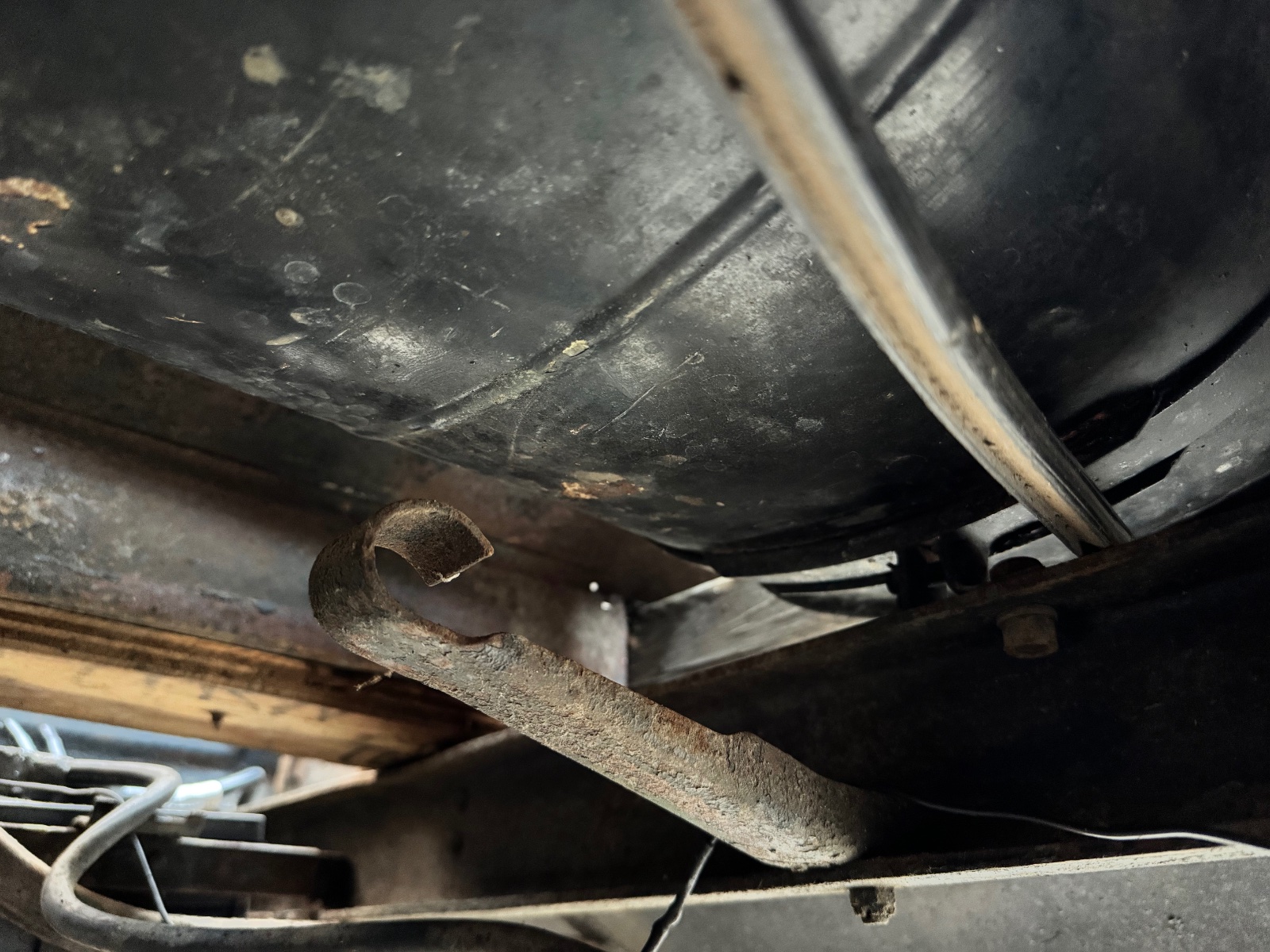

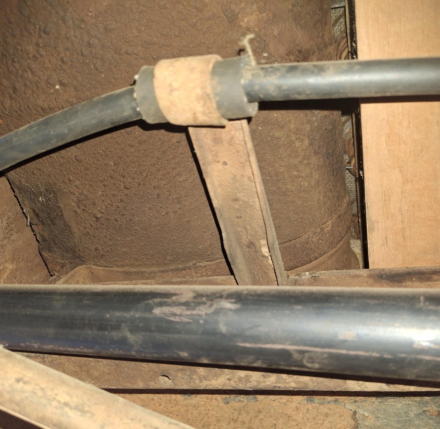

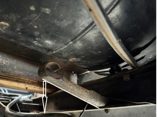

Howdy. New to me ‘25 touring (motor 12,3xx,xxx) from Texas.
Crawlin around underneath trying to knock 100 years of grease and grime I came across the attached bracket riveted to the drivers side frame underneath the gas tank, pretty sturdy, with a C cup hook on the end of about an inch in diameter. Too small for drivetrain or exhaust, too big for e-brake or lines.
Anyone know what it’s for? Hang groceries under the car? Carrier for javelins? It’s got a lot of accessories such as hassler shocks, electric windshield wiper, oil pan wings and a fan belt tensioner, so someone was really into modifications some time in its history.
Just curious.

Post by Marshall V. Daut » Sat Dec 27, 2025 6:50 pm
Battery cable guide/support from the battery to the starter switch.
Marshall
Posts: 8673
Re: Uplifting support but for what?
Post by TXGOAT2 » Sat Dec 27, 2025 6:51 pm
Starter cable support?
Marshall V. Daut
Posts: 246
Joined: Wed Jan 16, 2019 2:57 pm
First Name: Marshall
Last Name: Daut
Location: Davenport, Iowa
Post by Marshall V. Daut » Sat Dec 27, 2025 7:00 pm
This is the grommet you need to surround the battery cable inside that bracket: https://www.snydersantiqueauto.com/prod ... &cat=41825
The cable should be #00 gauge, NOT a skinny 12 volt cable from your local auto parts store. Buy the correct thickness and length cable from a Model T parts supplier or else your starter's operation will be affected.
Marshall

See y’all are so smart! I don’t care what other people say about you! Y’all know your T parts!
Awfully serious support for a battery cable. That was an aftermarket accessory? My ‘20 doesn’t have that.
Will Rice
Houston Tx
‘20 Touring Pickup
‘25 Touring
Post by speedytinc » Sat Dec 27, 2025 8:34 pm
Wrice123 wrote:
Sat Dec 27, 2025 8:28 pm
Not an accessory. Your 20 should atleast have a hole in the frame where it mounted to.
Post by Pep C Strebeck » Sat Dec 27, 2025 8:41 pm
It did not show up until the 1922 Parts List, T-5047-C, Battery to Switch Cable Support, factory not aftermarket. Correct for your '25 and will fit the 1920 as well.

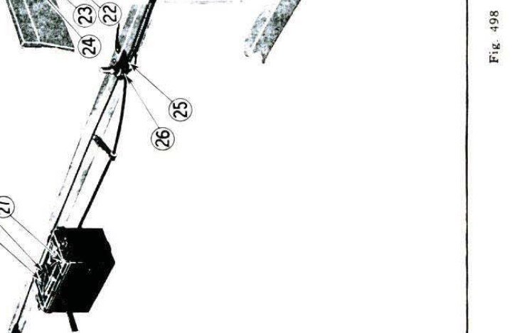

Mike Silbert
Posts: 366
Joined: Sat Feb 08, 2020 11:30 pm
Last Name: Silbert
Location: Sykesville Md
Post by Mike Silbert » Sat Dec 27, 2025 9:20 pm

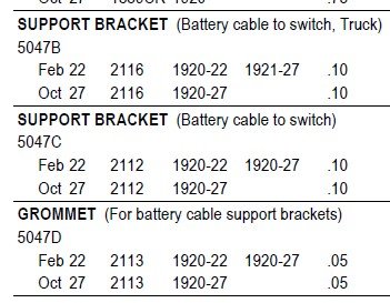

The parts books list the support bracket as first being used in 1920
I guess the 1919 cars had none?
Screenshot 2025-12-27 211738.jpg (28 KiB) Viewed 1163 times

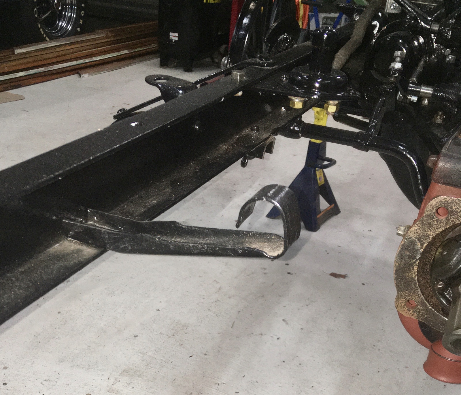

It"s just mounted up side down or is that a LHD thing?
Posts: 5604
Post by RajoRacer » Sun Dec 28, 2025 12:33 pm
No, it's mounted correctly.

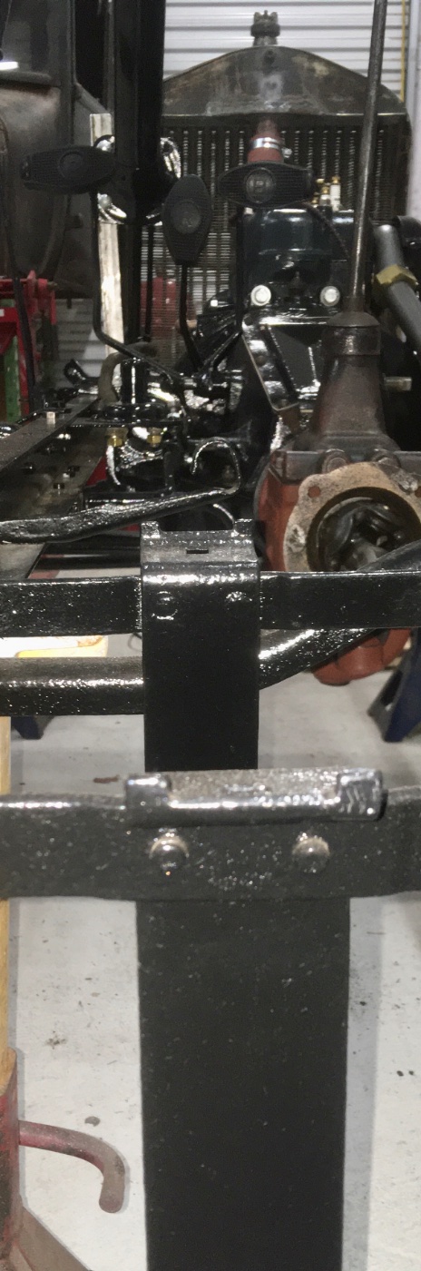

varmint
Posts: 1046
First Name: Vernon
Last Name: Worley
Location: New Orleans, LA
Post by varmint » Sun Dec 28, 2025 1:22 pm
This is my '26.
Vern (Vieux Carre)
Posts: 6599
Post by TRDxB2 » Sun Dec 28, 2025 1:31 pm

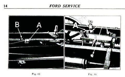

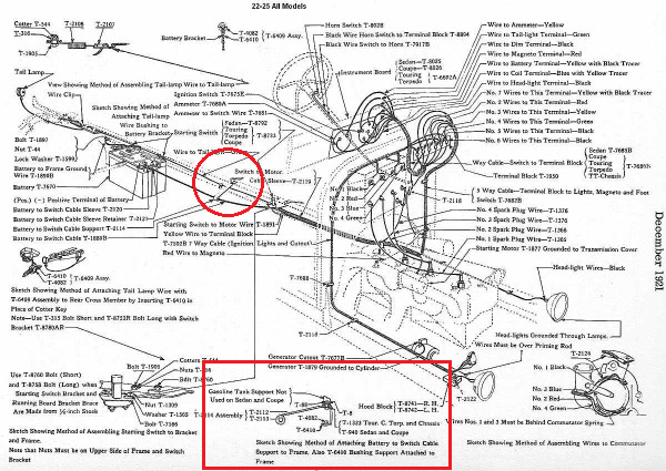

Per the diagram: the support is mounted upside down.
Posts: 5568
Last Name: Gregush
Location: Portland Or
Post by Mark Gregush » Sun Dec 28, 2025 2:18 pm
Pretty sure the one on my 1925 which looks to never have been off the car is mounted like the one in the top photo with the curved part up which matches Fig 45 in the December 1925 Ford Service. Which makes more sense as vibration could shake the grommet out with it facing down. Fig 60 wiring diagram shows it the same way.

1926 facing up it lines up with the top of the battery and the starter switch.

Mike Silbert
Posts: 366
Last Name: Silbert
Post by Mike Silbert » Sun Dec 28, 2025 7:11 pm
Interesting,
The Ford Service and Repair Manual (2009 Digital Reprint) shows it 2 pictures.
They seen to show it on the bottom rail U pointed up.

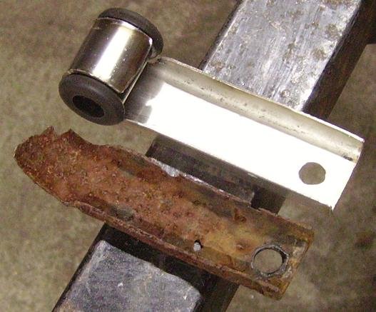

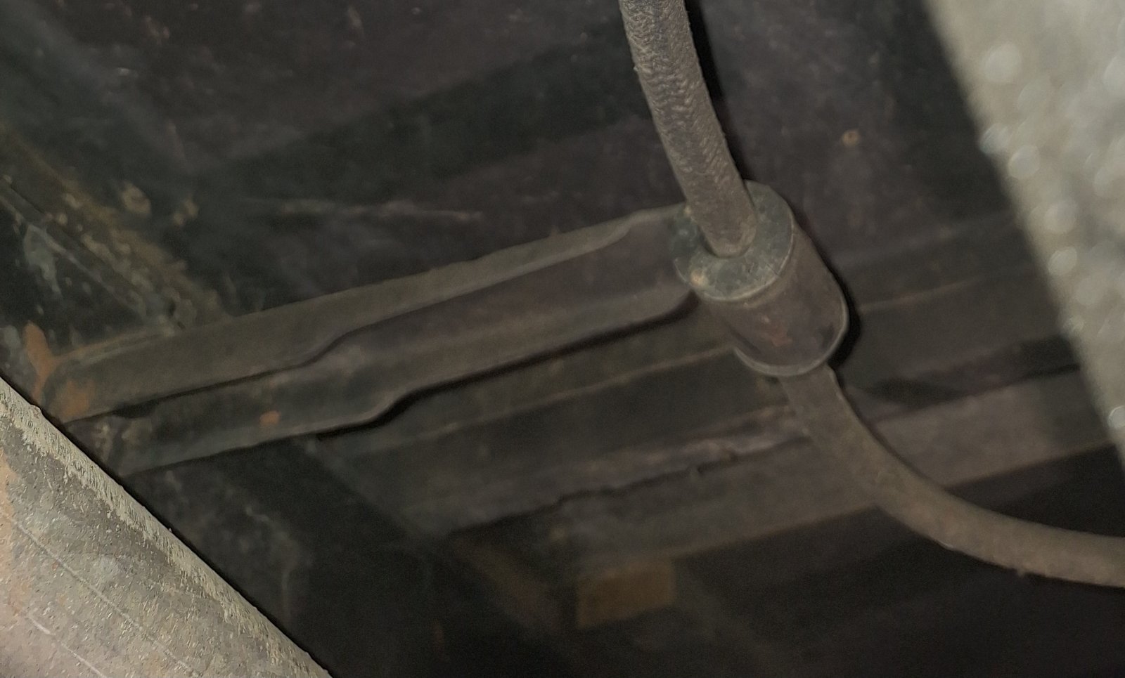

Posts: 7309
Post by Allan » Sun Dec 28, 2025 11:20 pm

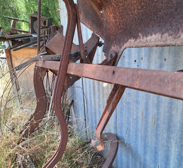

Well, that upside down mounting of the battery cable support bracket is a LHD thing. I checked a number of RHD frames and my cars, and our brackets are mounted to the underside of the top flange, u channel down, on the right frame rail utilising one of the fuel tank bolts to mount it. Bear in mind that our cable is much longer that LHD parts. Mounting it on the top of the rail, U channel down, lifts it well clear of the exhaust pipe as it heads to the frame mounted foot starter switch, which is close to the exhaust pipe.
The original rubber grommets have flanges on each end, and the curved end of the bracket is clamped around it, so there is no chance of it slipping out.
Posts: 7309
Post by Allan » Sun Dec 28, 2025 11:27 pm
Forgot the photos! :(
