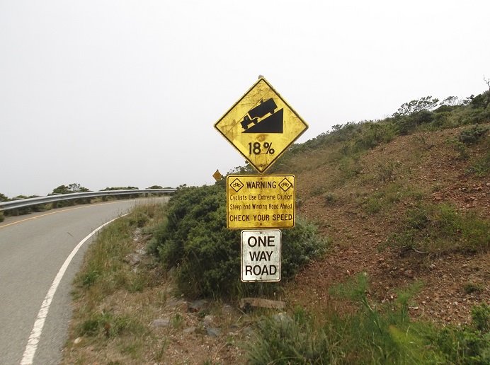

Is this 18% grade too steep for a Model T to descend down?
Hello fellow Model T-ers,
As many of you know, I am hosting the Golden Gate and Alexander Valley Tours June 3rd thru June 10th.
I would like to include a one mile loop segment out over the Golden Gate and Pacific Ocean but am uncertain as to whether or not an 18% grade is too steep for a Model T to descend down. This thin stretch of asphalt road has been recently repaved and is in perfect condition. Only parts of it have an 18% grade. However, it is only one car wide (a one-way single lane) with zero shoulder on either side. Our tour would be the only traffic here on this Monday afternoon. You can view this beautifully spectacular, yet ominous, stretch on Youtube. Here's the link. https://www.youtube.com/watch?v=SjRCHcmmfos
What do you guys think? Should I include it on my 'day one' Marin Headlands tour or avoid it altogether and choose a flatter way?
I would appreciate your advice.

No, it’s not too steep for a Model T to decend - but awfully, awfully dangerous. A fairly new Model T owner/driver would probably incorrectly use the brake band and emergency brake lever. You might see a lot of cracked brake drums from the Kevlar guys. On the other hand, you could instruct all in the morning drivers meeting to use low pedal to decend. And, conversely, low Ruckstell and low Warford.

I've not seen this grade first hand, but am inclined to err on the safe side and not do it.
Here's my reasoning:
1. You are not making the decision for yourself, you are making the decision for many individuals. You probably don't know the detail condition or equipment of every car, nor do you know the precise skill level of every driver. Even if a typical T with a typical driver can do it, you are working to the lowest common denominator.
2. Group dynamics will come into play here. If one person says, "No sweat", then his friend will be reluctant to pass on the same task. And once half of the group decides to do it, the other half will go ahead and give it a go just through peer pressure. As the tour leader, you don't want to put people in these difficult positions.
3. As you said, it's a single lane, one way road. If somebody breaks down on the grade, he will block any further transit. How are you going to get the trouble trailer into position to load the disabled T, and worse yet, how are you going to safely load it ?

Loss of brakes should be no issue. That guardrail will slow any runaway down.
- Posts: 4694
Re: Is this 18% grade too steep for a Model T to descend down?
There are several pedestrian crossings along the course. I didn't see any pedestrians, however, if someone walks out in front of a T expecting the T to stop for them, they could get run over.
If the cars have auxiliary transmissions and external brakes, it might be safe, but on a tour, there are probably some T;s with stock transmissions and brakes.
A problem is that if one T gets out of control, it could affect others in front of it.
I personally would not recommend it for a tour.

There will also be bicycles on the road, there are always bicycles there and they will probably want to go faster than the T drivers. We passed on these types when we put together our national tour. As already mentioned, you can't account for everyone's experience level. If you have to ask you probably know the answer.

Your comments against including this segment on the tour make sense. I sort of knew this already. I just hate to have everyone miss such a spectacularly
beautiful stretch of road. Nevertheless, as you all have confirmed, and for various reasons, it would be too risky (perhaps even stupid) to include an 18% one-way grade, with no shoulders, on a Model T tour. C'est la vie.
Thank you very much for your advice.

I know that section of roadway fairly well, and I'm here to tell you that the bicyclists are an absolute menace. Not because of their hobby (sport?), but because of their attitude. They will weave in and out, pull in front of you and generally disregard safety almost arrogantly. Combine that with an antique car whose braking ability is marginal at best, and you have a recipe for disaster.
It's a beautiful stretch of scenic highway, but consider another route if possible.

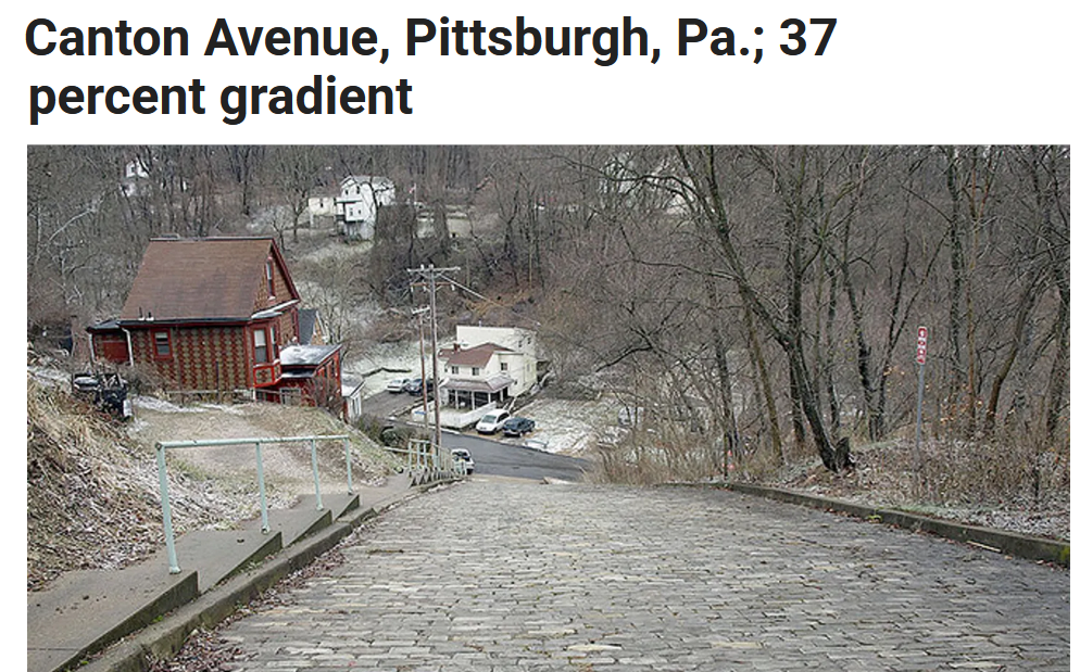

Here's the steepest road in the USA. I don't think I could walk down or up it, good thing there are stairs but interrupted with someone's driveway.
