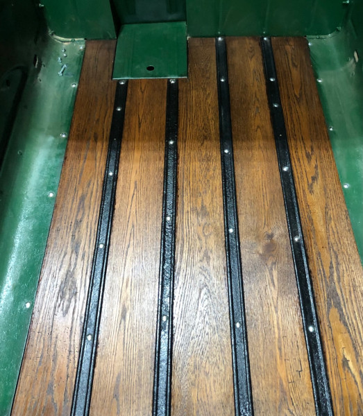

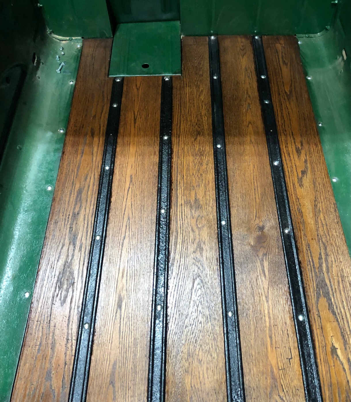

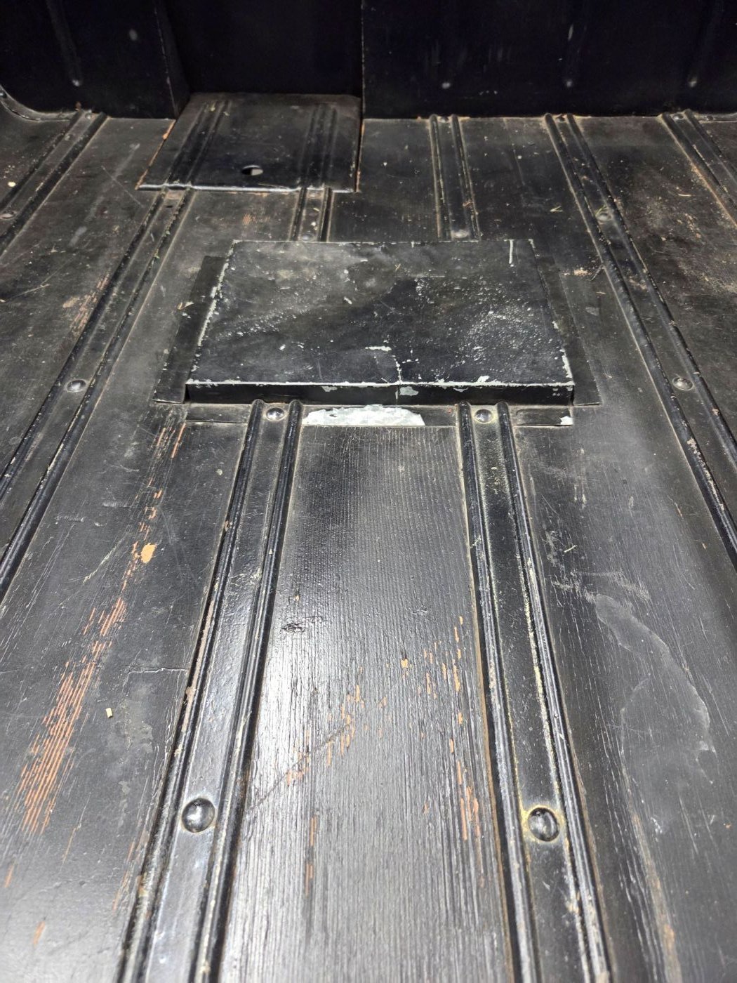

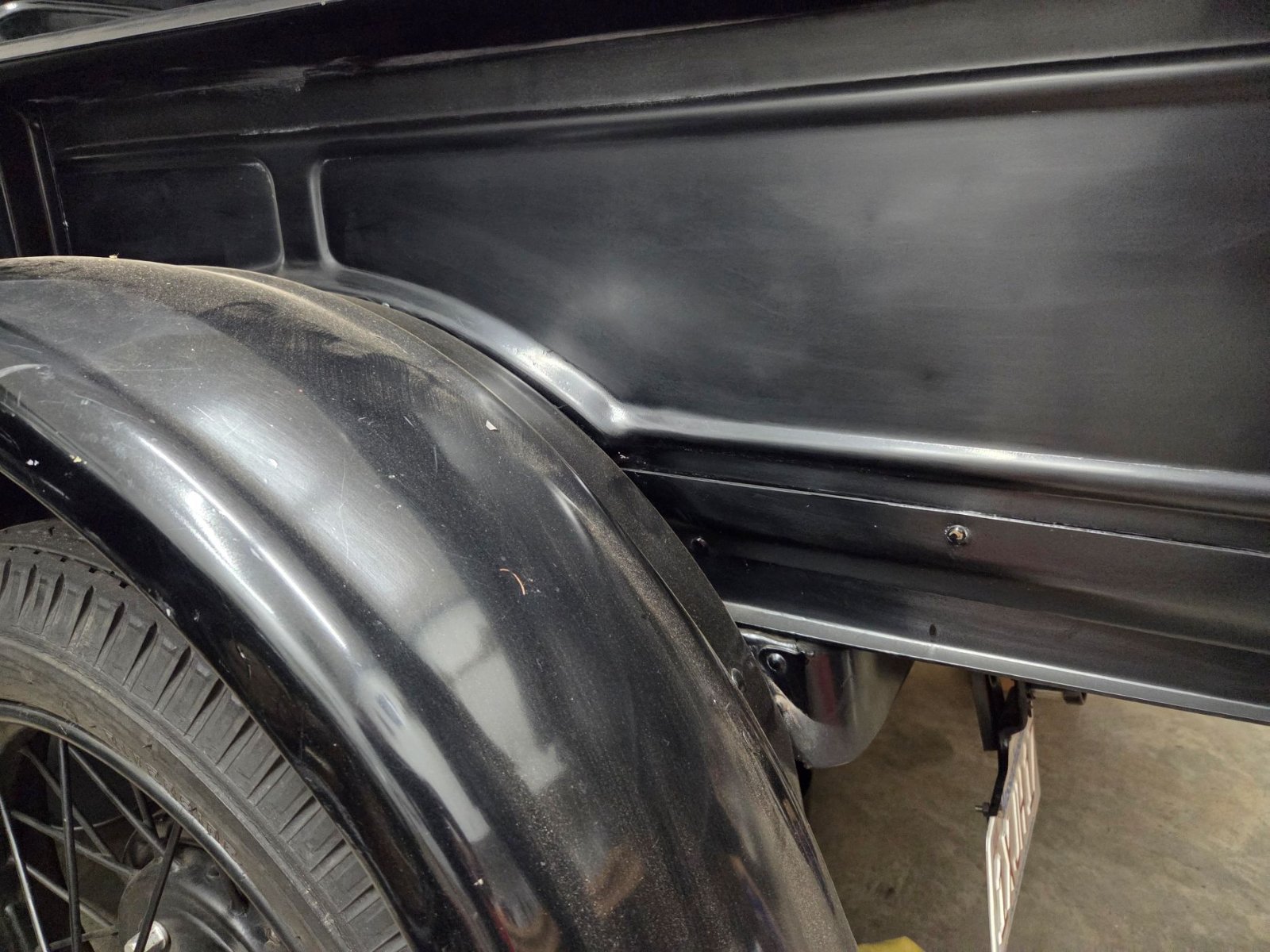

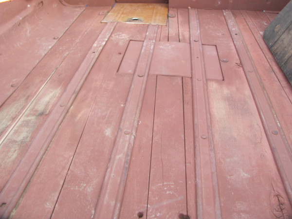

I have a 26 pickup and can't figure out why the crossmember cover plate is proud of the bed boards. The crossmember is up against the cover now so you can't move the cover lower. Are the body blocks incorrect?

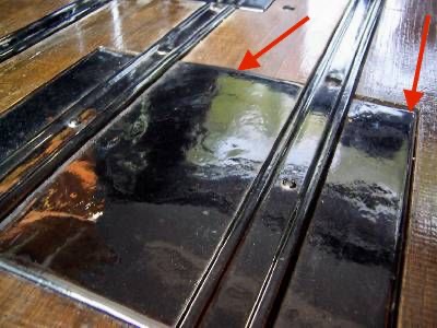

Post by DanTreace » Thu Sep 25, 2025 10:03 pm

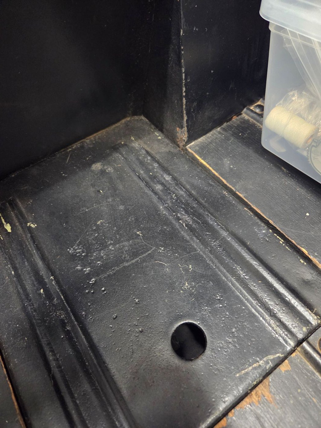

That 'hump plate' should be mounted with the flanges under the bed wood. Suppose the wood blocks are misplaced, can't seem to see in the photos.
Hump plate on originals:
bed hump plate under side.jpg (99.21 KiB) Viewed 2969 times
bed hump plate.jpg (53.16 KiB) Viewed 2969 times
That 'hump plate' should be mounted with the flanges under the bed wood. Suppose the bocks are misplaced, can't seem to see in the photos.
unfortunately, I can't mount it with the flanges under the bed wood. The crossmember is already up against the hump plate. bocks? Do you mean blocks?
What blocks are you referring to?

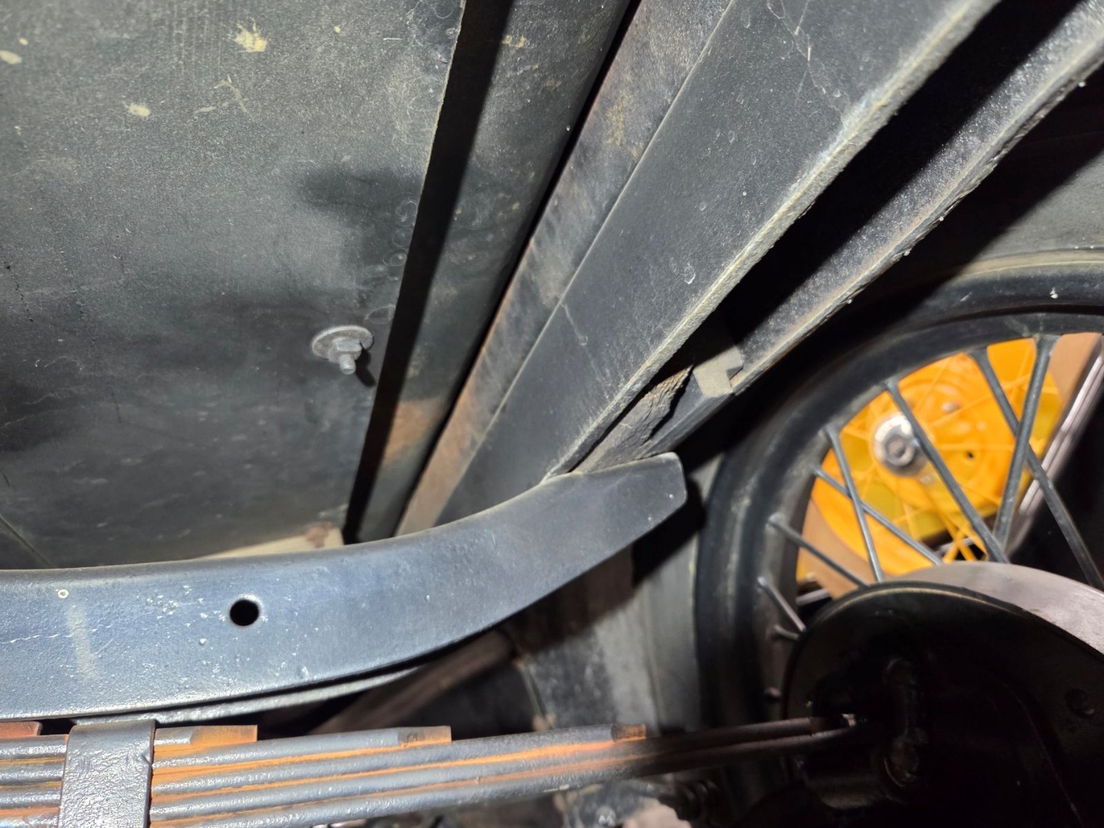

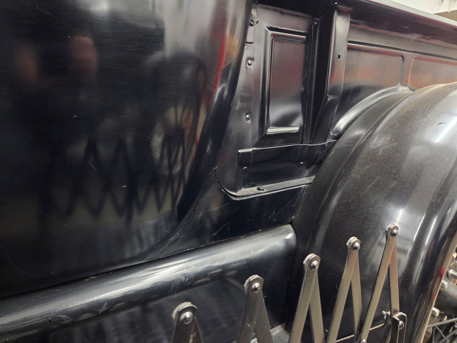

Can you post some pictures of the outside view of the turtle deck sub frame please.

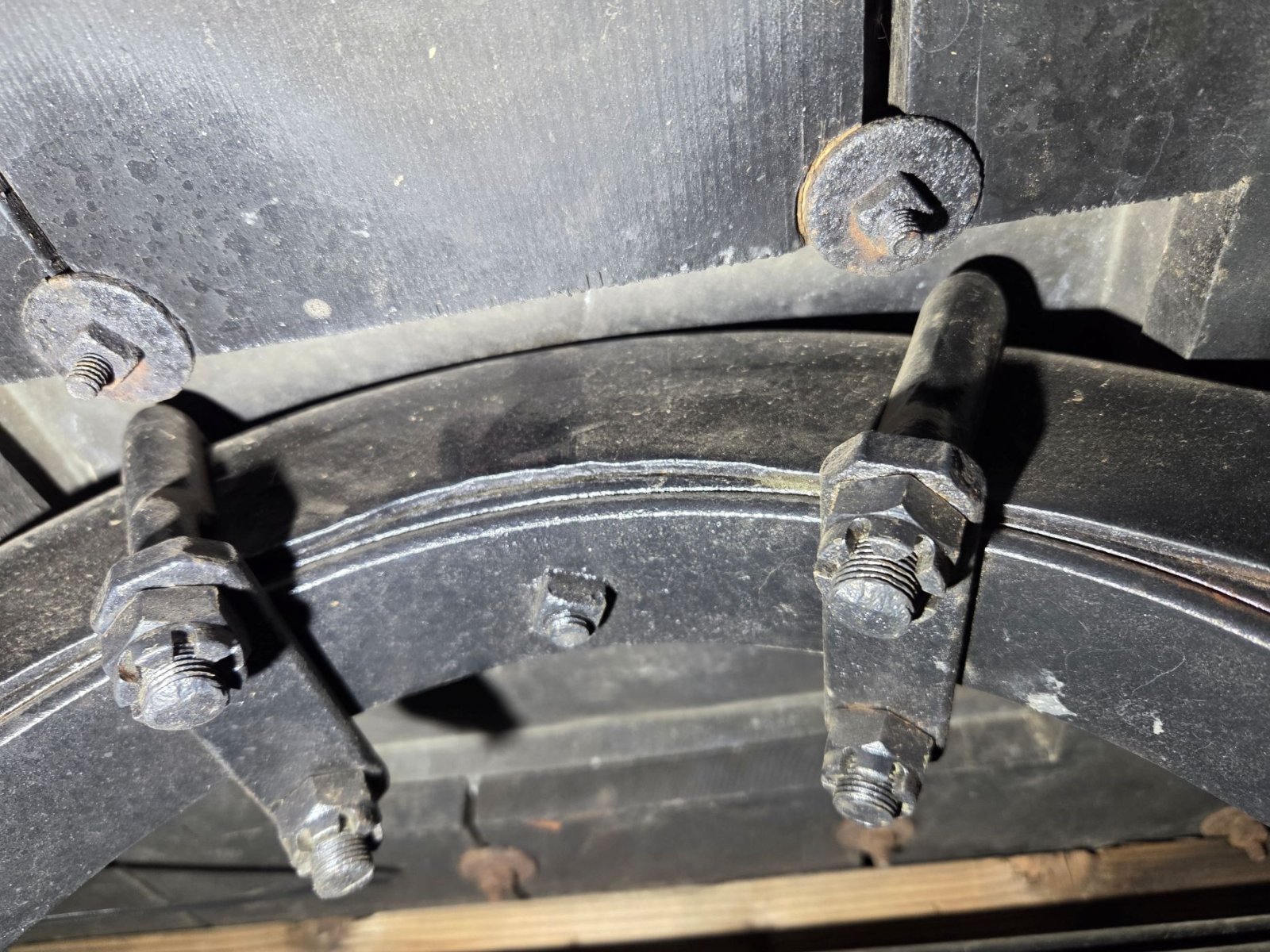

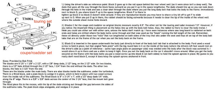

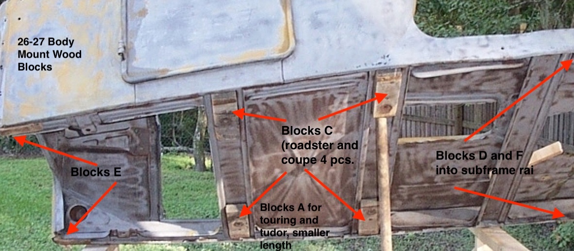

Meant to post "body blocks" they are frame mounts to lift the runabout body and its deck off the frame. You might have missing or worn ones, and the body is mounted too low on the frame.
DCP_1084 (600x400) (580x387).jpg (147.1 KiB) Viewed 2872 times

Raise the bed, put the plate where it belongs, and oil the springs.

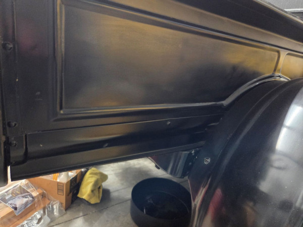

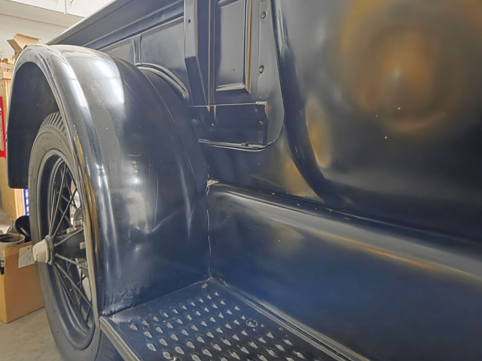

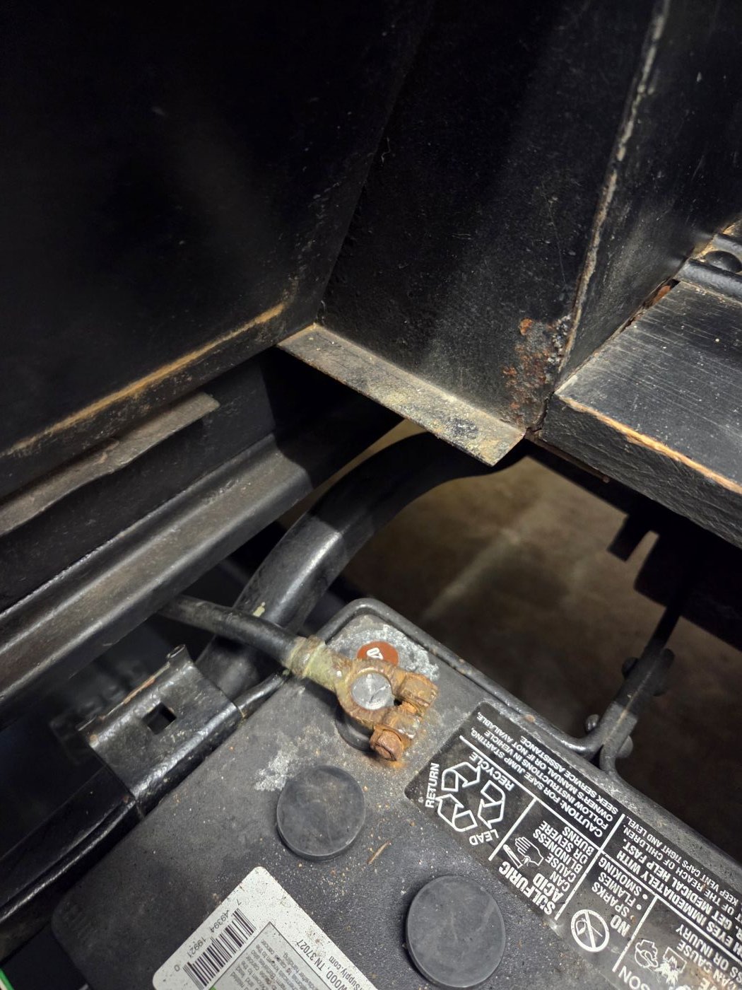

Humblej wrote:
Fri Sep 26, 2025 7:12 am

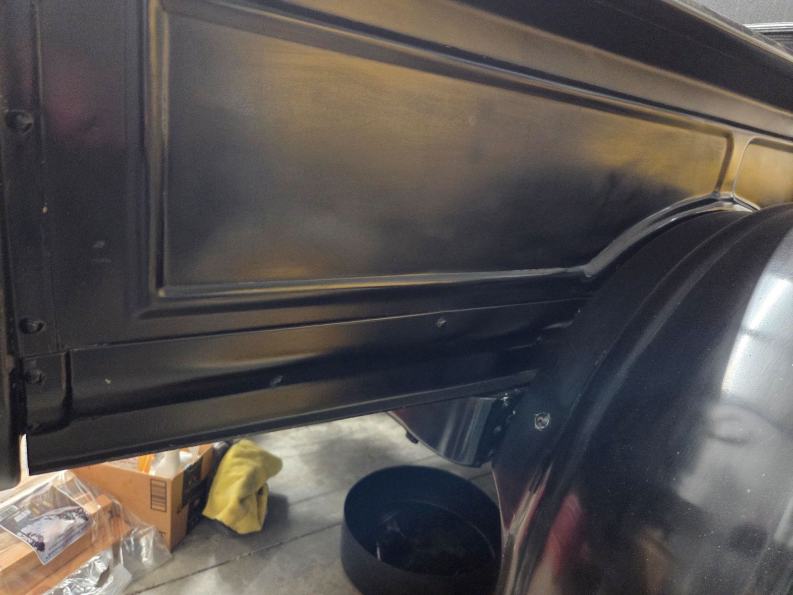

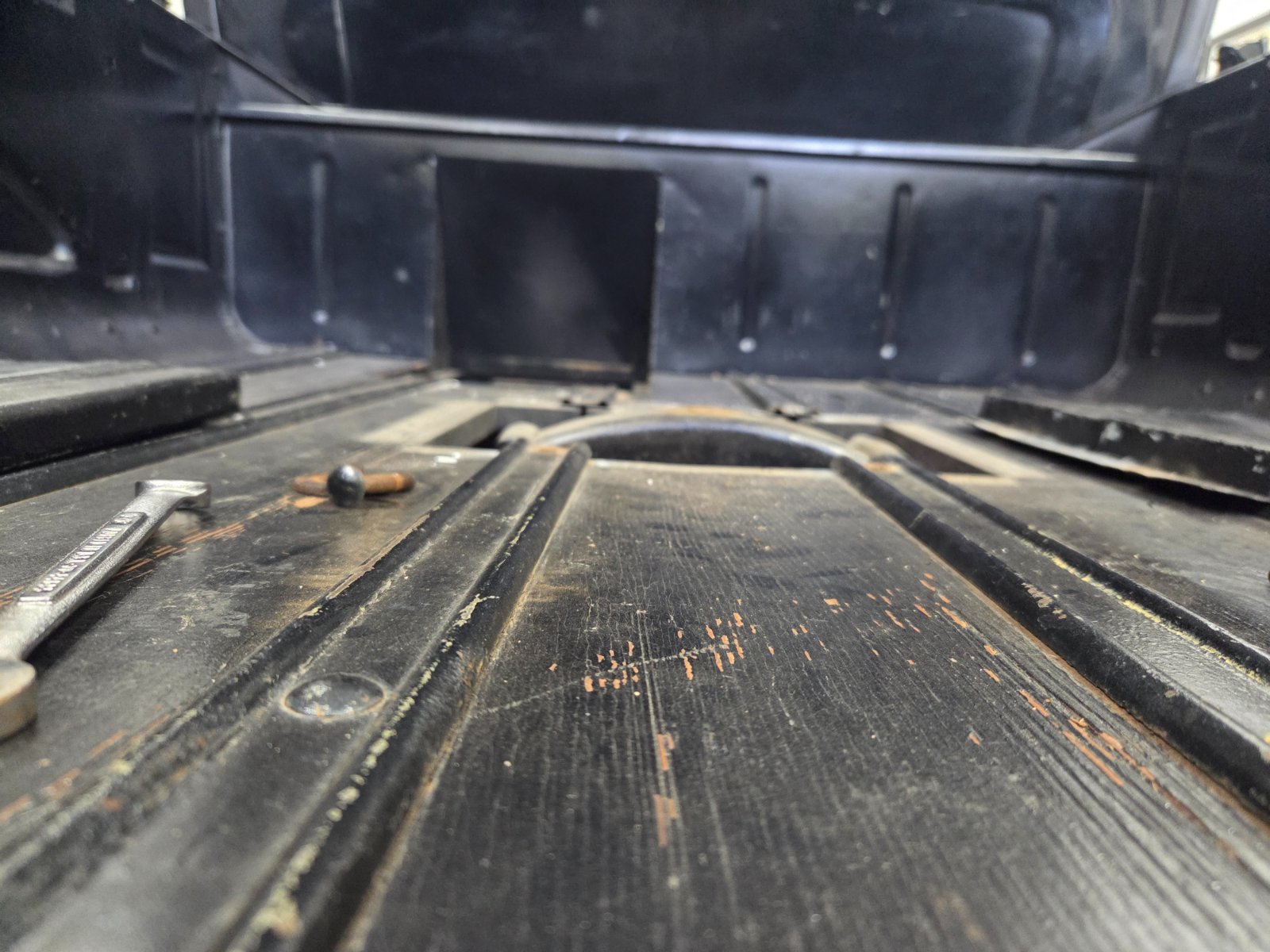

Hope this helps

Post by TXGOAT2 » Fri Sep 26, 2025 8:05 pm
It looks like the body and rear subframe are about where they should be, but the bed is too low. I'm not sure just where is the problem lies. The fenders seem to be in the right place relative to the running boards and the bed. Maybe all the wood blocks are too thin, including the running board blocks, and the entire body is too close to the frame.

Everything looks right but it does not add up... I am starting to think your floor boards are too thick, that would bring the cover plate lower and therefore closer to the frame. Please measure the thickness of the floorboards and report back.

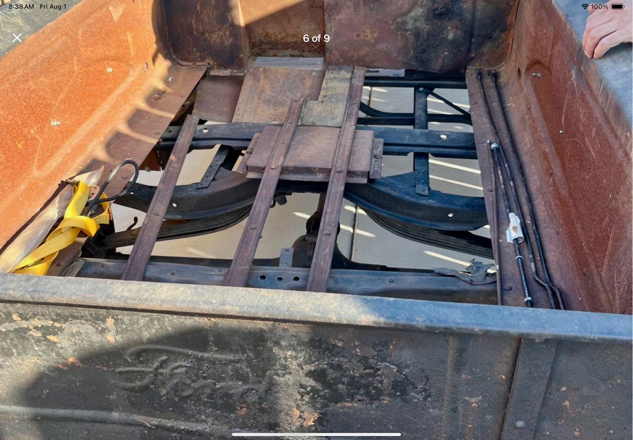

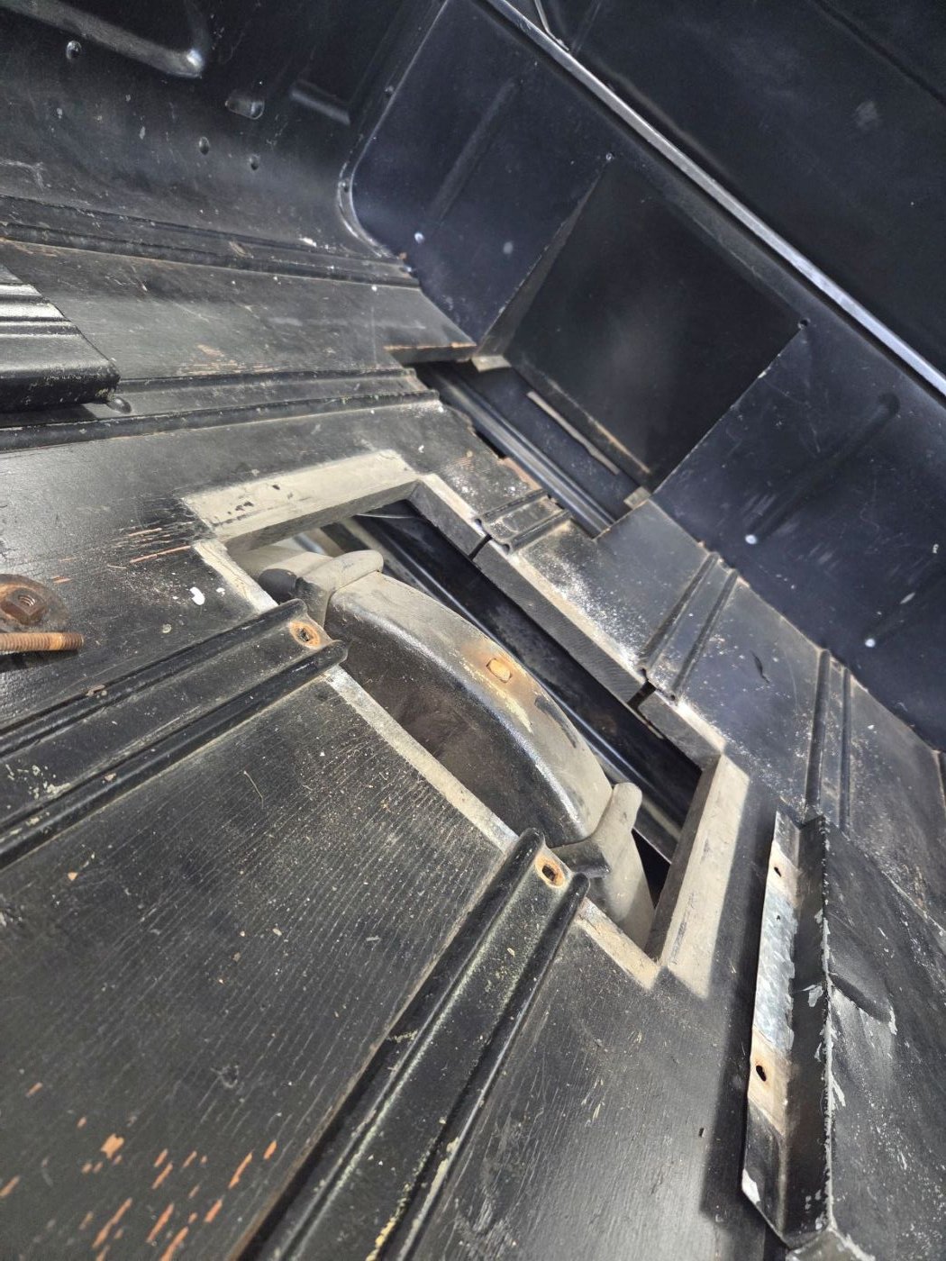

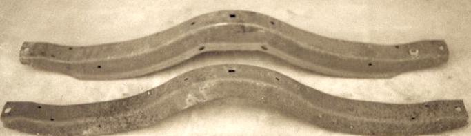

Just another observation from your photo. The crosssmember on your pickup is the earlier version without the flanges for reinforcement. But both have the same curve.
Believe you have enough space under the crossmember and the bed to place the hump place flush with the bed wood.
There is only a little space anyway between the hump plate and the top of the crossmember.
That is why Ford used the hump plate, otherwise the bed boards would ride on the very top of the radius of the crossmember, making fit difficult.
Could just be the former owner didn't know the flanges of the hump plate mount to the underside of the bed boards.

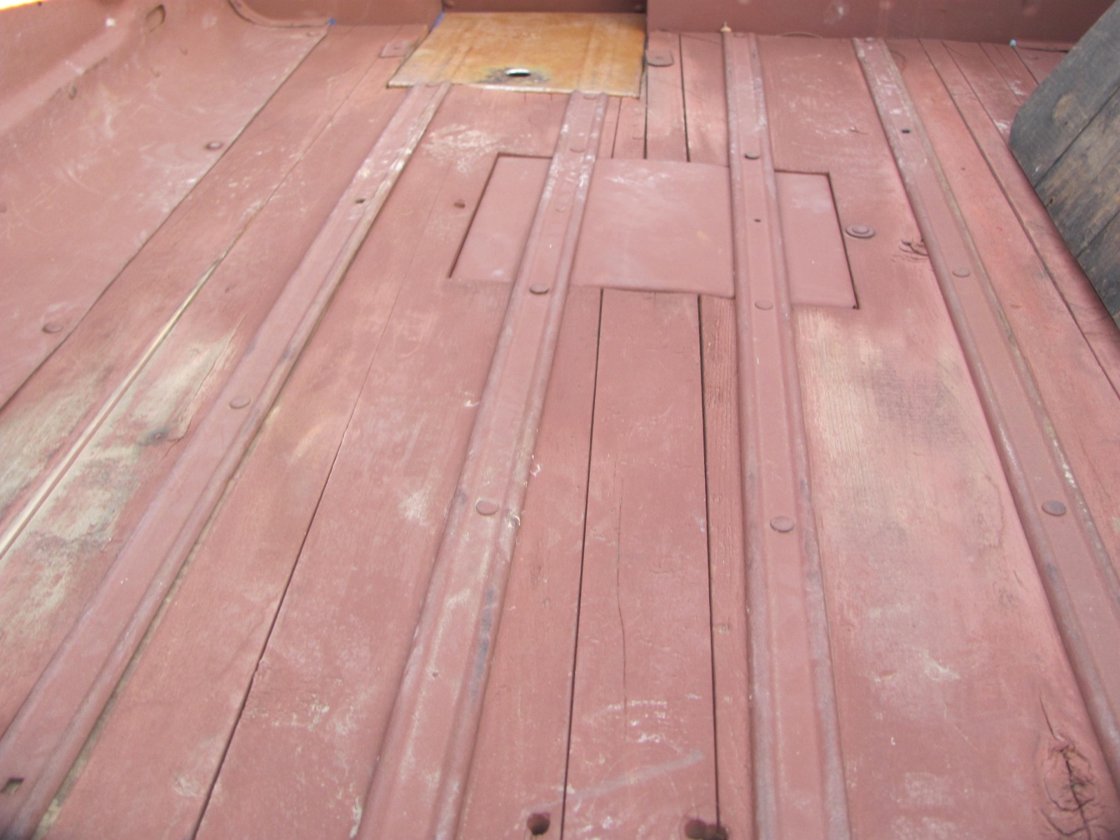

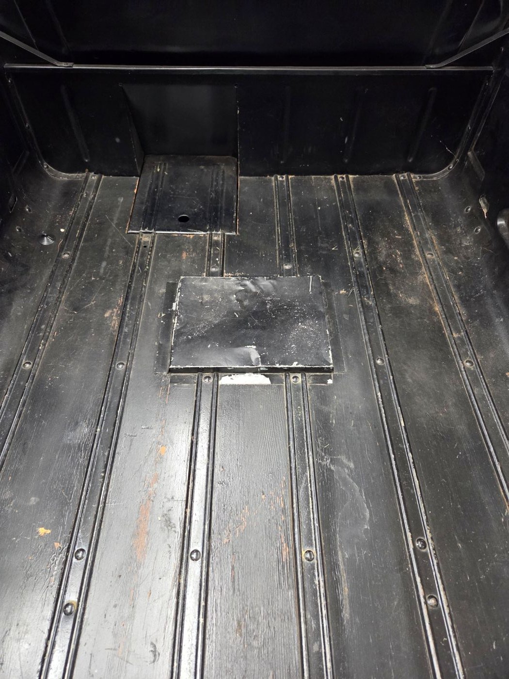

Post by speedytinc » Sun Sep 28, 2025 1:38 pm
The pictures of the bed & fender (especially #3) look like the bed is to low & the fenders bent down to fit.

Post by DanTreace » Sun Sep 28, 2025 9:09 pm
No room. Maybe I need new body blocks but the few I have seen in person sit the same as mine. Things don't add up, but I'm sure we'll get to the bottom of it.

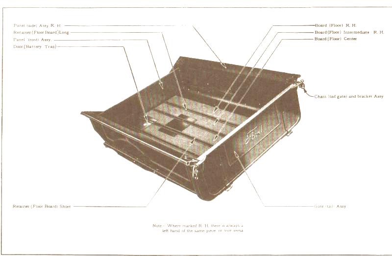

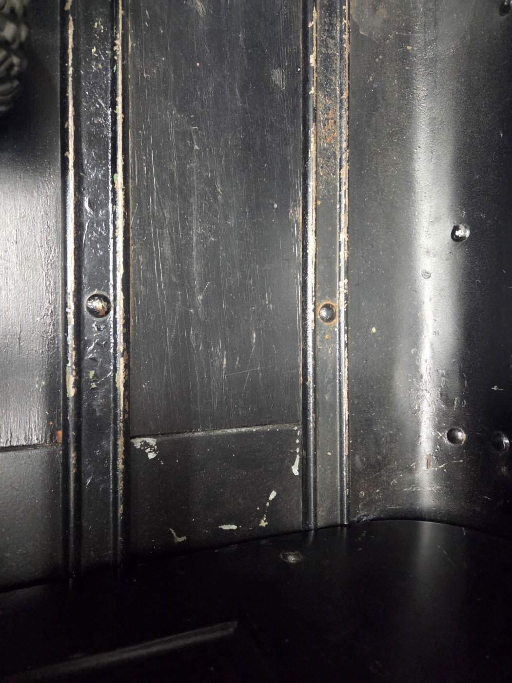

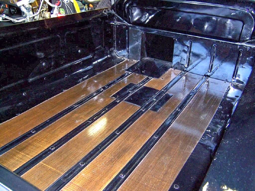

Well looked again and see now the bed wood isn't like stock install. Yours has 6 metal bed strips or cleats. The factory is 4. The curved metal bed sides hold the edges of the outer boards. These use carriage bolts thru the curved bed sides.
So that may be the problem.
Here is the factory install of the bed boards and using only 4 bed strips. 2 short and 2 long.

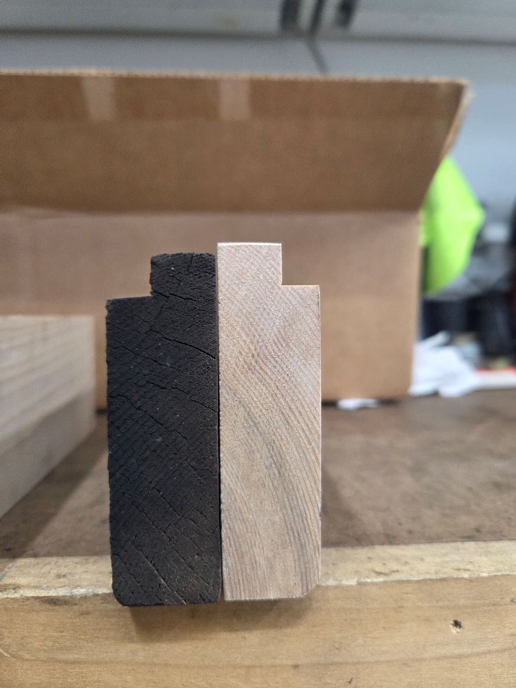

The board thickness is really 13/16", at least it is on a 1925. Take your bed off, and put in the plate correctly. You will be happy you did.

I'd love to but no room, hence my dilemma. Just trying to figure it out before tearing it apart.

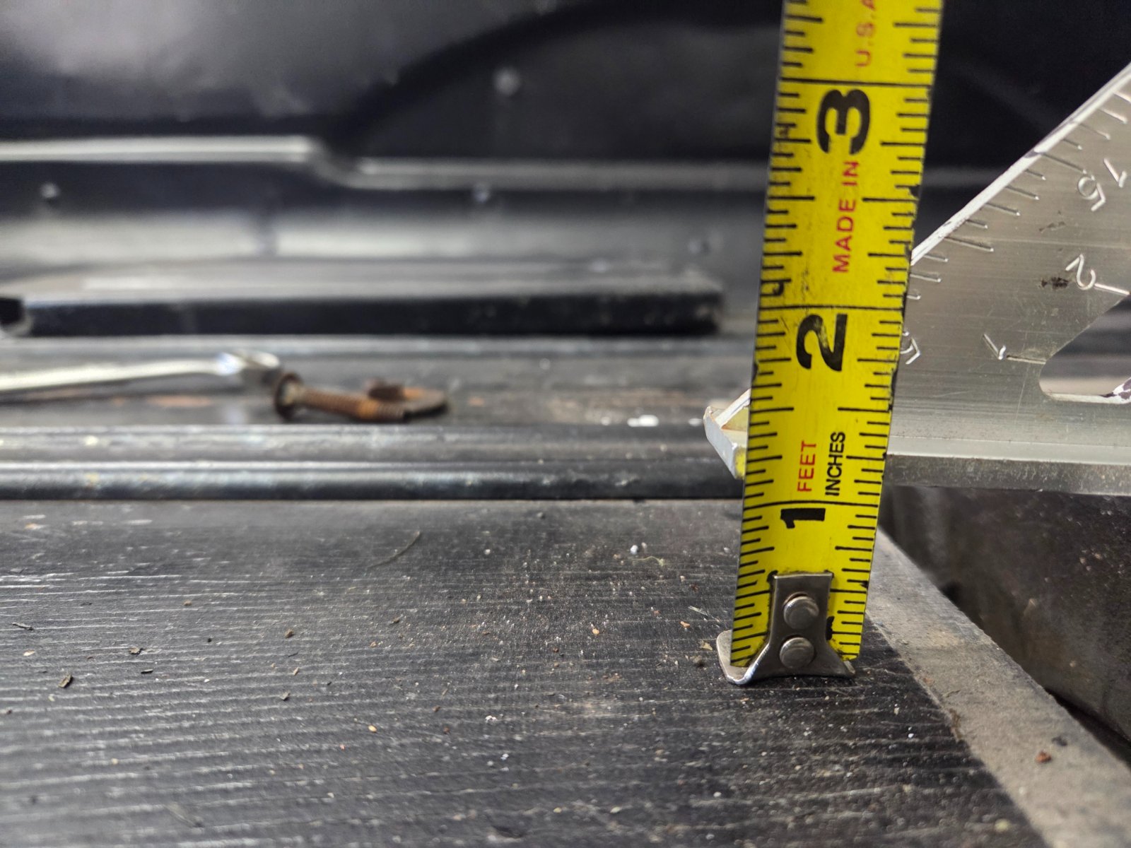

Post by 351cmach » Sun Dec 28, 2025 7:44 pm
I finally got back to this. I replaced all the body blocks (maybe 1/4" difference in height of the rear blocks). The crossmember still sits to high. I can't figure out what is off. Maybe a rear crossmember with a higher hump. Are Canadian frames the same?

Post by DanTreace » Sun Dec 28, 2025 9:48 pm
The measure seems should work, about an inch above the boards, as you measured the highest point of the curved crossmember.
The hump plate shouldn't be flat, it should have a bit of a curve or crown shape to accommodate the very top of the crossmember.
The clearance is only very small, sometimes the center of the hump plate will rest on top of the high point of the crossmember. Without the plate, the wood boards would bind or warp over that crossmember.
That plate will have to be installed by removing the bed, as you can't slide the plate under and in now as the bed boards are already placed.

I believe the higher arched rear cross member was a British thing, along with the dropped front axle and the even further dropped spindles than those used on the improved Fords of 1926-7. These were made in England. our Canadian sourced cars are the same arch as the US production.

Is there someone near Boston Mass with an assembled 26-27 Roadster Pickup?
If a "correct" car and the "incorrect" car can be next to each other then parts and measurements can be compared back and forth to locate the issue.
My '27 Rdstr Pu is currently a pile of pieces waiting for me to get to it.
I can measure anything anyone wants but can not guarantee anything is correct.
Working by remote control is difficult and sometimes frustrating.
When the answer is found I am curious as to what it is, it has my curiosity
Mike
There are a couple of club members with pickups. I have looked at them and nothing stood out. My next step is getting mine side by side with another and hopefully I can get to the bottom of this.
