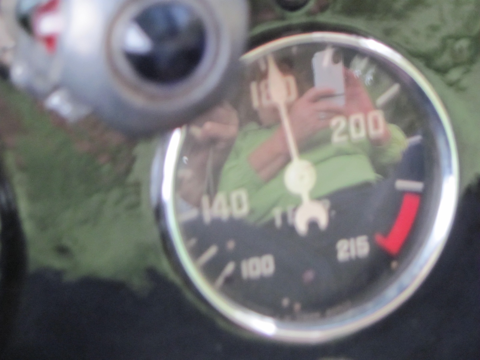

This has been an issue for some time, If I keep my speed no faster than 35mph the engine runs at normal temp. If I push the engine to 40mph it wants to run warm. The moto meter will be full red. As soon as I back down the speed she cools back down and the moto meter runs in the right range. 10/30 oil, Relatively new Burgs rad, High comp head. No water pump. Air temp low 80's. Timing?

While a Model T will heat up more than normal when not adjusted correctly locating the source of the problem can sometimes be challenging.
I like to use a handheld laser thermometer and check around for clues.
The motometer could also be not calibrated very well.
When using a laser temp probe it does not work well on shiny surfaces so keep that in mind.
A properly operating Model T will run hotter than you might think, but below boiling.
Any extra drag or friction, including using the brakes too much, will make the car run hot.
Bad Timing, lean mixture, and bad running, or running too hard will also make it heat up.

Motometers are not precision instruments. How old is yours & have you ever calibrated/compared its readings to a infrared digital thermometer?Will wrote: ↑Mon Dec 29, 2025 7:13 amThis has been an issue for some time, If I keep my speed no faster than 35mph the engine runs at normal temp. If I push the engine to 40mph it wants to run warm. The moto meter will be full red. As soon as I back down the speed she cools back down and the moto meter runs in the right range. 10/30 oil, Relatively new Burgs rad, High comp head. No water pump. Air temp low 80's. Timing?
"Normal" engine operating temperature is 180 °F. What coolant are you running with, just water, 50/50 antifreeze? Remember to that Motometers were design to measure coolant vapor. What I'm getting at, the first thing to do is to validate the reading from the Motometer. Without that verification you'll be chasing a ghost.

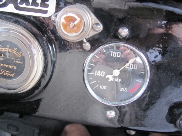

Will wrote: ↑Mon Dec 29, 2025 7:13 ambeen an issue for some time, If I keep my speed no faster than 35mph the engine runs at normal temp. If I push the engine to 40mph it wants to run warm. The moto meter will be full red. As soon as I back down the speed she cools back down and the moto meter runs in the right range.
Have experienced the same, a good running T with same equipment, runs cool, but the motometer will show the added engine heat when running wide open on a busy road!
Installed a fairly accurate temp gage, sender in the water outlet, running normal speeds, right at 180 degrees.
Now on the open highway, speeds to 40-45, the temp will rise.
Speed equals Heat! Slowing back down brings the temp down too.

Re: Engin temp
My experience is similar to Dan's, with the engine running about 180F in mild weather and at lower speeds, and around 200F in very hot weather or at higher speeds, such as 40 MPH+, or on a sustained climb, or with a steady tailwind. If you are using 50/50 green antifreeze, the system may run a little hotter than with plain water, but the boiling point of the coolant will be a little higher also. The engine is perfectly happy with the water outlet temperature at 200F to 205F, or a little more. Boiling is to be avoided. You don't want steam bubbles in the engine. You want liquid coolant in contact with the interior water jacket surfaces. /// The thermosyphon system will not circulate the coolant until the engine is fairly hot. Once circulation begins, when most of the coolant in the engine is at around 180F, it will circulate faster as the coolant gets hotter, so long as the radiator and coolant passages are clean. If the system reaches the boiling point, it's time to back off or stop. Coolant boiling in the block will impede the circulation and can prevent coolant from being in full contact with the interior surfaces of the water jacket, especially at the hottest locations around the exhaust valve seats, and you don't want that.

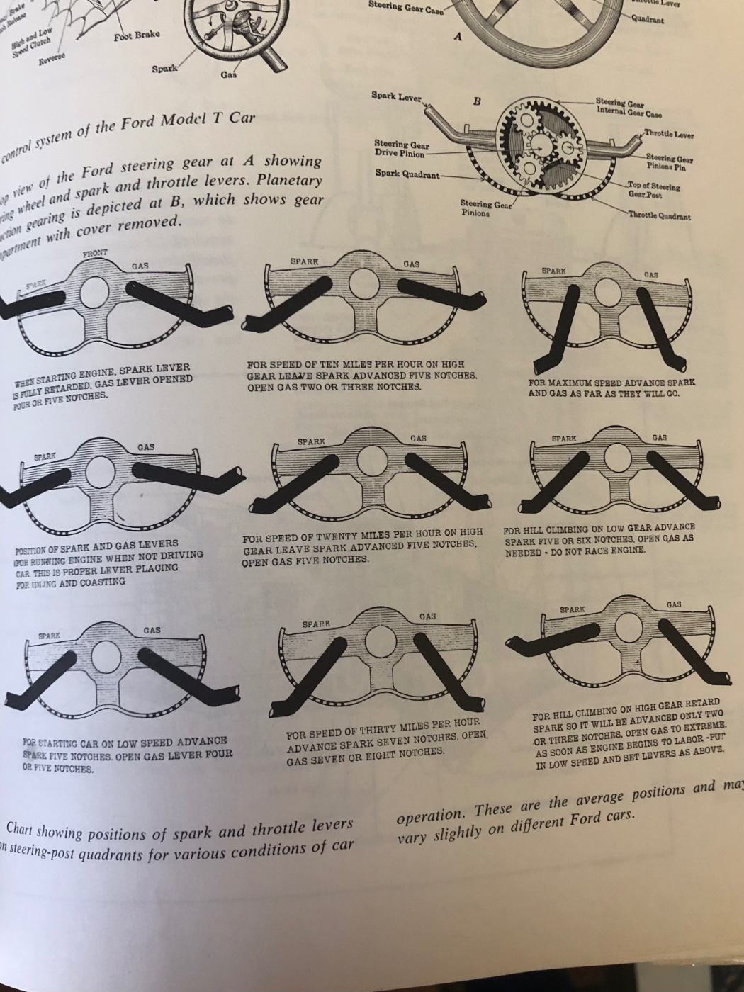

After reading the posts here I’m of the opinion that the spark lever is being improperly used. Any one that’s familiar with a distributor with weight and vacuum advance units knows that timing isn’t static at all but varies with speed and load. Some T drivers set it and forget it and that seems to work for them. I have in fact seen Steve Jelf do this exact thing. Started the car and pulled the spark lever way way down. Actually I was surprised at this. Again what ever works for you. Until a problem develops. Sometimes under unusual circumstances. He doesn’t over heat at lower speeds but cooks at high speed. Really sounds like timing. I’m reposting the spark lever chart which can be very helpful in setting the T’s spark lever correctly. Try this before spending any $. It might be all you need to do.
