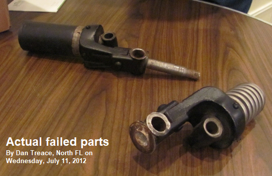

There has been various interpretations of the accident that killed Ken Meek. Blame was placed on a broken shock absorber perch but evidence suggests that it was broken in the accident and not the cause. Too much speculation has been placed on the broken parts after the accident and not how they may have failed during the accident. Not to mention a bias against accessories

Thanks for posting that, Ed. It's sobering, and at the same time confusing. Did both the tire and rim separate from the wheel? Which perch failed? Is that pic of the accident vehicle?
From what I see, two accessories might have prevented this accident:
Reinforced wishbone. This was an early one.
Hydraulic steering stabilizer.
OTOH, the accessory shock absorbers contributed.

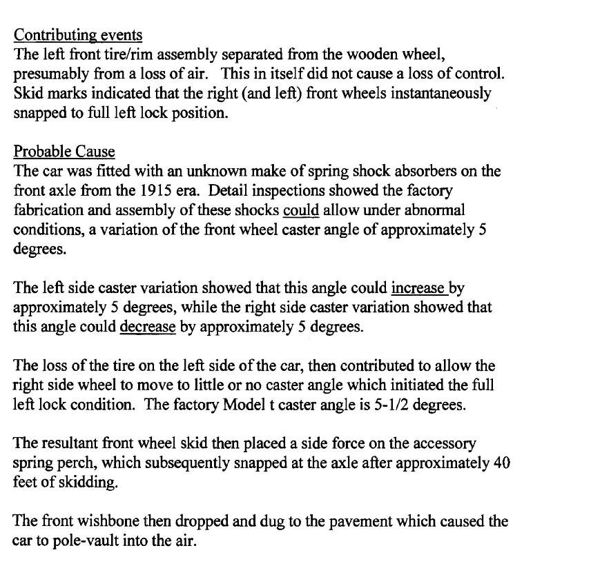

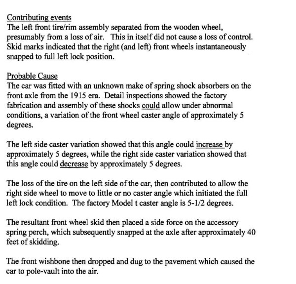

By Ricks - Surf City on Thursday, July 12, 2012 - 07:30 pm:
There may be more to be learned from this event.
Note 1. : It says the "left front tire/rim assembly separated.."
It was the left front tire, tube and maybe flap that separated. The rim stayed on the wheel.
Note 2. : "Skid marks indicated that the right (and left) front wheels instantaneously snapped to full left lock position."
From that point on, the driver was only a hapless passenger. Snapping the wheels hardover on dry pavement will cause a rollover at speeds much lower than 30.
Note 3. : "Probable Cause"
The report attributes design of the shocks, and not worn holes in the perches that caused the hardover from the caster variation, but it's obvious from the pix.
The perch snapped after about 40 feet of skidding. That sounds far? That's less than a second at 30 mph.
The left rear wheel did not leave a skid mark. Did the car have wheel brakes?
Extracted from Executive Summary:
failed parts.png (363.04 KiB) Viewed 389 times

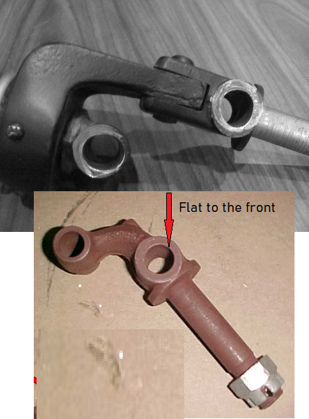

perhaps the real issue is in the design of the two hole perch and what made Ford change to an under the axle wishbone & a one hole perch
