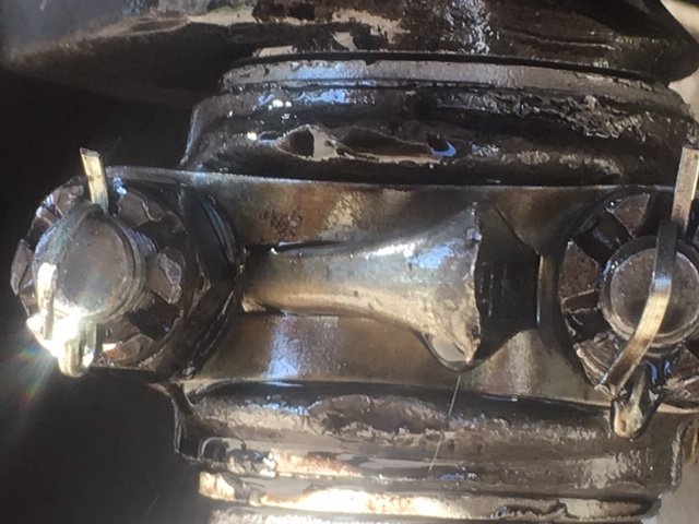

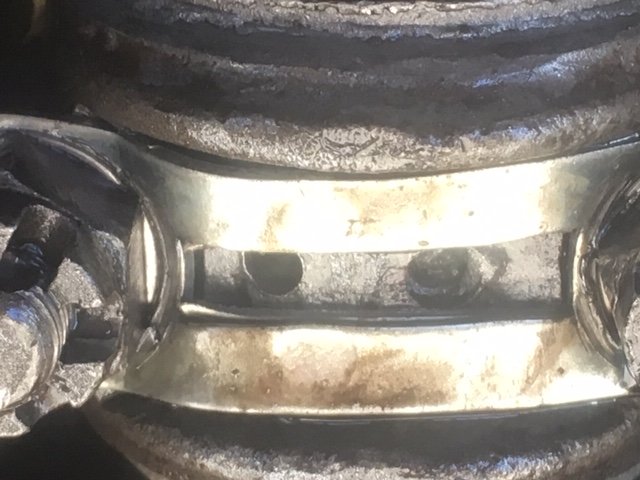

First the oil modification mention: When I build up a T engine I add rod scoops to help oil the bearings. This is similar to what Chevrolet did and is a debatable modification. I use the commercially available tin scoops and drill the rod cap. The first thing I do is to gently (?) widen the opening and squash the height down. The goal is to increase the cross sectional area of the scoop and decrease the height. The idea is to move more oil and be able to clear the "Horlick Mountain Pan dips" I usually utilize.
I lost the bearing on #1 rod because it is a long steep uphill drive in to town and for the first time in about 18 years I've been running without my pan dams. I have no additional oil lines at this time going stock some time ago. If I pull off the flywheel I will probably add a second interior oil line.The dip on #1 was intact.
Oil scoop spread and ready for service `
I noted that the scoop on #3 had failed. It had sheared off where the scoop passes through it's base.
I have no Idea when the scoop came apart nor where it went. At first I naively thought it was involved in the clicking noise. I hope to find it in the t-cup at the bottom of the pan when I look there.
I have now found two problems with the scoops. First is that when you reshape them the chrome plating flakes off into your oil (and bearings). Second, now, the scoop can be weakened and caused to fail. My next set of scoops will get annealed to remove the plating and allow reshaping without cracking. Next they will be annealed again before installation.
Enough on scoops.
Enough on scoops.

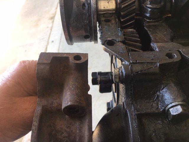

You mention a "cracked generator housing". What caused the crack? Could it either be caused by gear misalignment, or be the cause of gear misalignment? Also, how is the number 1 main bearing? Could be cause of the rod scoop breaking if the crankshaft was pushed down in front. Almost sounds as though you might need to do a complete rebuild.

Norman, You can see the crack in the generator housing on the right in this photo. The spare housing I have is on the left.
You can see that debris or oil in the housing bolt hole can cause a crack due to hydraulic pressurization in the closed hole design. My spare cover had the hole drilled so it is open in the rear. I think this will prevent a future crack.
