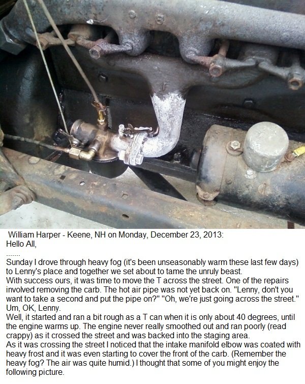

Thats debatable. Some run one in the winter &/or humid climates & remove in the summer or not run in dry climates. The intake manifold can freeze up @ the elbow. If so you will probably notice a performance difference.
My conclusion is try with & without. I do notice icing where I am & run one.

It is more about dew point than vaporization of fuel. Look up carburetor icing. Where I live we need them more in summer than any other time of year. Dan

Northern Michigan in humid August, you need one, and that is running with a Straight Through NH. I agree with Dan, dew point/humidity more than anything else. Put it on, leave it on and be done with it.

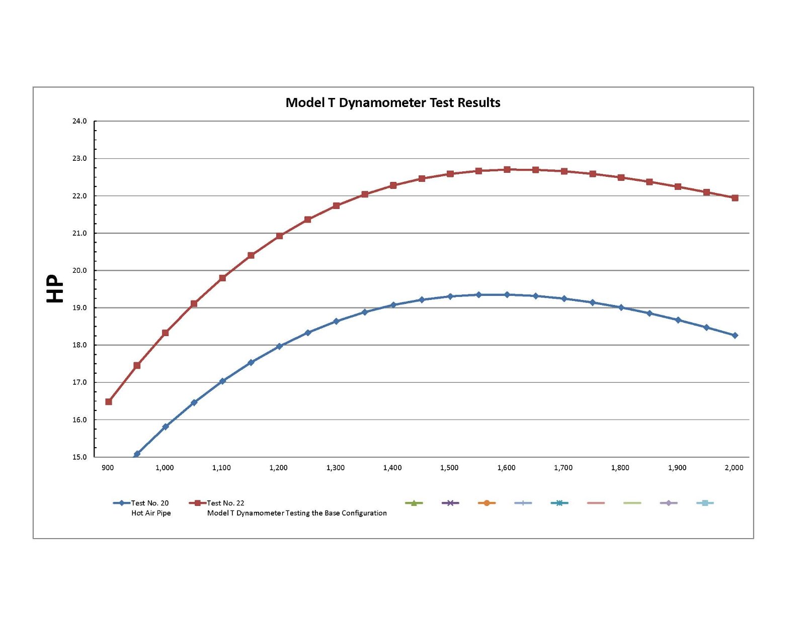

Not according to this dyno test with and without the hot air pipe!
https://www.mtfca.com/discus/messages/2 ... 1341900318
Some of the loss is due to the manifold heated air going into the engine, but the design of the hot air pipe itself, particularly on the earlier pipes, also greatly restricts the airflow. That doesn't help either.
After seeing these results, I haven't used the hot air pipe for several years. Granted, I don't drive if it is really cold, but I have not experienced running issues without the hot air pipe, and I don't want to lose that much horsepower for a device that was intended to better vaporize the poorer quality fuel of 100+ years ago.
