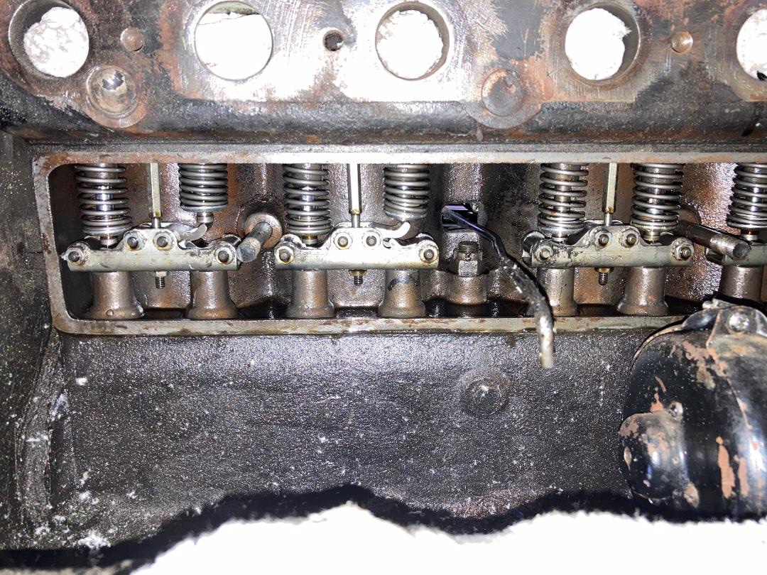

Well thats a new kettle of fish.
New day timers must run DRY. No oil. Cam needs to be sealed from any oil getting to the timer.
Check that all the multi-lift arms are working full function. Check for valve clearance. They had the habit of shearing the pivot pins.
I tried a set of nos units once. The lift arms ate away the valve stems & several pins were loose & sheared. #4 exhaust valve wasnt opening enough, hence rough running & a lack of power. Thats why I opened the valve chamber up & found the carnage.
Very disappointing experiment.
Yours look good @ the moment. Maybe a compression test will show a valve or 2 not closing all the way.

The Multi Lifts might work better with a set of stainless steel valves. That's a LOT of lift... do they use stock Ford springs?

A valve issue related to valve springs or keepers or the Multi Lifts may not show up on a compression test, whether using the crank and "feel", or using a gauge. In some situations, a valve may seat at very low speeds, but fail to fully seat at normal operating speeds.

So doing a compression test I have now discovered that my main problem is actually a stuck open exhaust valve on cylinder #3. I've cranked the intake valve down and closed and put some ATF and penetrating oil in. I'll leave that in #3 and see what happens. :(
