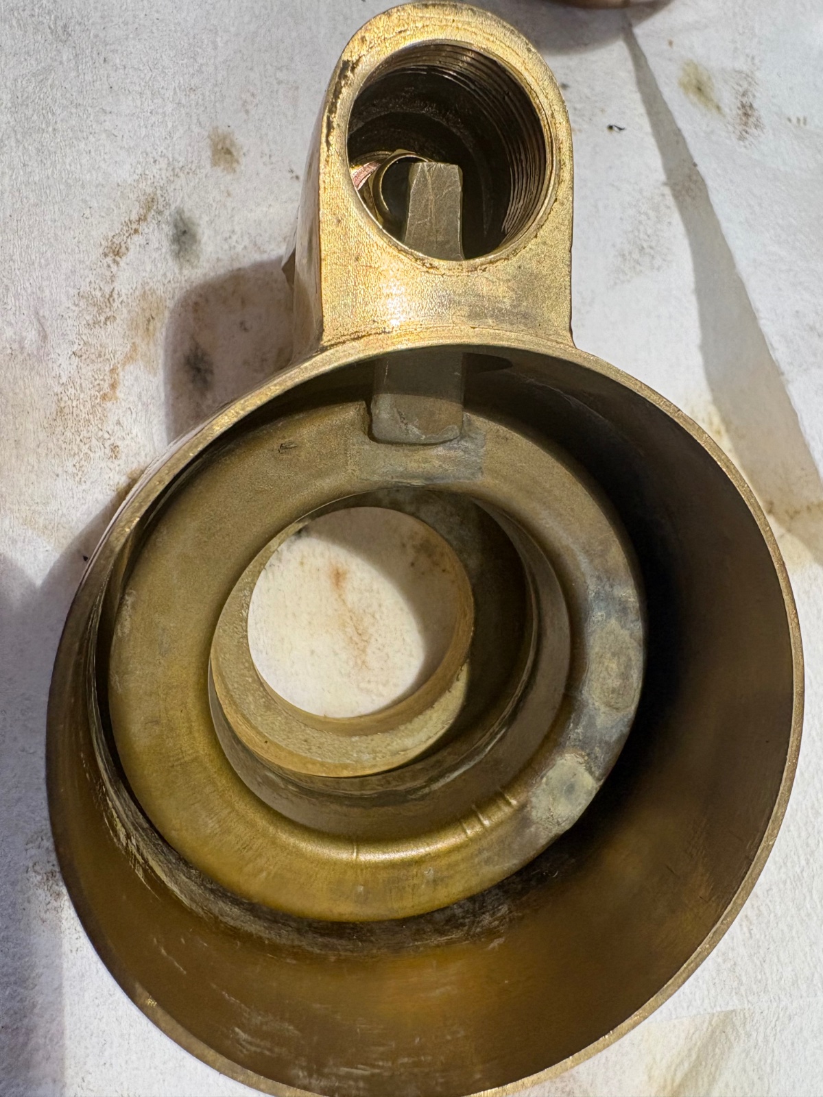

Since the passing of Stan and Russ does anyone have a source of valve seats and floats for the Kingston 5 Ball Carb?
The Stan Howe setup work great. The float is from a Harley Davidson.
The 1909 float and seat aren’t original. The problem is the seat is some sort of plastic ball and it hangs up.
Any source would be greatly appreciated.
Thanks,
Rod
Thanks,
Rod

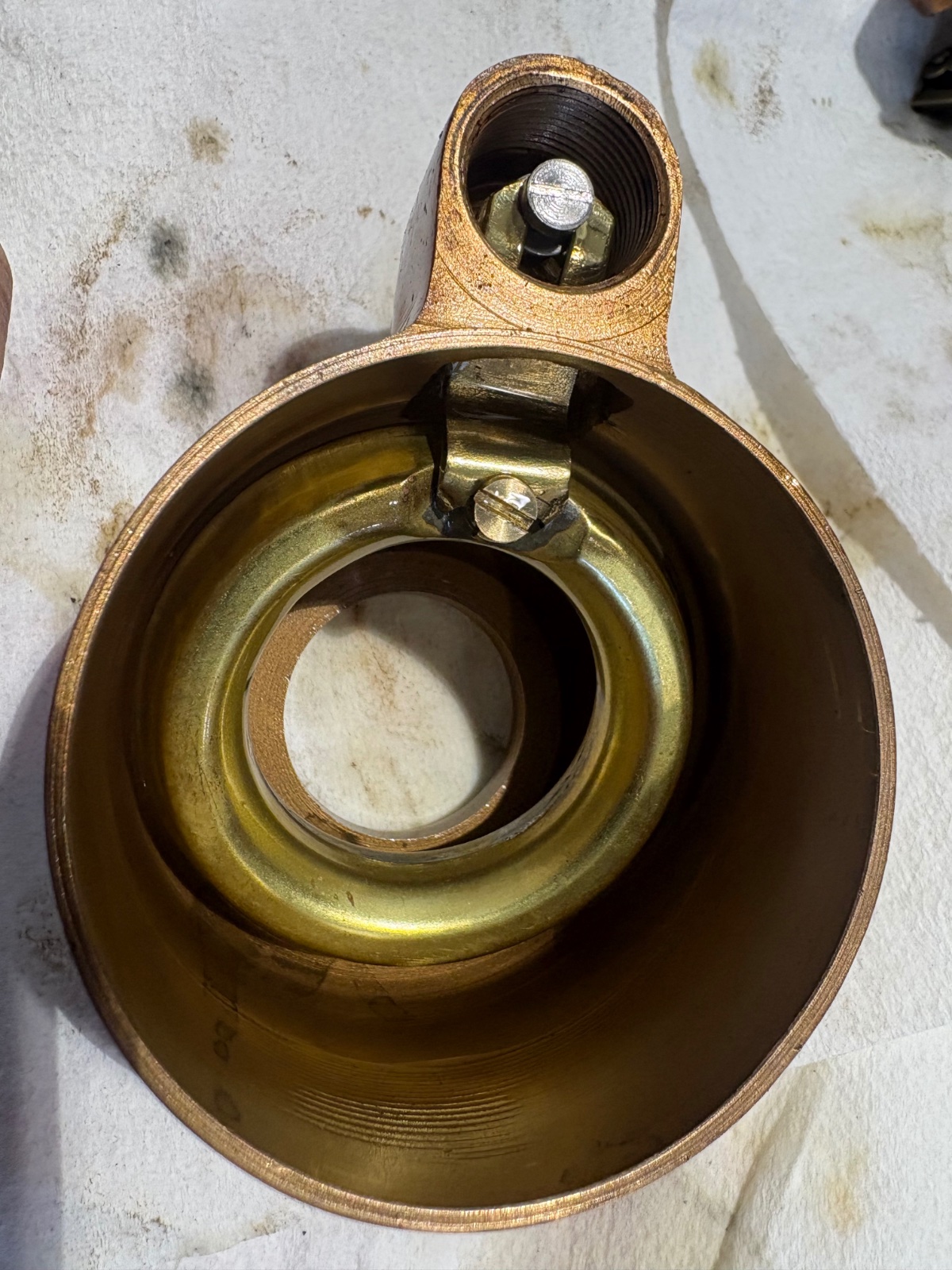

Your unknown float picture looks like a JD float used years ago. I think I have some, look and try to o compare. Dan

The float in the 2nd picture of the 1909 Unknown is OK but the seat is sticking. It has some sort of plastic ball seat. Would you happen to have a different type in stock?
Please email me.
Thanks,
Rod
Please email me.
Thanks,
Rod

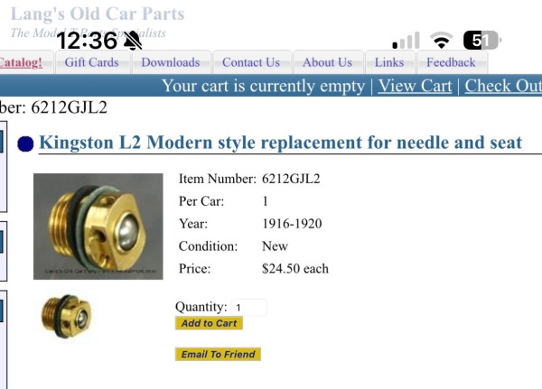

I found what looks like the sticking float needle seat.
https://www.modeltford.com/item/6212GJL2.aspx
I ordered it and hopefully it works.

Aka Grose jet float valve

If you have that Grose jet in there then there should be 3/8”-24 threads there already, then you can get one of those 4-barrel needle and seats as previously mentioned here. You may have to shorten the threads and the top part for sure. Be sure and reform the needle so the little wire hooks on and the float going down can pull the needle up because the gravity feed has a hard time pushing it up sometimes.
You’ll have to make a float arm. I put those in 4-balls all the time, have to drill and tap. The distance is the same on the 5 ball from the seat to float hinge pin. The arm is a little longer but you have to make that anyway. I’ve made 5-ball floats from the material the vendors sell.

Can someone please post a link to purchase a “4-barrel needle and seat” as previously mentioned?
Thanks,
Rod
Thanks,
Rod
