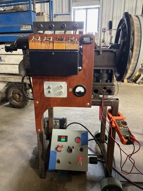

I have made several additions to the test rig that I have been playing around with this winter and have more in mind. I have added an AC volt/ammeter to the inverter supply to make it possible to monitor the power consumption with changes in flywheels weights and magnet types. One toggle switch allows me to change from operating the coil box to operating one or two light bulbs or turning them both off and comparing voltage with load or no load with a more accurate digital voltmeter. The variable speed VFD along with the digital tachometer makes checking with various speeds possible to within 10 rpm. I have added the spark plugs gaped to .073 to simulate the operation under compression mostly to find out how slowly the motor needs to operate to provide adequate magneto voltage for starting. This week I intend to add an indicator/pointer to the magneto frame and make two index plates attached to the flywheel at 180 degree opposition which will make it possible to use an induction timing light to verify timing accuracy of coils and timers at various speeds. I am curious to see how ECCT timed coils compare with Strobospark or HCCT ones in that regard. I think I will be able to check the accuracy of Anderson type timers and make adjustments much more easily than with installation on a car. I have found out that too much magneto voltage turns the coils into fireworks displays at just around 1000 rpm and I am certain that operation like that would destroy the points in short order so I am looking for the "sweet spot" to make low speed starting as good as possible while preserving the points at higher speeds.

I have studied that option some but, quite frankly, lack enough understanding to spec a choke to do the job. Any suggestions are very welcome.

I am not sure I understand your setup and issue correctly in spite of reading it 4 times.
Your setup has a VFD running an electric motor turning the crankshaft and you are testing magneto and flywheel performance and setup??
You measure output with gauges , coils, and bulbs is this correct?
If I got that all correct then I have some comments.
Magneto bulbs have been a problem since day one due to the huge variance in voltage over the RPM range.
Over the years all kinds of things have been tried so I will be watching to see what you do and how well it works.
My concern is you say @ 1000rpm the coils (and I assume the spark coils) turn into a fireworks display.
1000 rpms is 25mph on a stock rear ratio. 1800 or 2000rpm is the rated max and you are no where near that.
I don't think anyone, including me, drives their T never to exceed 25 miles per hour.
They were designed to be hooked straight to the magneto and drive @ 30mph, up to 35mph all day long.
I will say I don't watch the coils while tooling down the road so I can not see what is really happening.
But the coils live untouched for years and thousands of miles rarely doing anything but working fine.
There seems to be something different here.
Maybe someone can make and post a video of a stock Model T coil box tooling down the road to see what really happens.
I am curious to know what really happens myself.
It probably would be best to video a car with a firewall coil box and a cowl to limit sunlight for maximum visibility.
I can not do this, my cars are put away for winter and I don't do videos.
There are several T owners that post lots of videos maybe one of them can do it?
Maybe we can get a video of your fireworks display?
I don't know your setup but in a stock car the coil fires 2 or 3 times then close to 2 cycles of the crankshaft before firing again.
The timer limits the coil duty cycle of each coil to somewhere sorta about 10% on, 90% off.
I am sure someone can calculate the exact number but it changes depending on which timer is used.
It's well documented that 100% duty cycle will overheat a coil.
So how are you controlling the coils? Timer? Always On? Other?
I love head to head comparison tests with data, I would like to see what your tests tell us.
Mike

Re: The "Franken-Tester"
