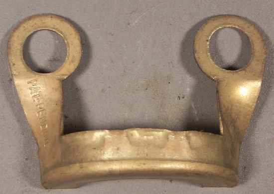

I have several different types but not that one ! I'll try & grab a photo later today.
